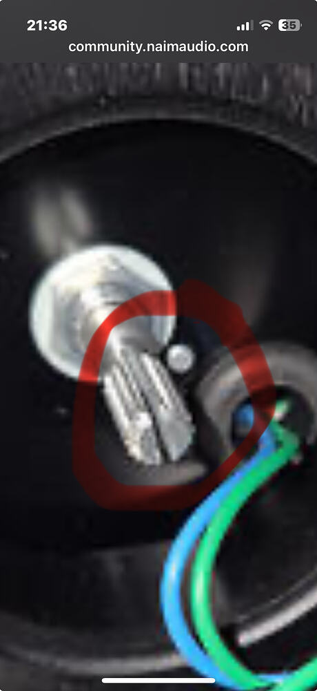

Naim Supernait 3 volume knob loose
Turn off amp. Set volume to zero and pull off volume knob carefully. Very very carefully insert the tip of a screwdriver into the slit/gap at the end of the pin shown here. Widen it just a little using very slight force. The volume knob should then stay on. Make sure it is positioned correctly- ie the light around 7 -8 o’clock before permanently clicking it into place.
This was my 1st thought also, and what I would do,
I was following Neil’s direction on this and trying to help OP understand,
Whilst James’ method will work, you can end up bending just one half of the shaft. This results in a very obvious eccentric rotation when the knob is refitted. This can be quite tricky to correct.
Regards
Neil.

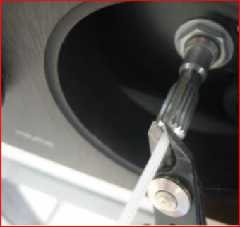

As promised - first pic of cable tie being cut to length:
Note that the cable tie fills the entire slot.
Second pic of it fitted:
Regards
Neil.
Cheers Neil, now that makes sense.
Much appreciated.
