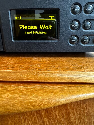

Hi, I own a uniti which has been upgraded and I was able to stream hi fi res files on todal, upnp, etc. The network component is not working well, as the app does not often find the uniti or streaming stops suddenly, even with a wired network connection. Sometimes when there is a power cut then the uniti keeps resetting as the network adapter fails, but eventually the uniti can play. I have two options, send it to repair (this will be the third time!), or use a raspberry pi5 with a digital output (digi2 pro) to use the naim’s DAC and amplifier.

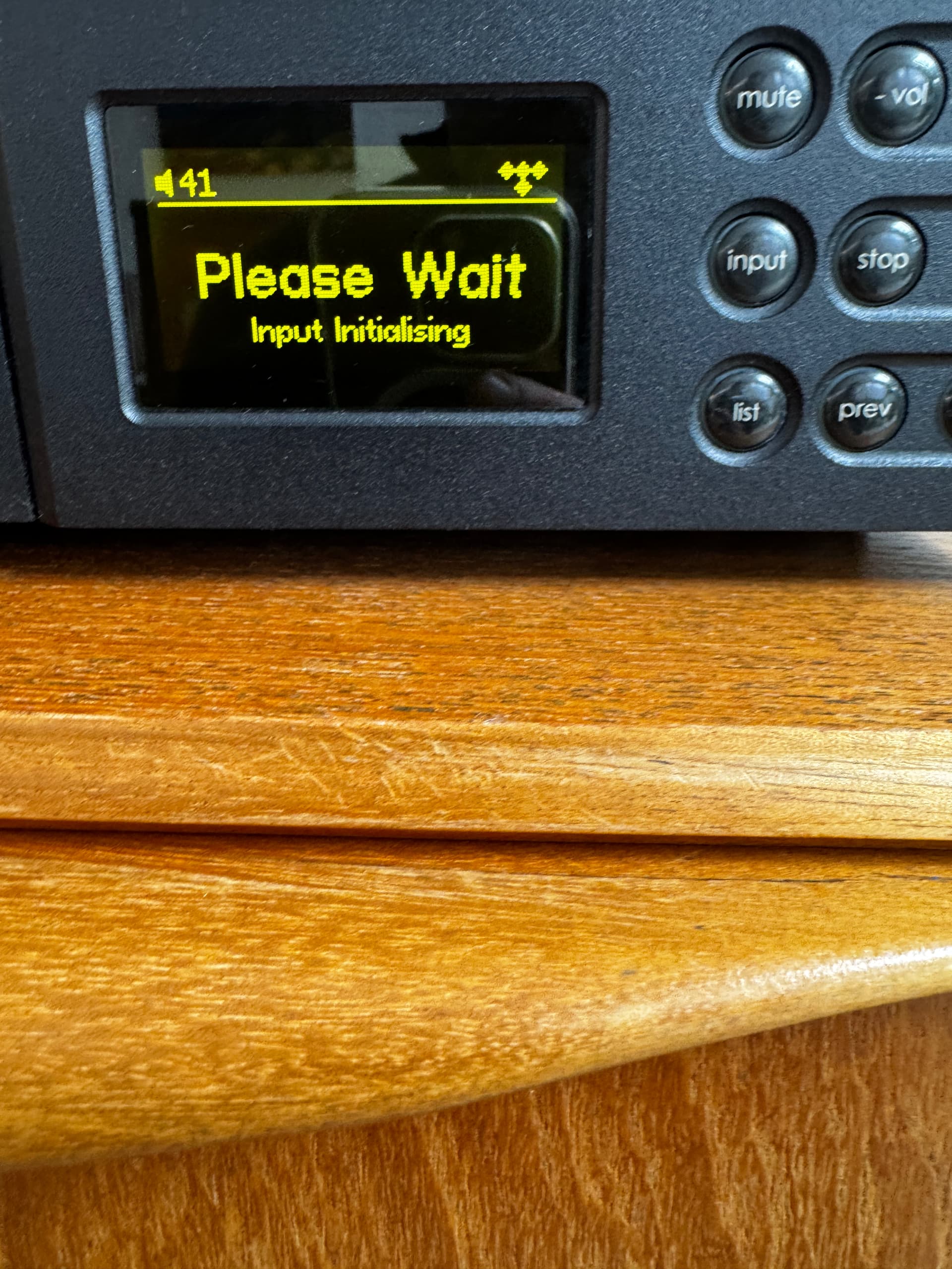

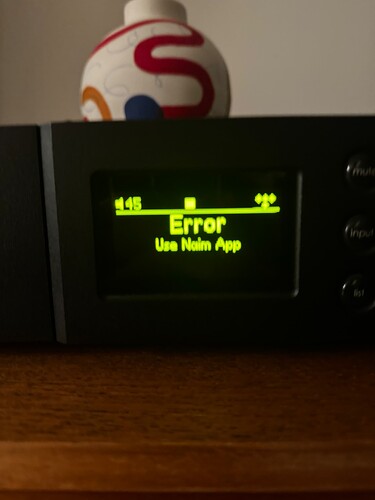

I recently moved home and both in the old house and the new house I have the same issues with different ISPs. There is a message on the uniti which says “input initialising ” or “error” when streaming. It seems to be a hardware issue…

Looks like you’re using Tidal. Is the streamer firmware up to date? Some of the last few updates were Tidal fixes.
Also “Input initialising” is normal with these old units.
Yes, software is up to date. The issue also happens using upnp or iradio unfortunately.. :pensive_face:
I have a first gen Uniti and as David Hendon says input initialising is a quite normal.
