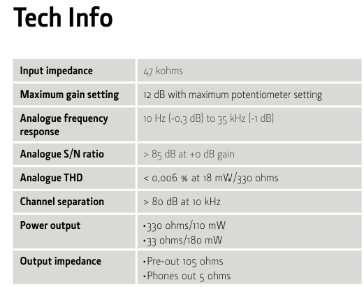

At the moment I am running successfully a Lehman Audio Drachenfels HA with these specs:

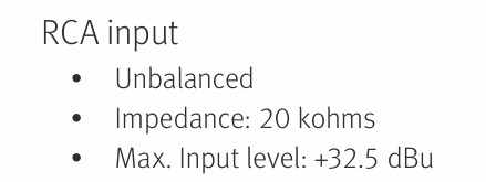

I am interested in the SPL Pronitor SE with these inputs

The input of my present amp is 47Kohm, whilst the one I propose to buy is 20kohm. I presume the proposed amp is still compatible, as I do not understand how the input impedance effects the compatibility.

My present headphone amp is a Lehman Audio Drachenfels with input impedance 47kohms
I am interested in the SPL Pronitor SE with input impedance 20Kohms
I am trying to discover the compatibility with the Naim AV with an output 130mV/600ohm and how the numbers relate.

I wrote to SPL support, and they were quick with a reply.
a support agent has just replied to your support ticket #24632.
Hello,
you can use the Phonitor SE with any standard line level output. If you have been using the Lehmann on your cable up to now, all you need to do is swap the amp. The inputs and outputs on the Lehmann are electrically standardized in the same way as our I/O. Please note that you may connect line levels to your Phonitor SE in any case - speaker outputs must not be connected.
If you have any questions, please contact me.
Best regards
I will add that the instructions that come with Audio gear are often vague, for those of us who are not electronics literate.
So it seems I can connect this device to my Naim amp without anything blowing up.
