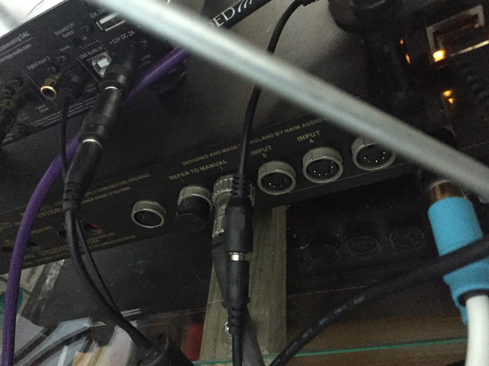

So it’s ‘just’ a case of replacing a plug?
It depends whether your nait has the extra socket on the power amp PCB - do you have 7 din sockets in total?
Regards
Neil.

I see this
Yes, that has all the sockets fitted, so can be used as an integrated amp by leaving the link plug in place & putting a Snaic 4 between the two 4 pin sockets.
Regards
Neil.
