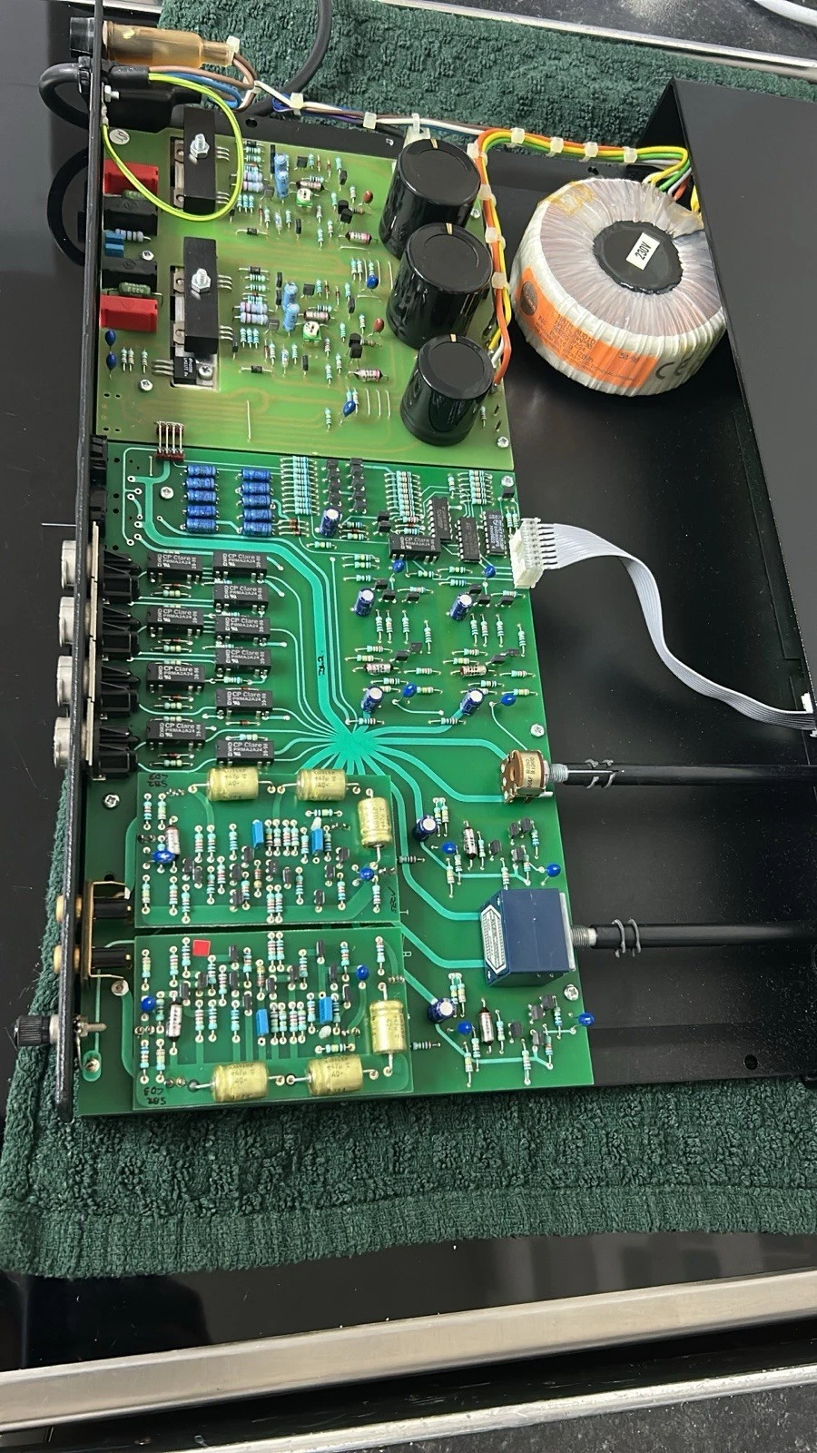

The early Nait3s suffered with very gradual thermal runaway & required relocation of the bias transistors. It’s an important mod - especially if you intend to leave the unit powered on.
Can you post some pictures of the internals & I can advise if this needs to be done?

Thanks Neil. My Nait 3 is a 1996 model, would that make it exempt from such a problem ?

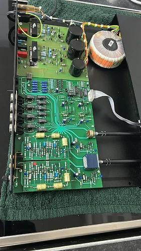

Hi Neil
Sorry to but in but I too recently bought a Nait 3 serial number 151480 internal below your advice would be really welcome.
I’m loving my recently acquired Nait 3 powering some Dynaudio 52’s I’ve yet to hear it with my Planar 8 but the Wiim Ultra/Gustard A18 it sounds very nice indeed.
@Bobthebuilder - I didn’t have any luck finding the date that the modification got signed off, your serial is 1999 & although it hasn’t been serviced, it does have the mod.

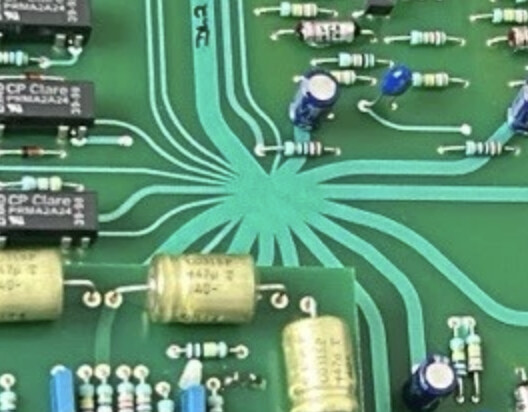

:sun: PCB routing was much more fun and creative in the past!
That looks similar to my ex Nait 5
