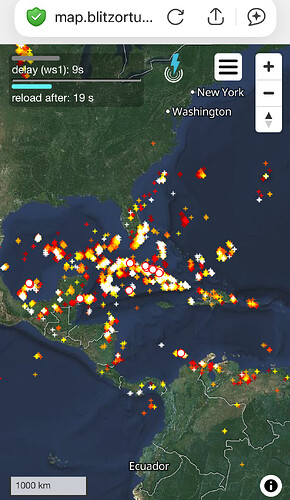

The lightning strike you heard might be getting further away. That doesn’t mean they all are. Just for perspective, here’s a current example of an electrical storm in which your 1 mile safety margin may not quite be sufficient.
