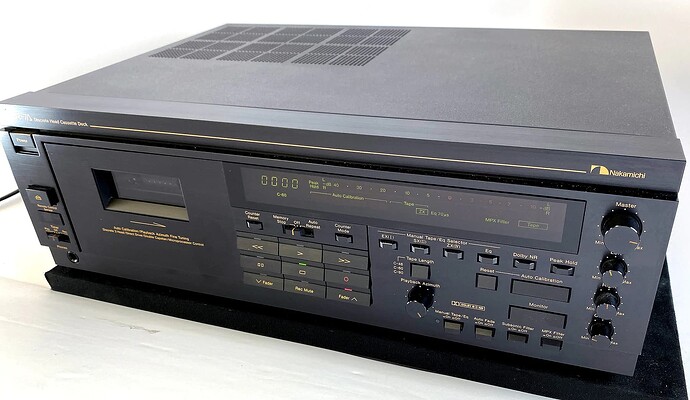

A question on behalf of a friend. He has a Nakamichi deck which has recently started chewing tapes. Does anyone have any idea who would be able to carry out a repair to solve this problem?

Which model of Nakamichi?

Not sure to be perfectly honest Richard. I will find out. Definitely not a dragon though.

It could just need a really good clean of the tape path and running surfaces (heads, capstan, pinch roller etc…). Some meths or Isopropyl alcohol and a lot of Q tips will do the job. Clean until there’s no trace whatsoever of any oxide. If it’s a basic one with the Sankyo mechanism then it could just be a case of needing a replacement pinch roller. This can harden or deform with age and while you can use rubber rejuvenator on them, replacement is usually best.

It’s a good place to start, and pretty much applies whatever the deck or mechanism.
I agree with Richard. A lot of the time with cassette decks, it boils down to the cleanliness of the tape path. I try to keep my decks scrupulously clean (3 Naks and a ReVox).

Quite a few people say that a stock CR-7 sounds better than a stock Dragon. My Dragon was upgraded to CR-7 specs by Bowers & Wilkins back in the day, but I’ve never had the opportunity to do a comparison between the two decks.
The Dragon’s looks are arguably unsurpassed (although that will depend on personal taste).
The CR-7 has the advantage of a real-time tape counter and auto calibration. Plus the manual playback azimuth adjust is well worth having.
