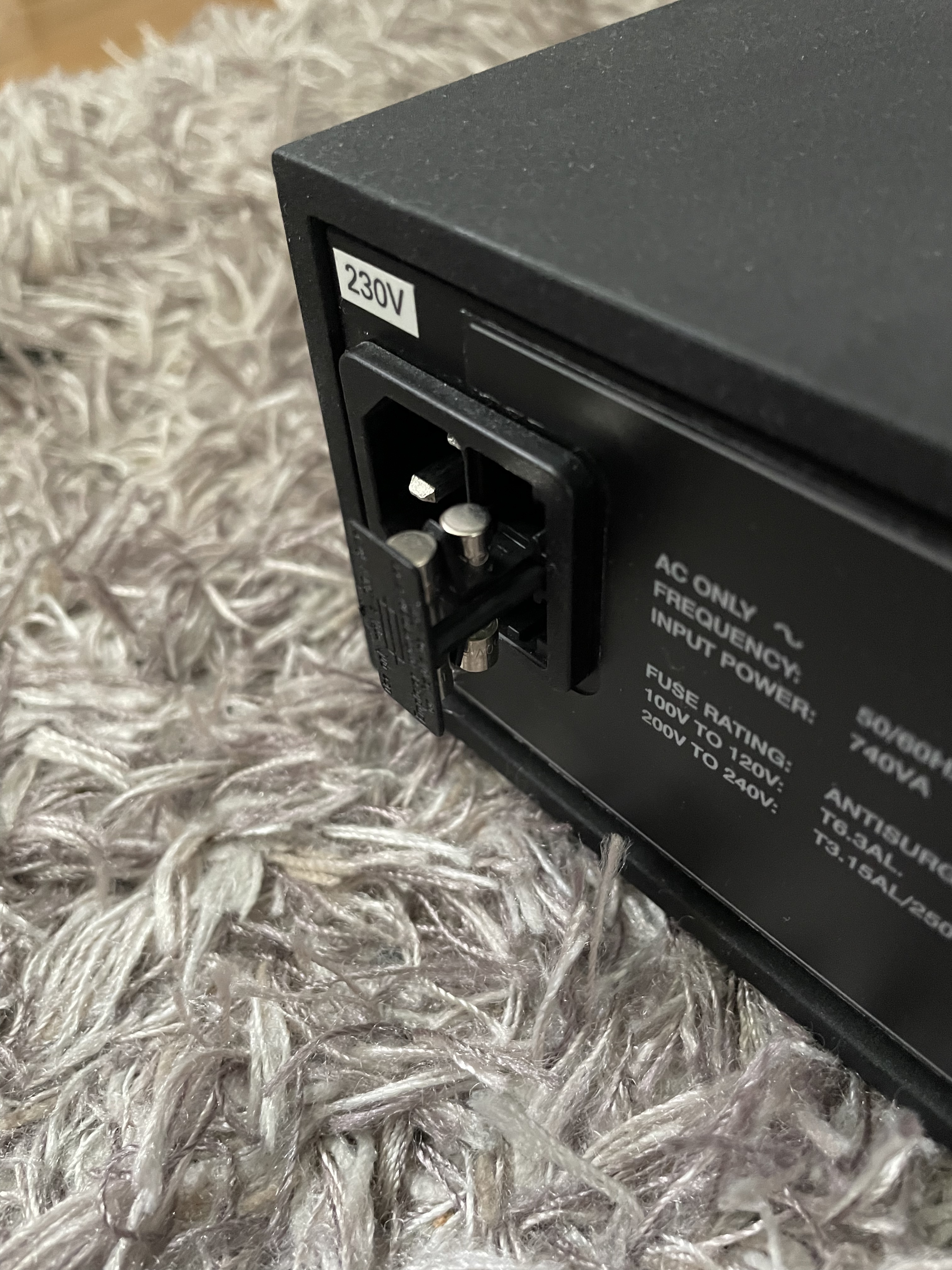

Inside the fuse holder I found two glass type fuses active one, was blown and another OK.
These are smaller fuses. and I guess also 13A I didn’t notice any marking but I conclude similar to the mains plug. Any recommendations on from where to procure please?

not 13A!! more like 315mA - it will be on the metal body of the fuse.

Been searching for 3.15A250V fuses 3/4 inch, 19mm still working on that. found some at 20mm

20mm x 5mm is the standard size

3.15A 250 19mm fuses seems at first sight not so easy to purchase. does anyone know of an shop that would sell these ideally in Surrey please, I mean I do see ebay and mouser but anywhere else?
Thanks Hifi-Dog, 20x5 thanks for confirming, as the fuses I have look more like 3.5mm - 4mm not 5.

There should be a spare fuse inside the holder. You said there were two in there. Only one is active, the other is a spare.
Exactly. Just replace the blown one with the spare one that sits behind.. I’m almost certain this will fix the issue and get it working again. I had a similar problem in the past.
Edit - if you want to replace the spare one, most dealers should be able to get one for you. You can also try places like cymbiosis where I seem to remember I got spares.
if your in uk- then analogue seduction have the correct ones, just pick the right rating which in on the metal cap.. they are £1.59 each so go crazy and buy 2!
