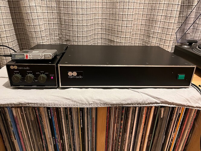

I couldn’t resist… I’ve bought a NAP160 and NAC12 that are 50 years old but appear to have been serviced in recent times.

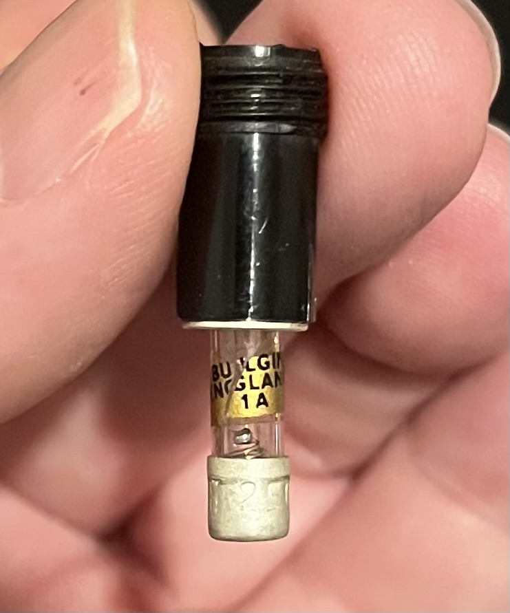

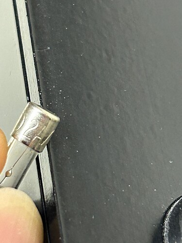

I’m giving everything a once over - ordered a new lamp for the power switch and a better Bulgin plug for the mains lead. I’ve just checked the fuse in the NAP and I need confirmation of its rating.
It’s a “Bulgin” branded antisurge fuse rated at 1A but when I had a chrome bumper 160, the fuse was 3.15A
Is there anyone old enough to know if 1A is the correct size? No label on the back of the amp to specify the rating and although it works, I don’t want it being under stress if it should be a higher value.
Incidentally, the fuse in the mains plug is 3A which coincides with the rated max current of the Bulgin mains connector so maybe all is well.

My unit says 2A / 250W on the fuse. It was serviced by Naim 3-4 years ago.
Perhaps one for Naim support just to be on the safe side.
Calling @NeilS

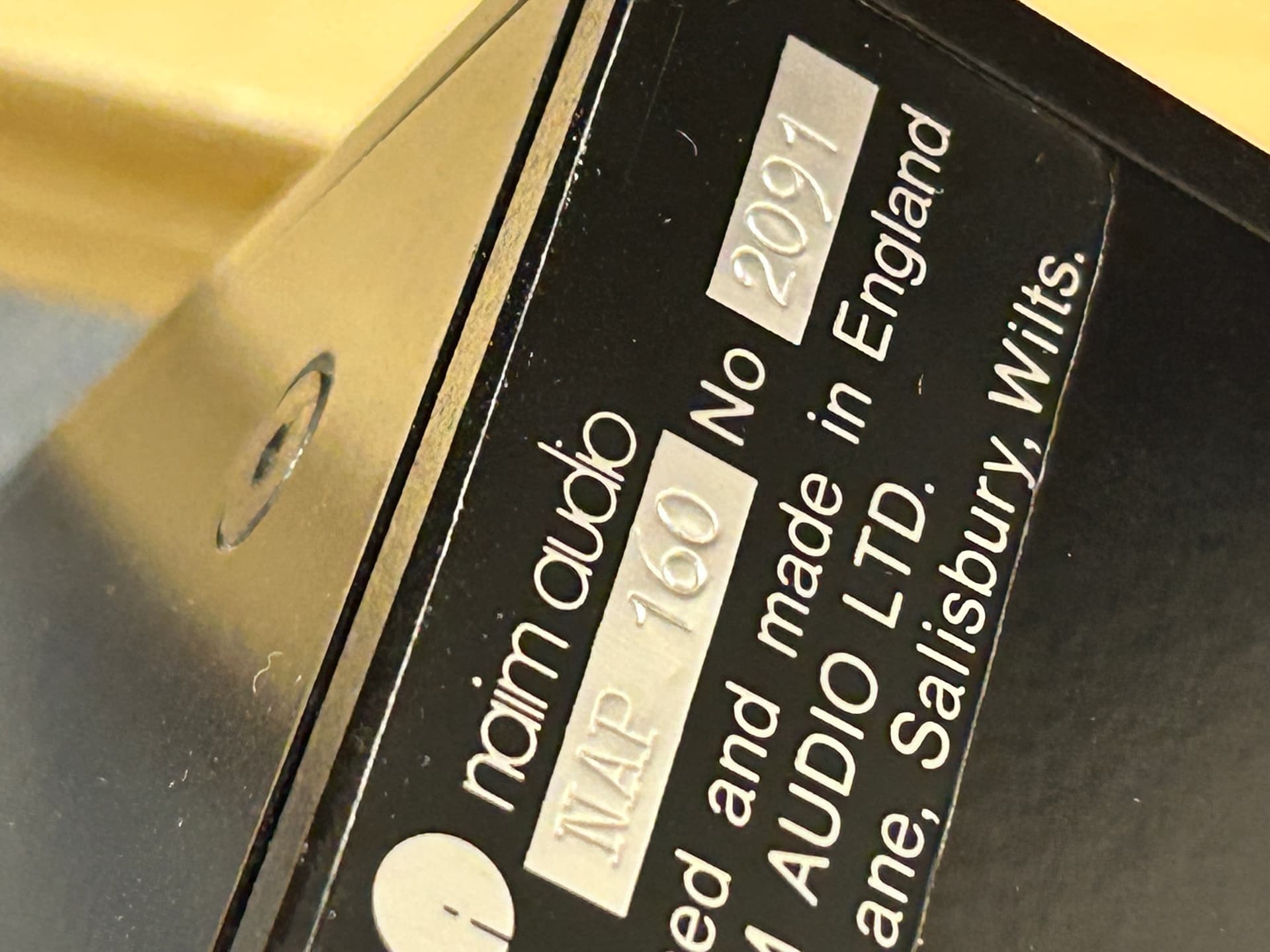

I can’t find anything concrete in the info I have available to me, but the bolt down & chrome bumper did use different transformers.
So off the top of my head -
BD = 240V - 2A | 120V - 4A
Chrome Bumper = 240V - 3.15A | 120V - 6.3A
I’ll report back next week if I find I’m way off the mark.
Regards
Neil.
Thanks Neil, I’ve got some 1A spares but will have a look around for a 2A whilst waiting confirmation.

As an aside, the 3A fuse in the mains plug blew when I powered up today so I’ve put in a 5A which is holding. The 1A in the back of the 160 is still ok but I’m feeling it should be a 2A as both you and Neil have advised.

Today I’ve fitted the 2A fuse and made up a mains lead with thicker cable and a safer Bulgin plug. I seem to have more bass.

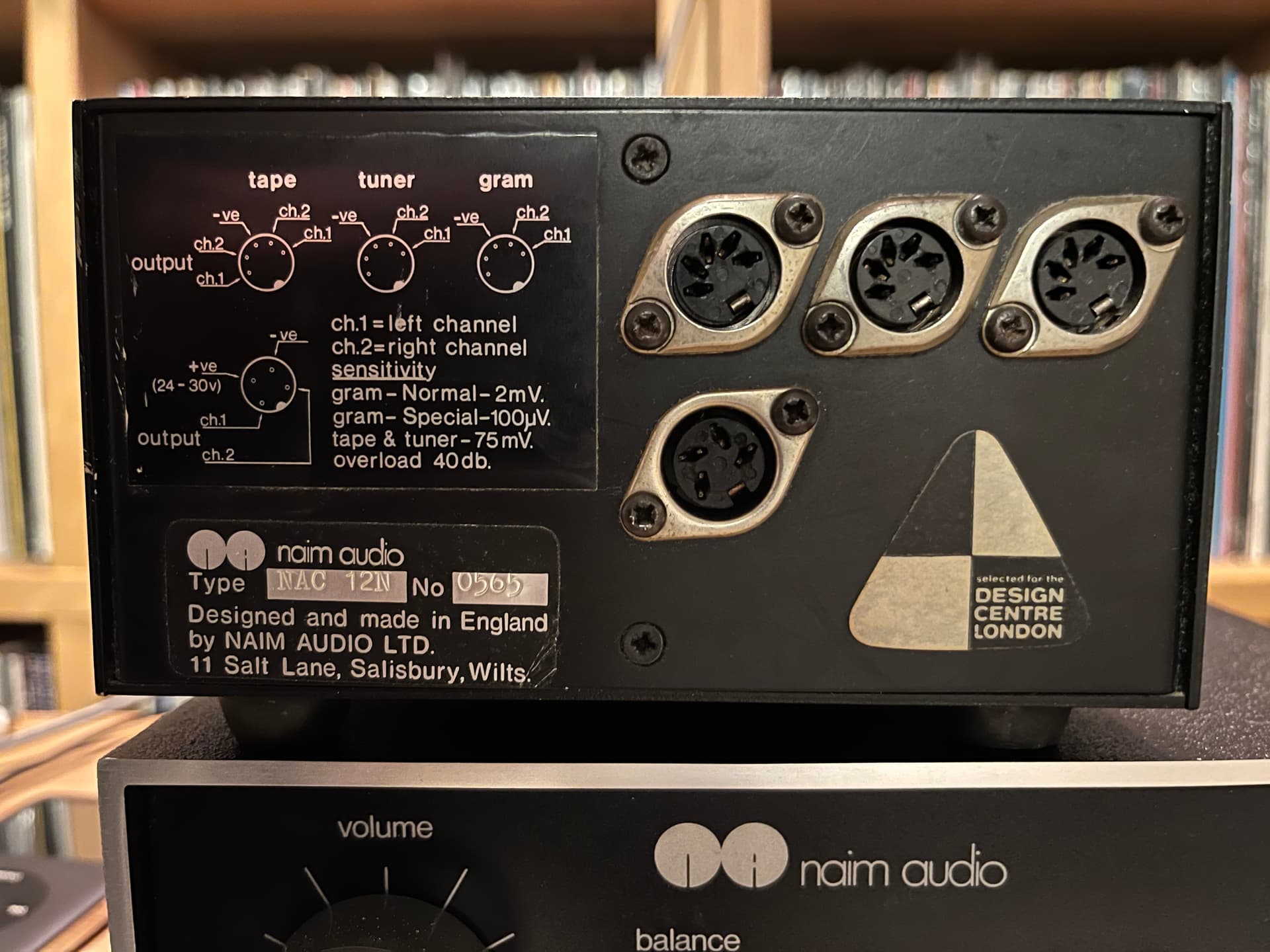

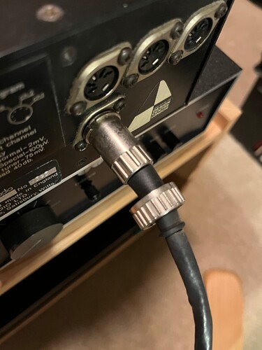

Do you think I should, I mean get a service agent to fit locking Preh DIN sockets? A bit concerned if one drops out as the weight of the cable is pulling on the connectors.
That’s how I blew a tweeter although it didn’t fall out - I pulled it out by mistake.
Giid to know it’s a keeper :grinning_face:
If you unscrew collar as far back as it can go, and push in as far as you can go, wobbly snaics are fine just don’t move anything once in place and powered up, be careful when dusting or cleaning around it,
I believe the latching DINs Naim used were made by Deltron, not Preh. They can still be bought - perhaps it would be easier to have a cable made up with them than to change the sockets on the amp?
The sockets aren’t even suitable for latching ones (I tried) and yet a lot of photos online show early NAC 12 with Preh sockets so it may be a common modification.
I went a step further and removed the screw to slide the collar off the plug, this seems to get it closer and feels more secure
It’s generally considered best to back the plug out of the socket a very small amount after fully inserting it in order to mechanically decouple it.
Obviously you need to consider the risk of damage doing anything other than locking it given that a SNAIC carrying power is involved, and the consequences of accidental removal are not good.
