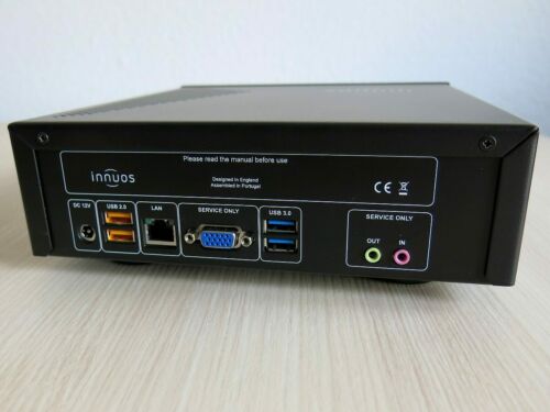

an innuos zen mini is also a good solution. Cost around 800 dollars, so much cheaper than the uniticore.
You can rip cds and store hirez files . The advantage vs a memory stick is that you can have your music library organized, with cover albums and metadata visible on the naim app.
