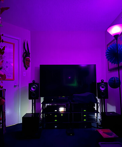

It might help if you post a photo of the system.

I appreciate everyone help I just want to make sure everyone understands that the system is not unenjoyable, it’s not broken, but its just not perfect depending upon the source material it can sound pretty close, being flac via USB, Some of the Internet radio, and the core. I definitely also feel it is source dependent & very choose which is to be expected at this level. Also, (and I know what everyone here is going not say but i don’t have a fraim setup yet so not a lot of air between boxes so, i know that plays a bit part, burndy placement isn’t perfect & the listening space at this time is small 10x12 so a lot of energy around the room when volume is up.
I tend to agree with others here that the 282/SC is not the bottleneck by any means. I run my ND555 in a non Naim setup (with Sugden amps) but I do have mine installed on a Fraim with a couple of shelves clear of the 555PSDR.
I found having the burndies clear off the floor and not touching as well as the Hiline clear and hanging freely improved SQ.
I suggest addressing your setup should be a priority rather than swapping out black boxes.

I’d also look at getting some diffraction on the walls of your room, lots of reflective surfaces. Have you also tried moving the rack away from between the speakers, or moving the speakers forward?
