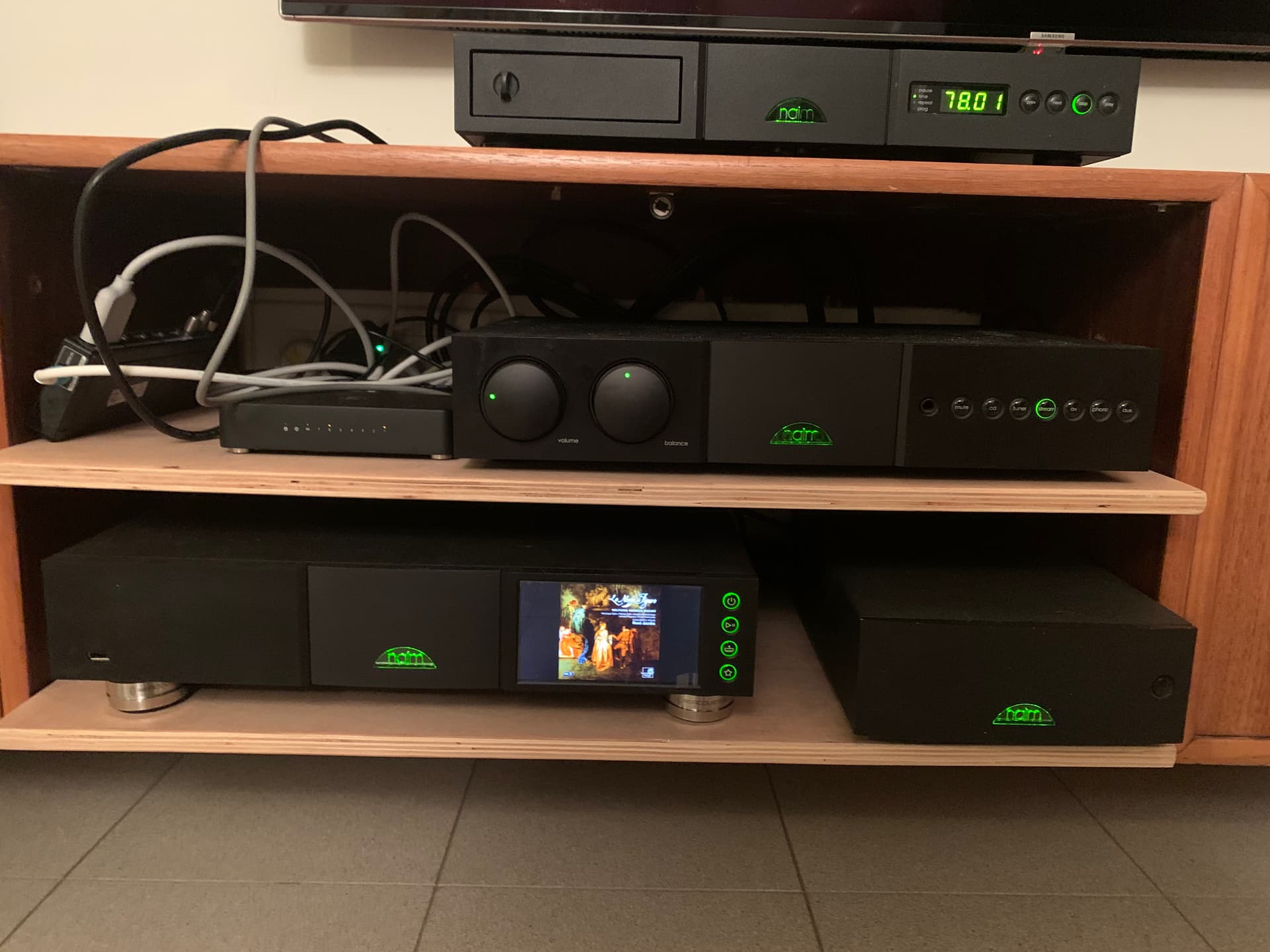

Hi, I have NDX2->SN3/HCDR->Neat Orkestra.
Sounds great
What do you think is the upgrade way forward ?
Should I start by adding PS555DR (source first) or SN3 to separate - in that case can I add just Pre or power to SN3?
In addition my stereo sits on standard shelves (made temporary shelves as furniture ones weren’t deep enough) since stereo racks looks most of the time like 19” server racks and I look for something that looks like a design furniture- any suggestions?
PS - isoAcoustics suspensions below NDX2 did good job.

First upgrade, which is free, is to remove that cd player from the top of your Supernait :slight_smile:

Good comment - My wife is architect and interior designer, the CD was on top of the upper shelve and she changes its location one day. Just went up again.
BTW this Cd-5i(italic) is part of my original Naim system. And still sounds great.
