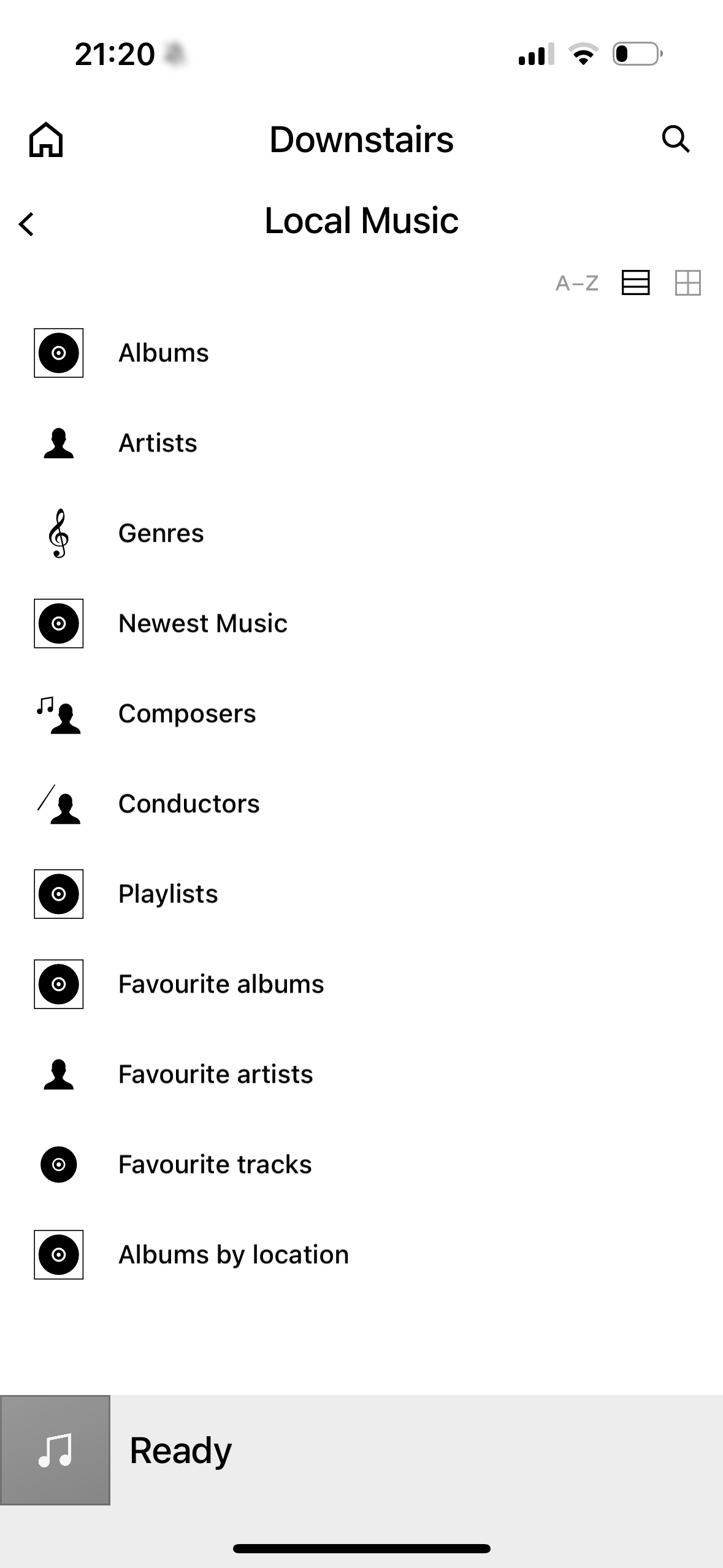

Yes, if I view a USB drive in the Server input I see these views. Both composer and conductor tags are visible. These are from either Unitiserve CD rips or purchased downloads.

I have the same setup - ripped my CDs to FLAC on my HDX, copied them to a USB drive and play them on the server input (front USB) on my NDX2. I see plenty of composers and a couple of conductors (I don’t have a lot of classical).

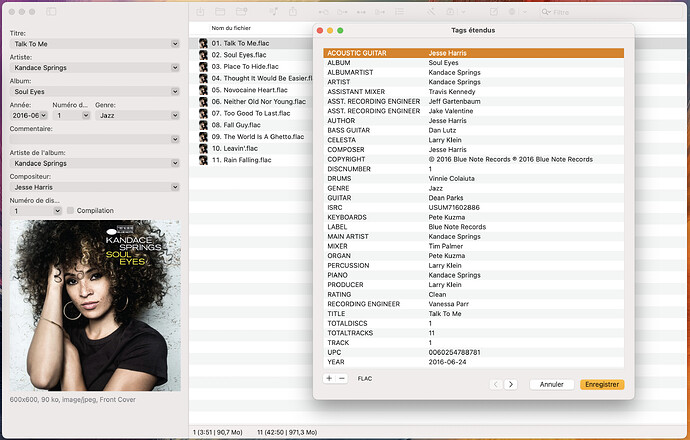

Have you tried examining the metadata? You could look at it using a metadata editor such as Metadatics or MP3tag, or just open the files using a computer and have a look.

- I’m using Tag Editor, tags seem fine. Installed Mp3tag, tags seem fine as well. In file properties all seems okay too. As I mentioned before the HDX showed them all.

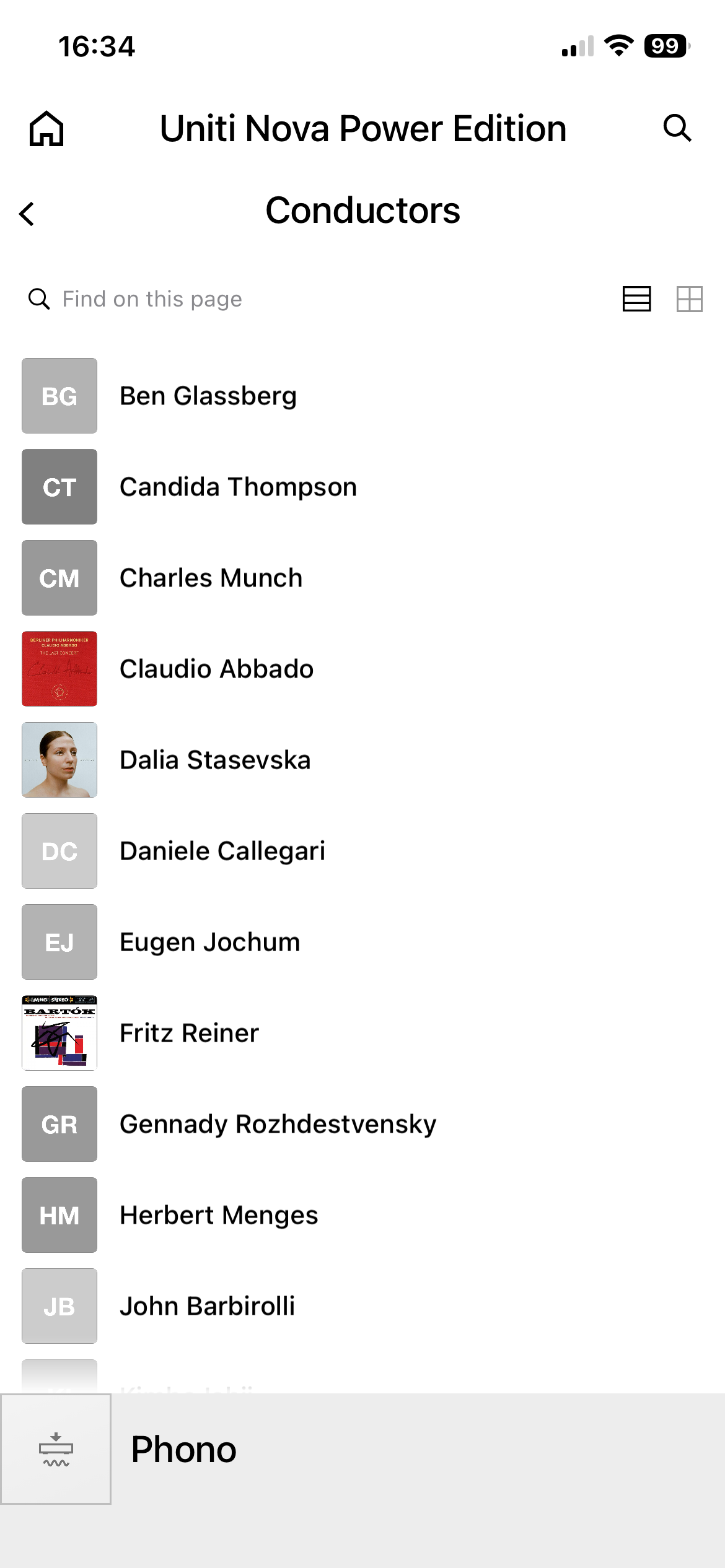

same here on my PE. saw composer 3 days ago, and now, it’s finish :frowning:
don’t know why
I have composers in MP3TAG, but only see Genres, Artist, Albums in the app
in MP3TAG

everything works fine for me now
