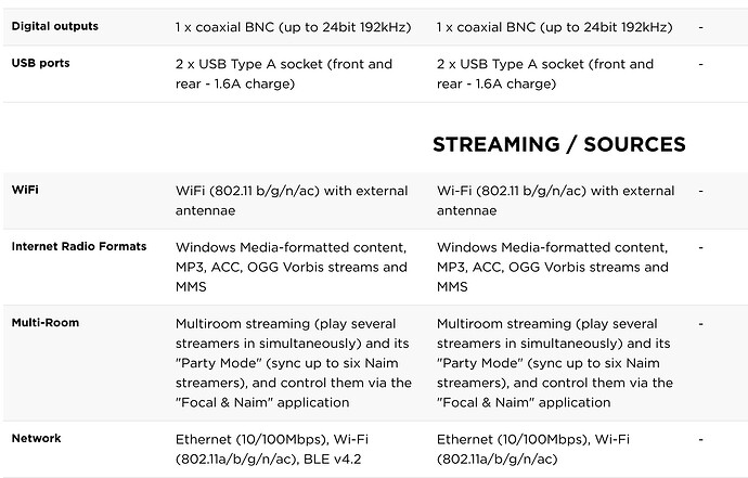

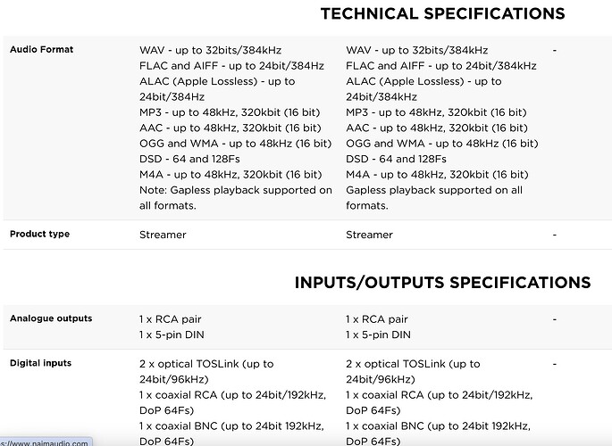

Hi all, considering UG’ing the NDX2 to ND555 so headed off to reassure my left brain to do so by reading tech spec for both. “There we go lefty, I told you we should make that purchase, its a no brainer! It’s got loads more clever bits and the numbers certainly confirm this. Let’s get the credit card out immediately!”
However looking at tech spec side by side there doesn’t appear to be very much different, well, in fact nothing. Now, I know there will be benefits from the additional isolation and shielding but can someone point me to the numbers or at least the clever bits that likely I won’t understand fully but I can make the case to Lefty? TIA.

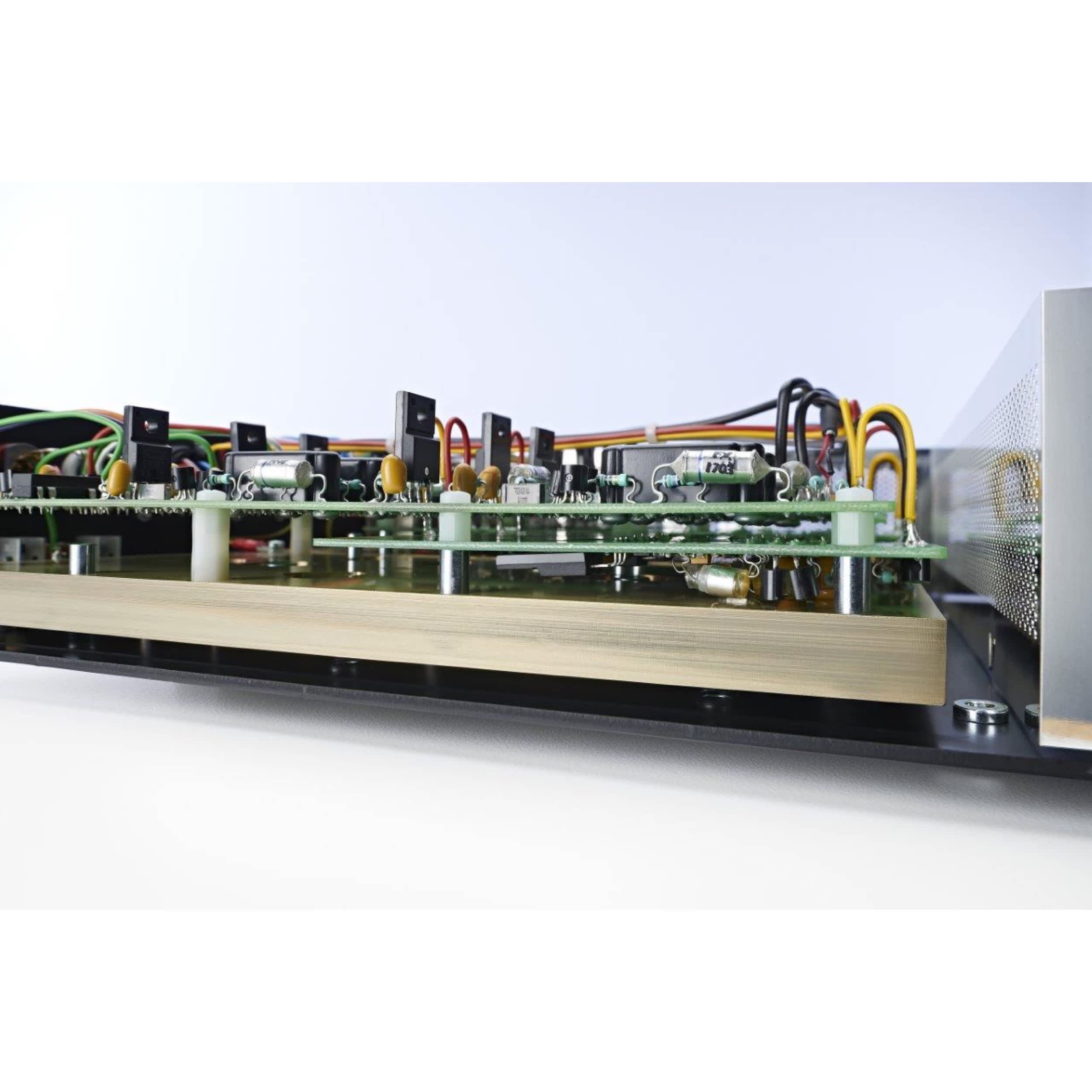

Tech specs of the wavs and flacs etc won’t show a difference, it’s the build that will. Look inside. The 555 has the internals floating inside a big brass cage.
“… the ND 555 takes this to another level [compared to the NDS]. The new Faraday cage system is now physically isolated from its environs and it is radio-opaque to a much higher frequency, thus considerably reducing any possible noise.”

Putting the circuit boards on suspended brass plates.
More internal DR regulators.

I think those specifications are mostly functional specifications, I suspect those of the ND5 XS2 are probably pretty similar as well. By functional specification I mean two amplifiers might both have a volume control and 3 RCA inputs, but be at opposite ends of the performance spectrum.
I think, as others have suggested, they don’t tell anything like the performance story between the two. I wonder if there is a set of measurements that would, and suspect you’d be better off looking at other forums, dedicated to such measurements, if that’s what you’re after. Even then I think there are strong opinions both ways regarding how much technical specifications can tell you about perceived audio quality. Hopefully you can listen for yourself before deciding. And if not, just trust Naim, they would not be where they are today if their product tiers didn’t produce meaningful upgrades in SQ. (ducks for cover :wink: )
