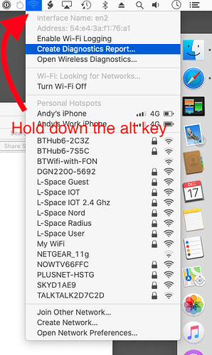

Try holding down the alt key over the Wi-Fi icon and left click:-

I am aware of the Alt+click on wifi to get the info on my MacBook thank you for the reminder.
