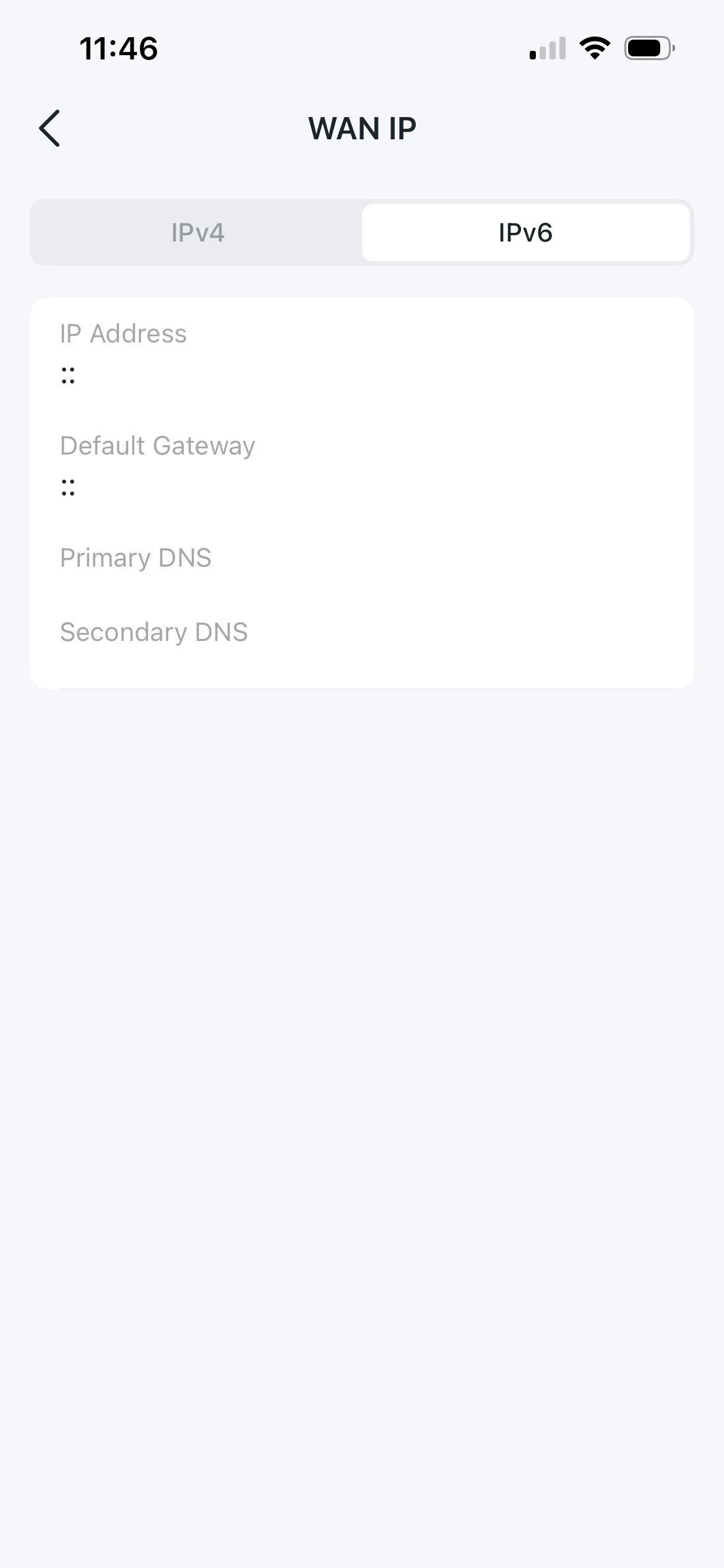

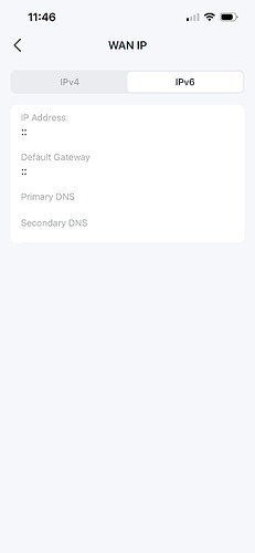

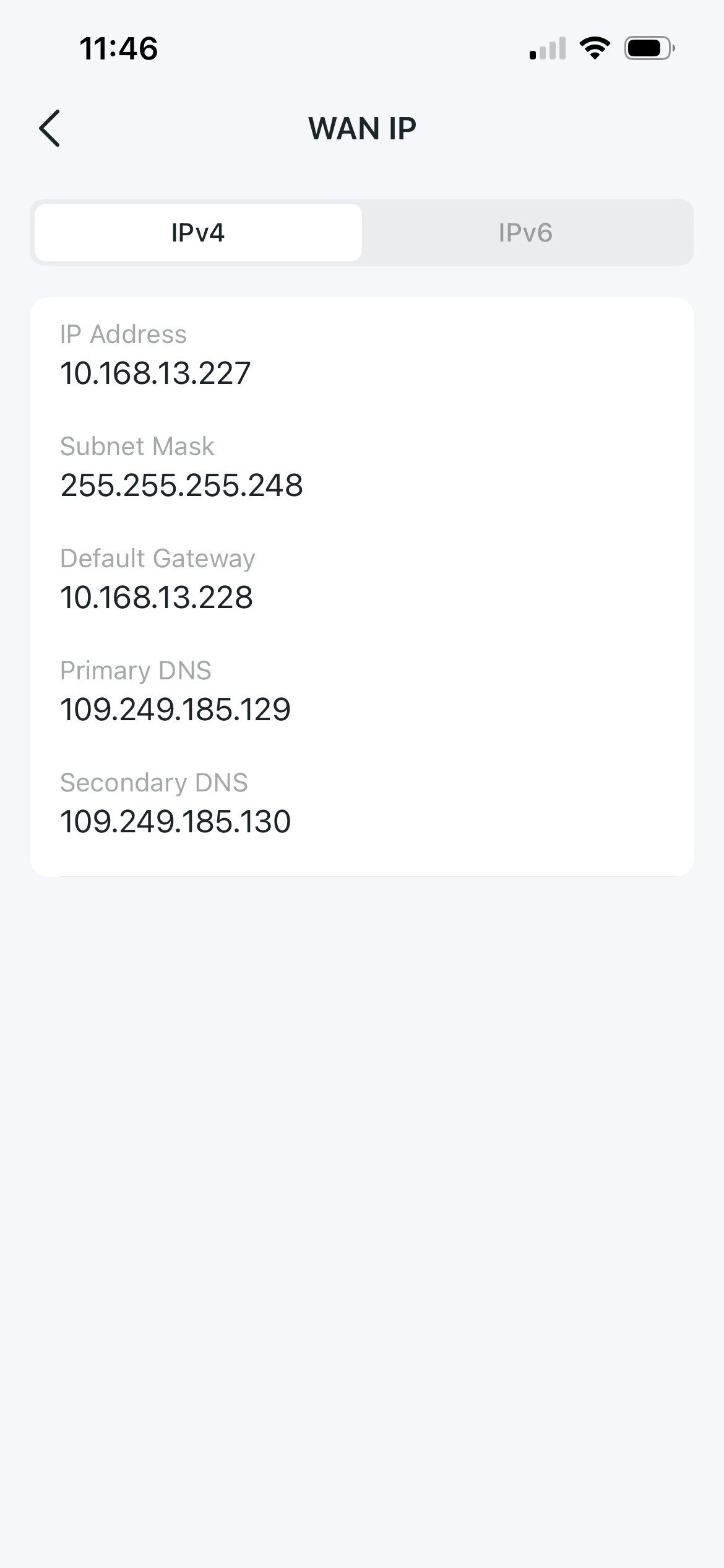

Thanks Simon . It’s not clear from the router settings whether I can manually enable IPv6. But under ‘Internet Status’ i see these clickable tabs:
Ok that look like your router is not enabling ipv6 or is incompatible with your broadband network. IPV6 comes up or should come up automatically - and is the preferred most performant option on mobile broadband and increasingly fixed broadband. The WAN IPv4 address also looks to be some sort of gateway DMZ address as opposed to the internet.. perhaps translating ipv4 to ipv6 somewhere in your ISP network… this is not going to be general great for throughput/latency consistency.
You can also log onto the diagnostic page on your Naim streamer and see what Ipv6 address you have been given if any. You can share here - just block out the last eight rightmost characters.
With no ipv6 on mobile network routers I am afraid it will be in my opinion a substandard experience - especially when content delivery network services such as streaming is used.
