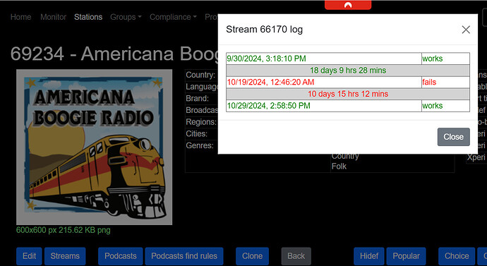

Good morning everyone.
Over the last year or so, I have been listening to Americana Boogie Radio using the link in the iRadio link, on a Unitiqute2 station list, in the NAIM app.
But over the last few weeks the link is not working. The streamer displays connecting and then sometimes you hear a short (2 or 3 seconds) worth of music then it goes silent (how ever long I leave it)
The odd thing is, that if then I try to listen to a another iRadio station after trying to connect to Americanan Boogie Radio, then it takes a long time to reconnect and has to reinitialise the conection, so it seems that the stream from Ameicana Boogie radio is causing an issue with the streamer.
I am still able to listen to the station via the web (firefox browser)
Is this an issue with my streamer or is an issue with the stream from the Americanan Boogie Radio?
Hi @Rick57
Based on the product you are using that is still based on VTuner and yes there has been issues with that station, independent of VTuner.
Here is an uptime log from our new system:
(that is scanned using many instances of VLC playing 100’s of stations at once, so an independent playback solution).
The MP3 stream that they are broadcasting has had issues.
We’ve recently switched to the AAC variant but it seems they keep on stopping broadcast now and then.
Overall, there is a reliability issue with this station, but the MP3 variant that VTuner use is extra problematic.
I’ll write to the station flagging up their technical woes.
