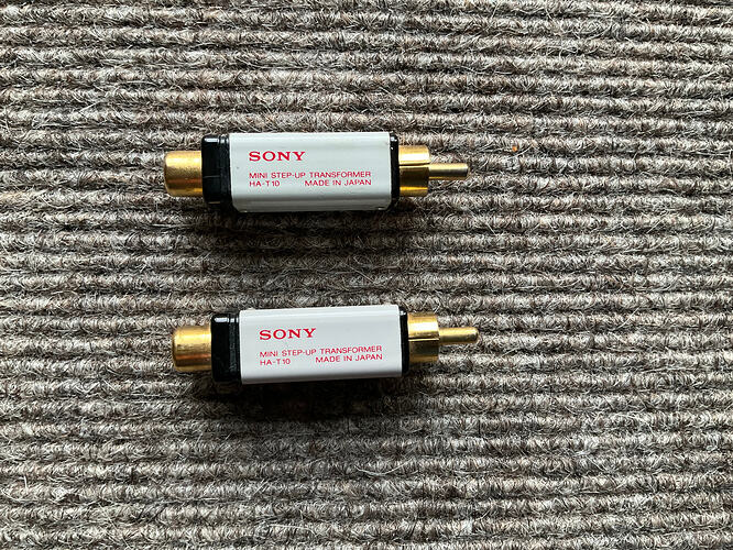

I have used SUTs with several MM phono inputs with very good results. Among the amplifiers were the SN3 and an Einstein The Tune, cartridges were the Sumiko Pearwood and Transfiguration Temper.
If the phono stage in your NSC 222 is in the same league as the one in the SN 3, try the SUT route. A good way to see what you can achieve is via a pair of plug in transformers. I have used these:
The Ortofon T 5s are identical, Empire sold them too, but I don’t remember their name. All three are readily available on the used market. When I bought mine, the Sonys sold for around 10% less than the Ortofons.
