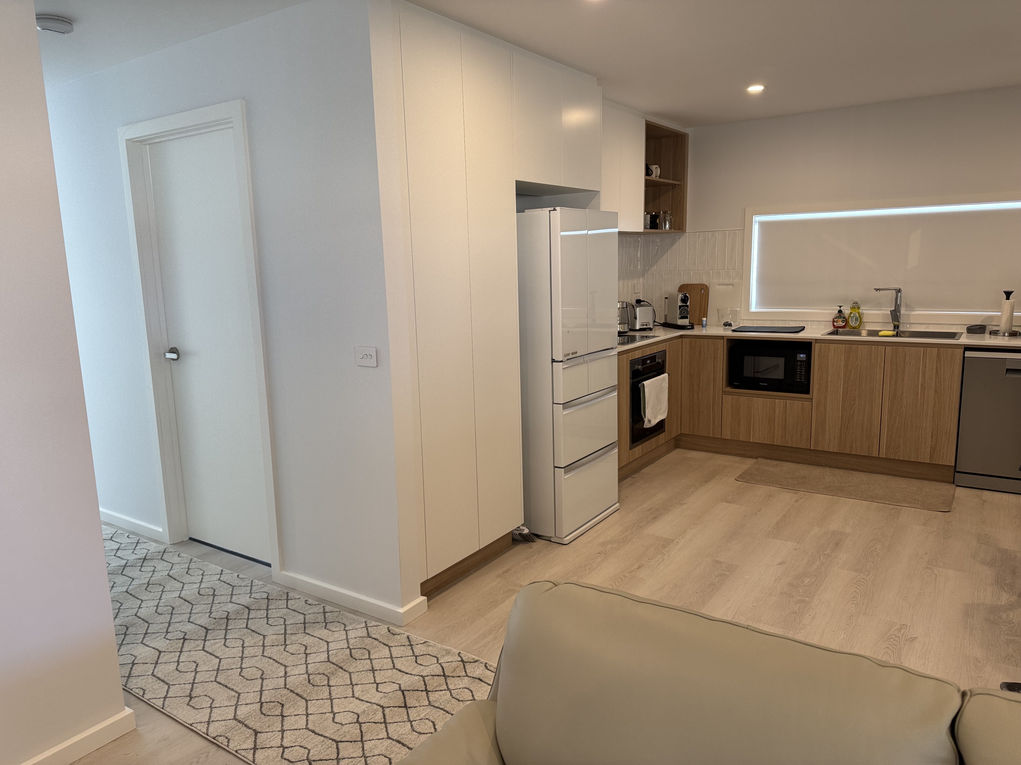

So here goes, I’ve recently moved house and I’m not 100% sure I am in an OK spot to enjoy my system - room issue wise.
I’ll put up some pictures to help show my area, please excuse the clutter, I’ve only just moved in a few weeks ago and I’m still adjusting things around and such.
My set up is:
Speakers 80cm to back wall, 40cm to each side wall, speakers 2.23 m apart (tweeter to tweeter) and 2.27 m each speaker to my listening position.
The room itself is all drywall (except the outside facing walls, they are brick veneer and drywall inside. Solid concrete house pad floor with vinyl floor covering.
Just got the big wool rug in the picture today and it “appears” to have tamed the flutter echo a fair bit.
I’m getting a quote for an internal door and plastering to block of the hallway in the floor plan picture.

The problem is very obvious: the cat is in the wrong place!
That looks to be a challenging space, though at least it looks as if rear reflections from kitchen end aren’t likely to be an issue. Given the window being a fixed feature, first I’d be thinking a large area of acoustic panels on right wall, most critically on the reflection points but better much of the way along, md to high frequency. (Aesthetically I’d suggest ‘art’ panels with images of your choice -photographs or painting reproductions.) Low frequency absorbers in corners on each side of the TV may be beneficial as well. Something with ceiling at the two reflection points likely would Not sure how thick that rug is - the thicker and larger the better.
Heavy curtains to cover the huge window would undoubtedly improve things for night use - and pulled to the corner front left could even be beneficial when open.
Not sure where exactly your seat is: best not in centre front to back of the room. A theoretically best position is with ears 38% of room length from front (or same from back), in your case 3.4m. . If not done already it would be worth a try, and moving front and back, and ditto playing with speaker positioning.
But re treatment perhaps best to engage services of someone like GIK Acoustics, who offer free assessment and advice.

It’s a tricky space; I would be tempted to change the orientation of the room so the speakers fire across the room rather than down. I understand that this might not fit with your life style but it may help you identify any inherent acoustic issues with the room.

V difficult as it is, with so many hard, smooth, reflective surfaces. Suggest try almost any kind of fabric panel behind your head, which will cut down at least some of the reverberations.

With the length of room behind the listening position, and some scattering be kitchen units, I doubt something suspended behind the OP’s seat will fix much.
