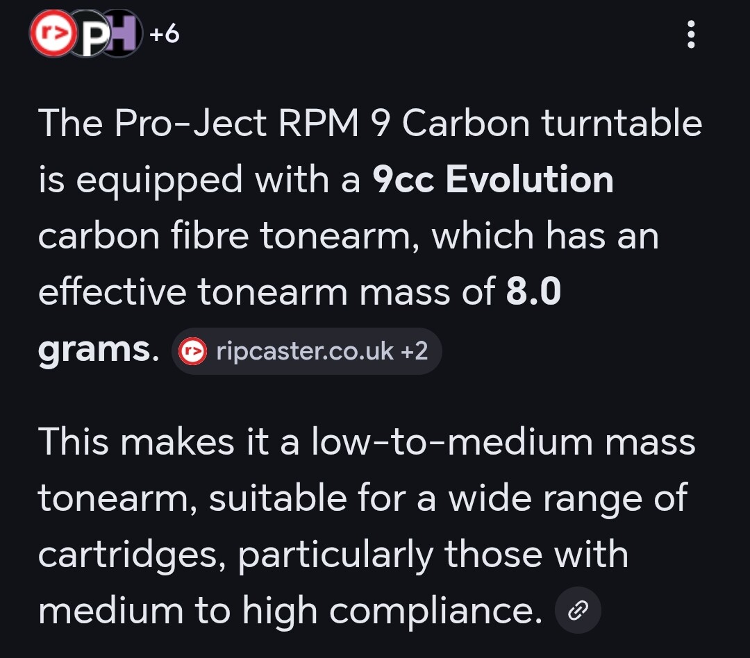

According to the AI on my phone the project arm is 8gr EM.

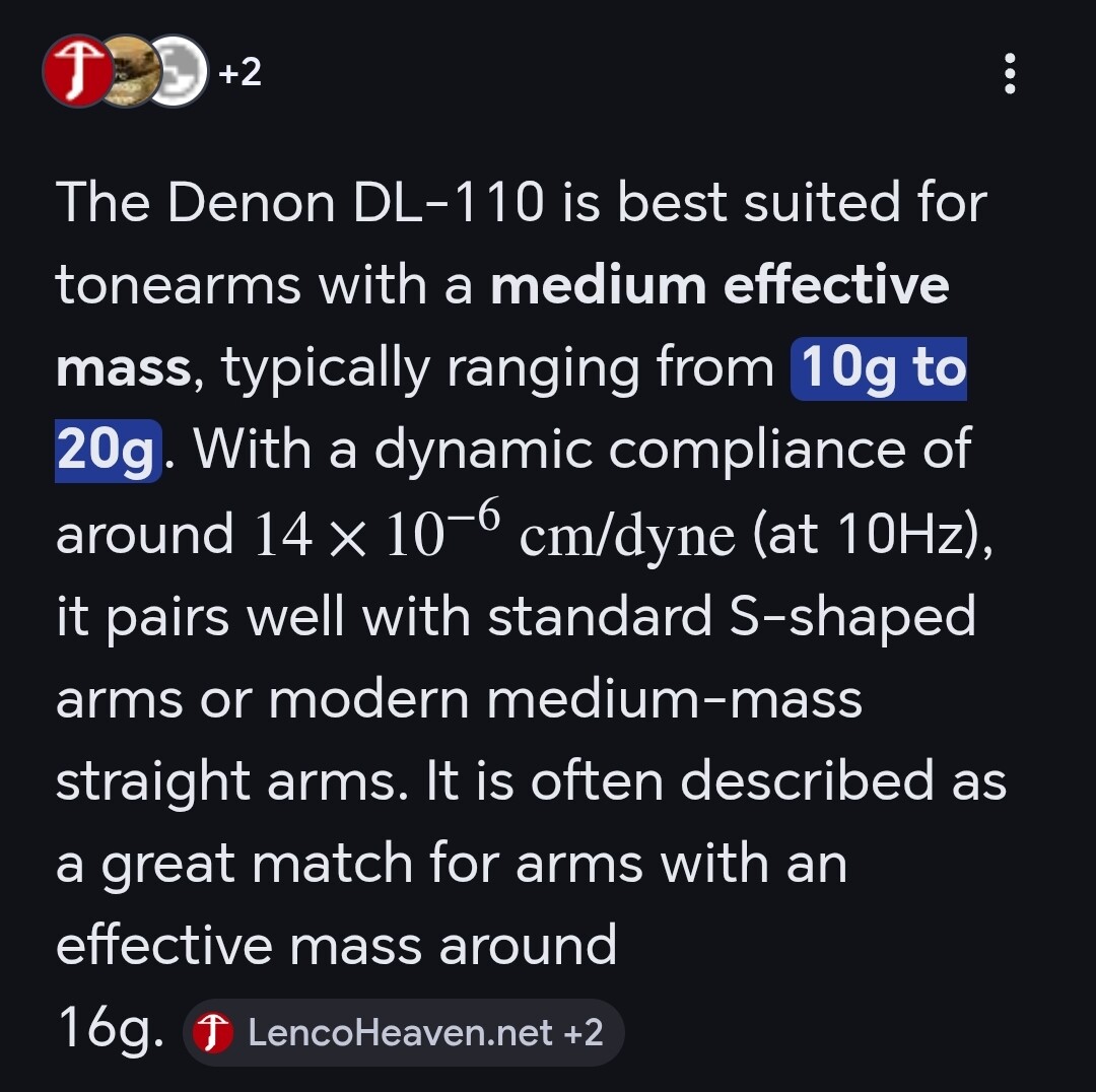

The DL110 needs 10 to 20 gr EM.
I have a Denon turntable/arm, the arm is about 18gr EM. So maybe 8gr arm is a bit low.

Thing is, whilst the DL110 is a good cartridge, as @Fatcat has shown above, it is not a good match with the Project tonearm. Whilst the fingerlift will add some mass, I’m not sure it will bring everything into the ideal place.
Search for Vinyl Engine cartridge resonance evaluator. You need the know the effective mass of your arm, the weight of the cartridge and mounting hardware and the cartridge compliance. The best match is a cartridge that falls in the green zone.
