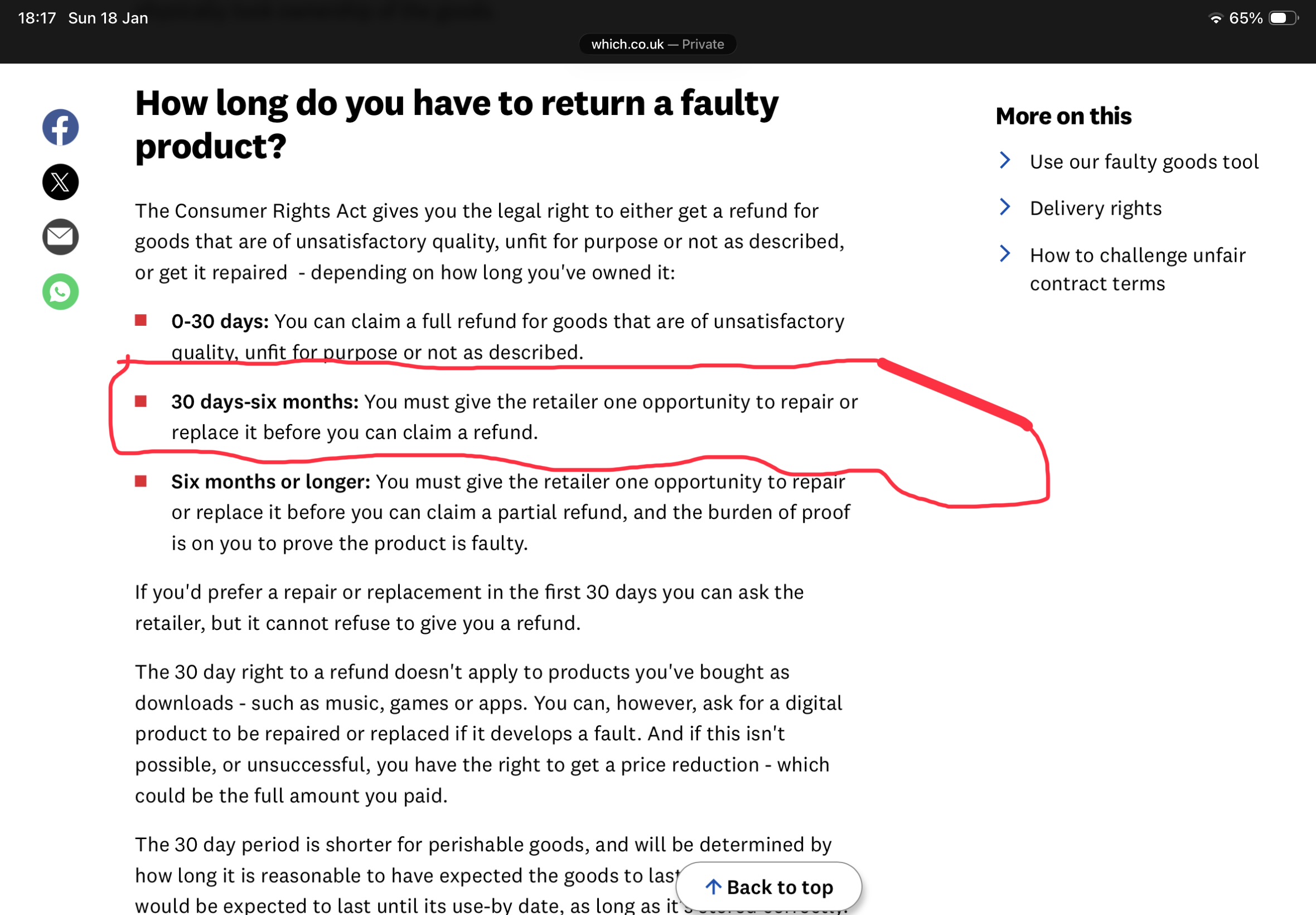

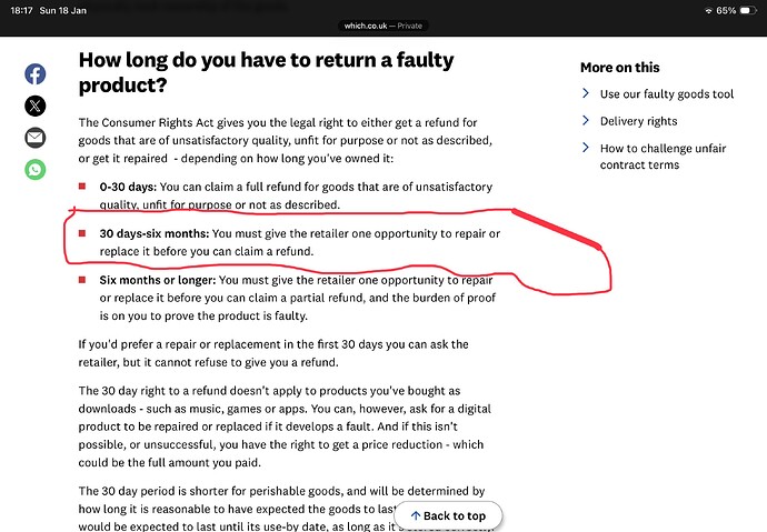

Did you not say purchased new last November?. Under warranty and therefore straight replacement or am I missing something?
Unfortunately not after 30 days according to the Consumer Rights Act. But thanks for the prompt.
