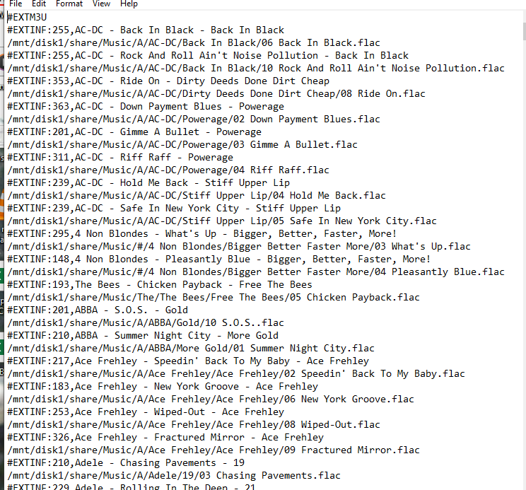

Can you paste in the contents of one of the lists here, in case we can spot something?
Here you go, the dozen or so out of 498 in this particular playlist…

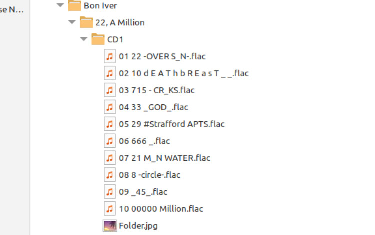

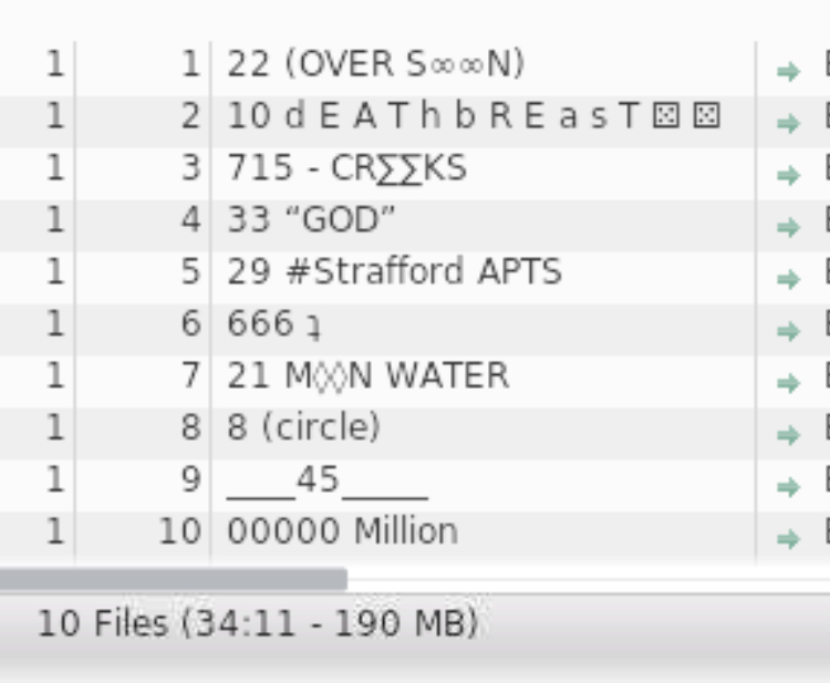

I was hoping for the text rather than a screen shot, but that aside I cant see anything that obvious, although as a general rule, I do tend to strip out any non alphabet characters from filenames. This was an issue a while back then fixed, but I find it best to remove them in the first place. ‘&’ were a particular issue IIRC, but I also remove things like ',! etc
Bon Iver, “22 a million” album;
Guess the file names!

I don’t think it’s anything to do with unusual characters in file names as the behaviour is consistent across different playlists and when I cut down the playlist to the first 90 tracks it works perfectly.
The Melco also does a good job of taking them out of file names when it does the ripping.
