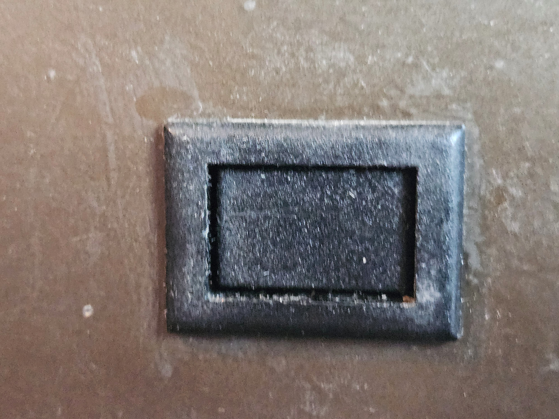

Once fixed consider cleaning the switch on outside - your switch appears somewhat dirty or just dusty.

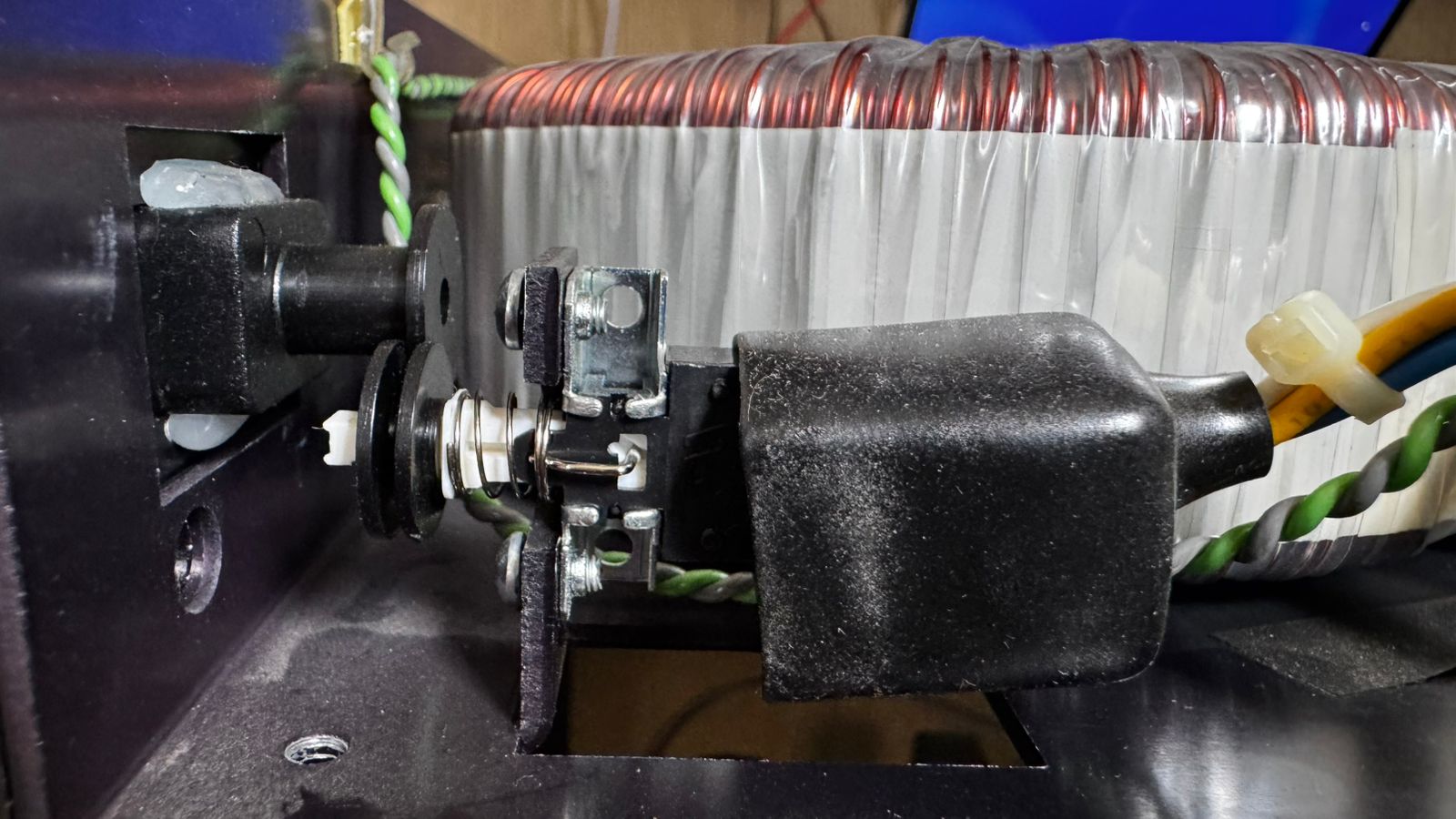

This is what the olive supercap power button looks like.
I assume it should be the same on the NAP 250.
These are the same switches. As I’ve already explained, you need to insulate the area around the button, particularly where it’s near the transformer, and apply a thin coat of lubricant to the piston above the spring, which can be seen in the photo. And replace the blown fuse.

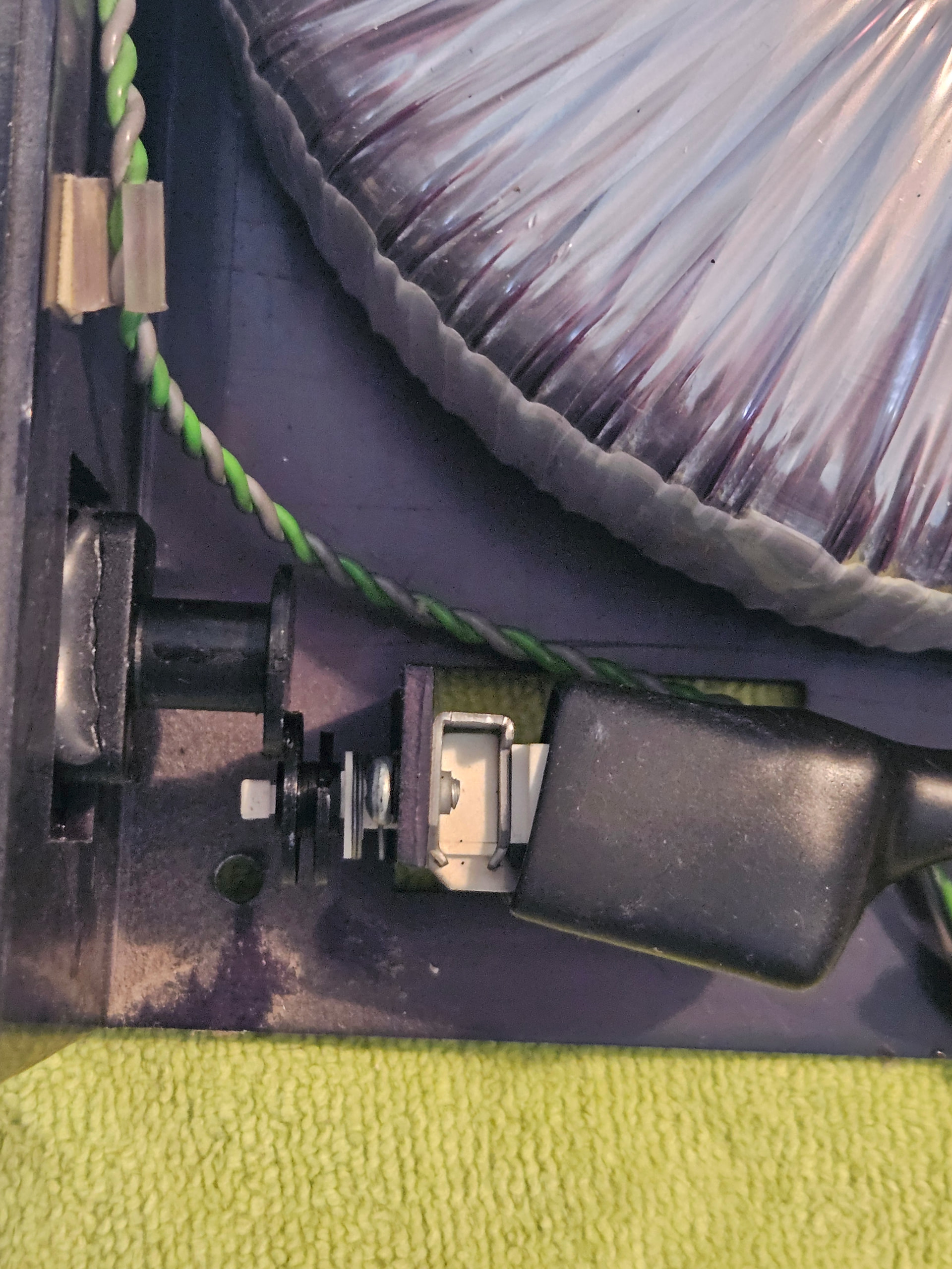

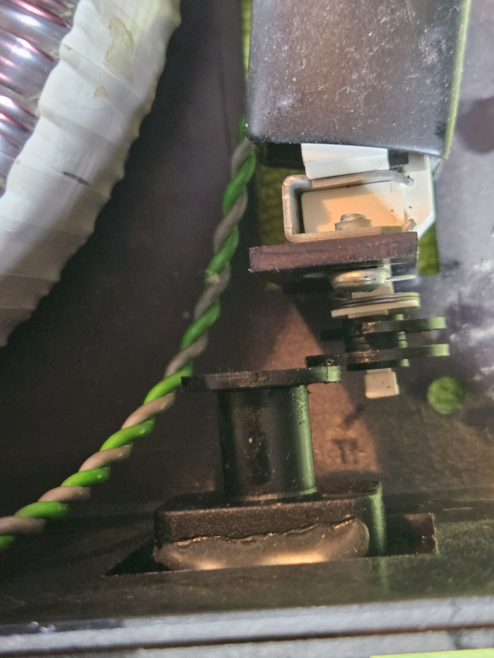

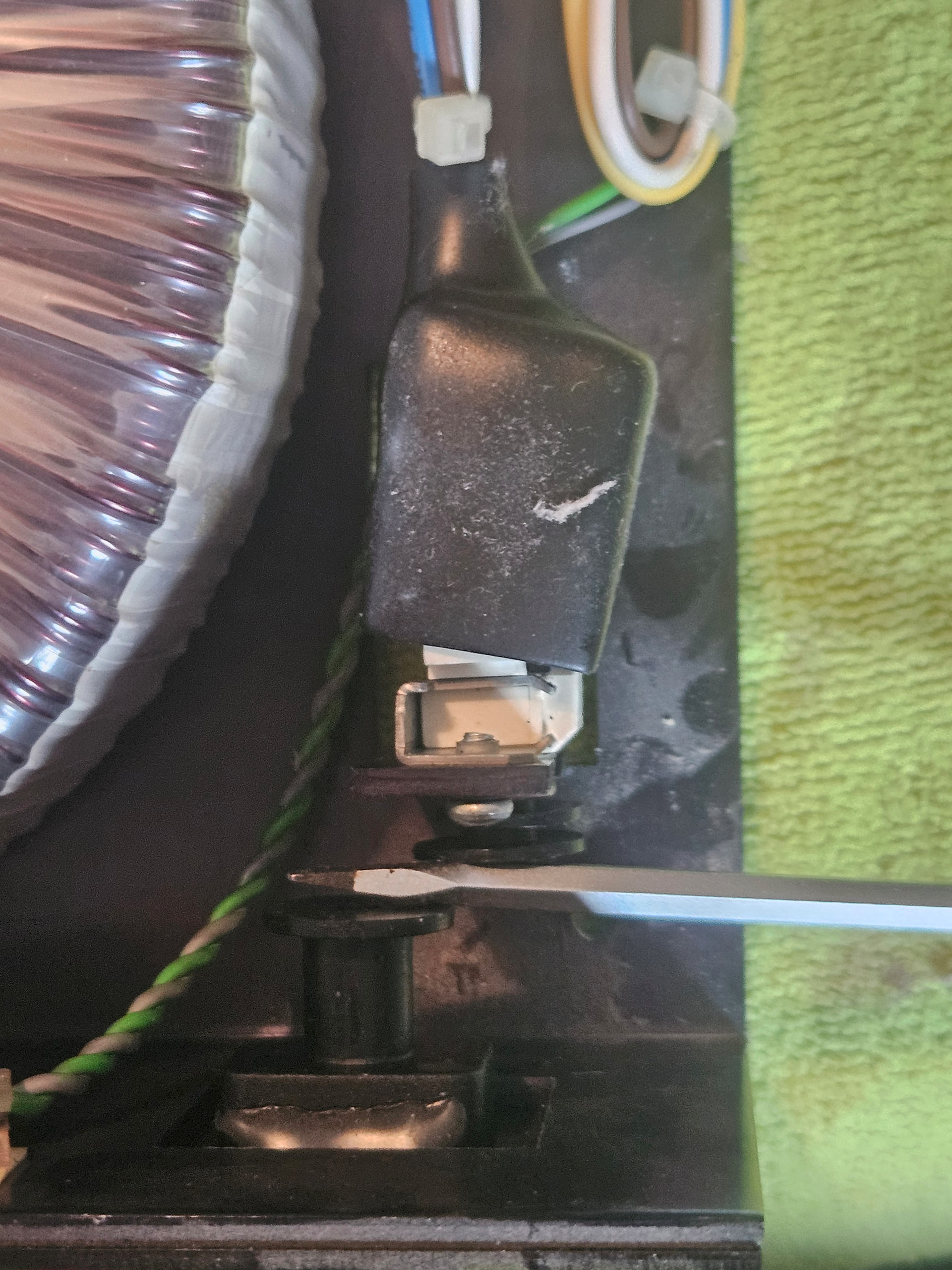

I have opened up the box and this is what I see. The fuse is actually working (I tested it with a meter) but the switch seems to be totally out of alignment.
Thed switch seems to be working but a bit of the plastic on the shaft seems to have broken off and push button is not connecting to the switch. I am going to bring it back to my dealer.
Yeah. The switch needs to sit between the two circular plates on the part where the mains comes in, so it looks like it’s been bodged after a piece snapped off
The first time I see this kind of arrangement of a switch..
