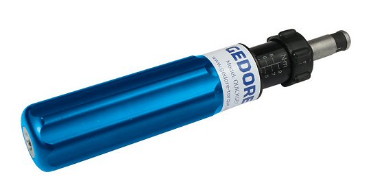

So yesterday a friend came over to check the torque settings:
The bass drivers torque settings were good, almost no need to re-torque them. But the BMR needed some re-torquing, something around 90°-120° until 2NM was reached on the scale of the tool.
Although this is the recommended setting, the heights sounded too harsh/shrill to my ears then. Maybe the scale on the tool was not absolutely precise.
So after about an hour or so I slightly loosened the screws around 20°-30°.
So this evening the speakers just play wonderful music, seems the torque setting is just right now: They were a but dull when they arrived, but after re-torquing and letting them settle in one more day, the sound is very open but not too harsh/bright, sounds just right to my ears.

That is what happens when you over-tighten the BMR housing bolts front and back. Naim recommend 2nm and I found a little less that this with my torque-driver (1.97nm) was better. I don’t know what the actual setting is but too tight (it glares) or too loose and it ā€˜zings’ - you need to back and forth until you hit on the right setting with your device and write it down for re-check again in a few years. If the speaker is not moved much then it should remain good for several years.

May I ask what sort of torque driver you use to set the screws to within a few hundredths like that? Drivers I’ve used are marked in tenths rather than hundredths, and generally have a quoted accuracy of within 6% which looks like it would make them far too imprecise for such an exact setting.

I use one of these.
I don’t mean to say that the setting is absolutely accurate, but that I found the relative setting by the driver could be hear as different as you increased the setting or decreased. I spent a bit of time out of interest and that is what my driver said.
So another driver may be several % different is what I mean (different relative device tolerance) but possibly near Naim’s setting or a bit less is where to begin.

I think that another advantage of the above is that the force applied to the bolt at 0° angle.
On the contrary with ordinary torque wrenchs you are rotating at an angle of 90° and with bolts this small it’s easy the skip the driver and damage the head.

I can’t imagine that anyone would use a ratchet spanner/socket type torque wrench to tighten little screws in a loudspeaker. They are best left to car mechanics etc.
The screwdriver type is now common, an electricians are required to use them when making electrical connections in junction boxes etc. and there are plenty on the market.
