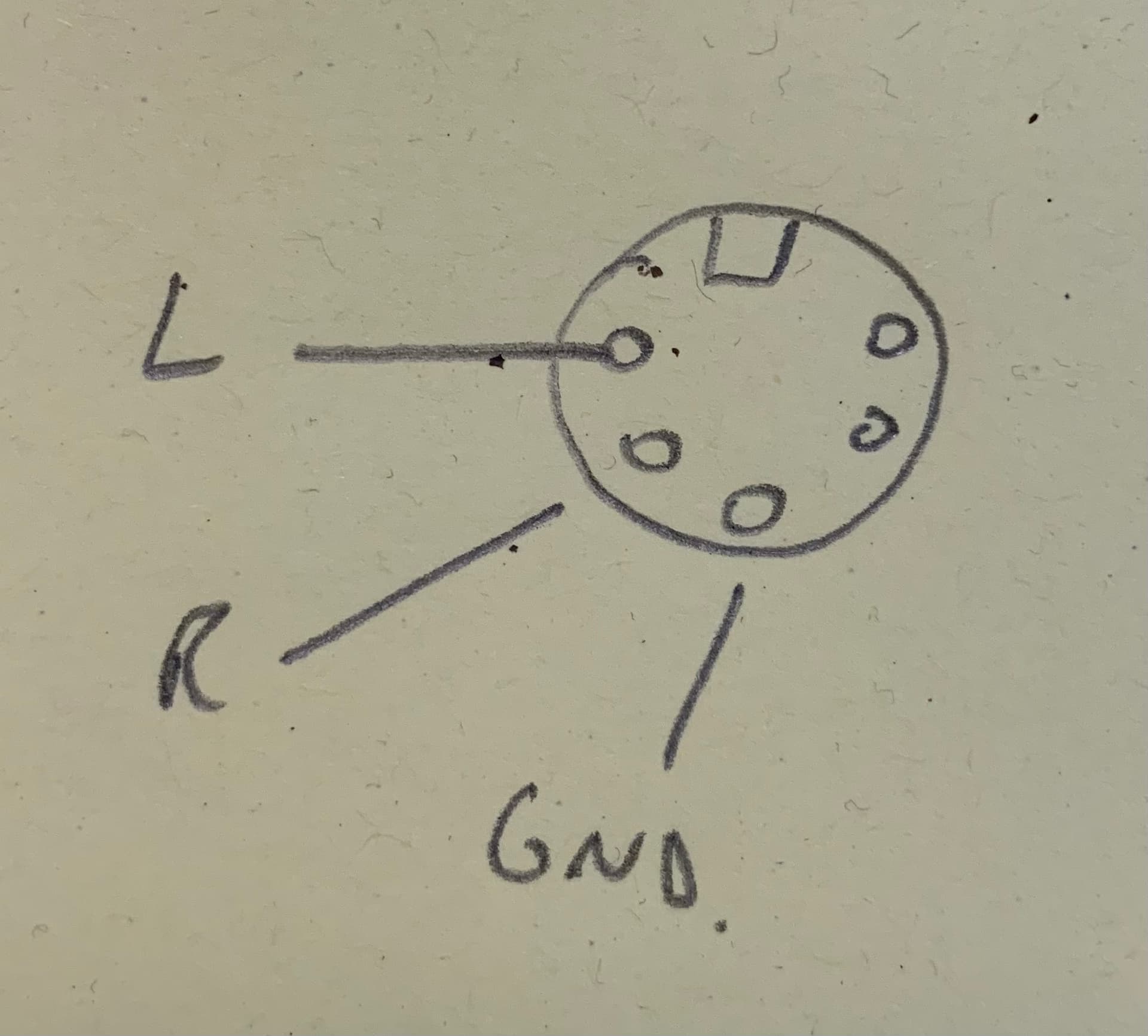

I’ve got my project phono amp plugged into the av input and it doesn’t work but when I flick through the buttons on the front it works on all the different channels I put it on like cd tuner tape but when I put it on av it doesn’t,why is this
It sounds like you have a cable wired as an output cable (at the DIN5 end) rather than an input cable. I suspect you’ll get this working through the other inputs too if you connect it to the the Aux 1 and Tape inputs, but nothing if you connect it to the Tuner or CD inputs.

You need a 180 degree 5 Pin DIN plug. This is how it should be connected from the solder side of the plug to work as an input cable.
From your description and profile with the NAC112, it sounds like you are feeding the phono stage output into the outputs on those sockets, hence why you can hear it across multiple inputs. I’d get th right cable.

Yes, give it a go. That should at least tell you if you’ve got a correctly wired cable. The output pins which appear on the Aux1, AV and Tape sockets are post input switching but pre volume and balance hence why it’s possible that feeding the output of the phono stage into these pins with an incorrect cable may be allowing the phono stage signals to come through on the other inputs.
Sounds like the cable is wired at the DIN end for REC (out) pins rather than PLAY (in). This kind of cable is ideal for connecting a headphone amp to a Naim preamp, but no good for connecting a source to a preamp. You just need a standard 2 x RCA phono - DIN5 interconnect.
Correction the pic below is the one
And this is connected up to the phono amp
