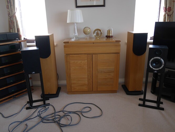

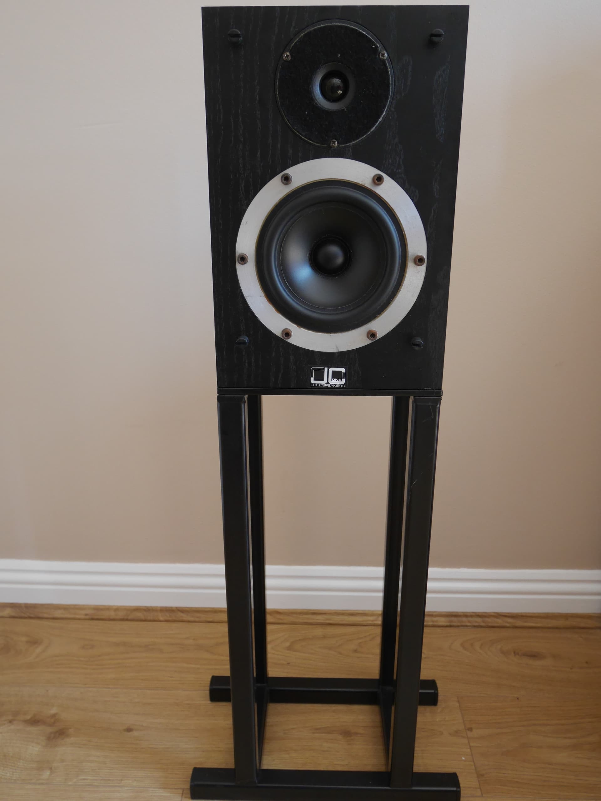

I decided today to get my old speakers out of the loft where they have lived for the past 15 years. This was prompted by the recent passing of their designer and maker John Chapman followed with a lovely chat I had yesterday with Phil at Nytech who wanted to know more about their history and have some photos for their website. The speakers became the Ion Systems JC-1 but mine were earlier prototypes, sold directy to dealers before they were made by Ion.
I couldn’t resist hooking them up to the main rig to see if they sounded as good as I remembered so I plonked them on to their stands (no spikes or blutack) and used some Linn K20 cable as the NACA5 I have is in trunking and the height is set for my Kudos S20’s.
I put on Sophie Zelmani – ‘God Do You Hear’ from ‘The World Ain’t Pretty’ and was immediately struck by how good they sounded, probably better than I remembered, no doubt heped by the kit that was driving it. They certainly reaffirmed my feeling that these are the best small speakers I’ve ever heard.
The track has a long introduction and just as he vocal kicked in everything went very dull and muffled sounding. It soon became clear that BOTH tweeters are no longer outputing sound.
I haven’t investigated further yet. The tweeters should be the same as used in the SBL’s which I know are being discontinued but I wonder if a crossover component could have failed, either cutting the output to the tweeter or worse sending a full range signal! I know John used Hiquphon tweeters as well, possibly the OW1-92 looking at the description.
The tweeter seems reluctant to come out. I suspect there’s some sealant in there. They are 35 years old or so. I need to have some time to try to remove them, possibly going in by removing the bass unit first and pushing them out (assuming the bass unit removes easily)?

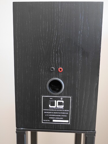

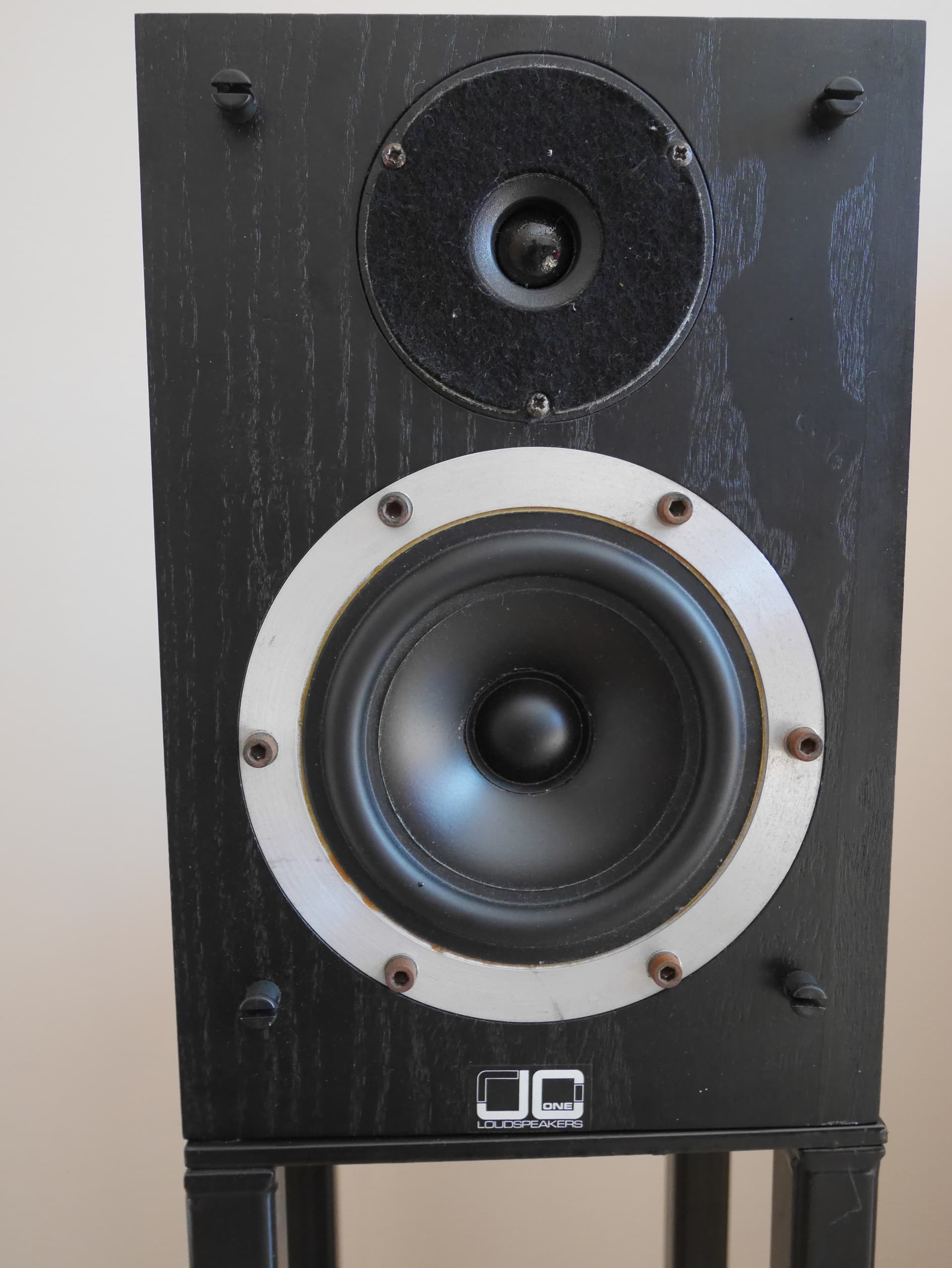

For anyone interested here are some pictures.

The tweeters do look like Scanspeak D2008s however, you should check whether they are the ones with Ferrofluid or without. Naim use the ones without.

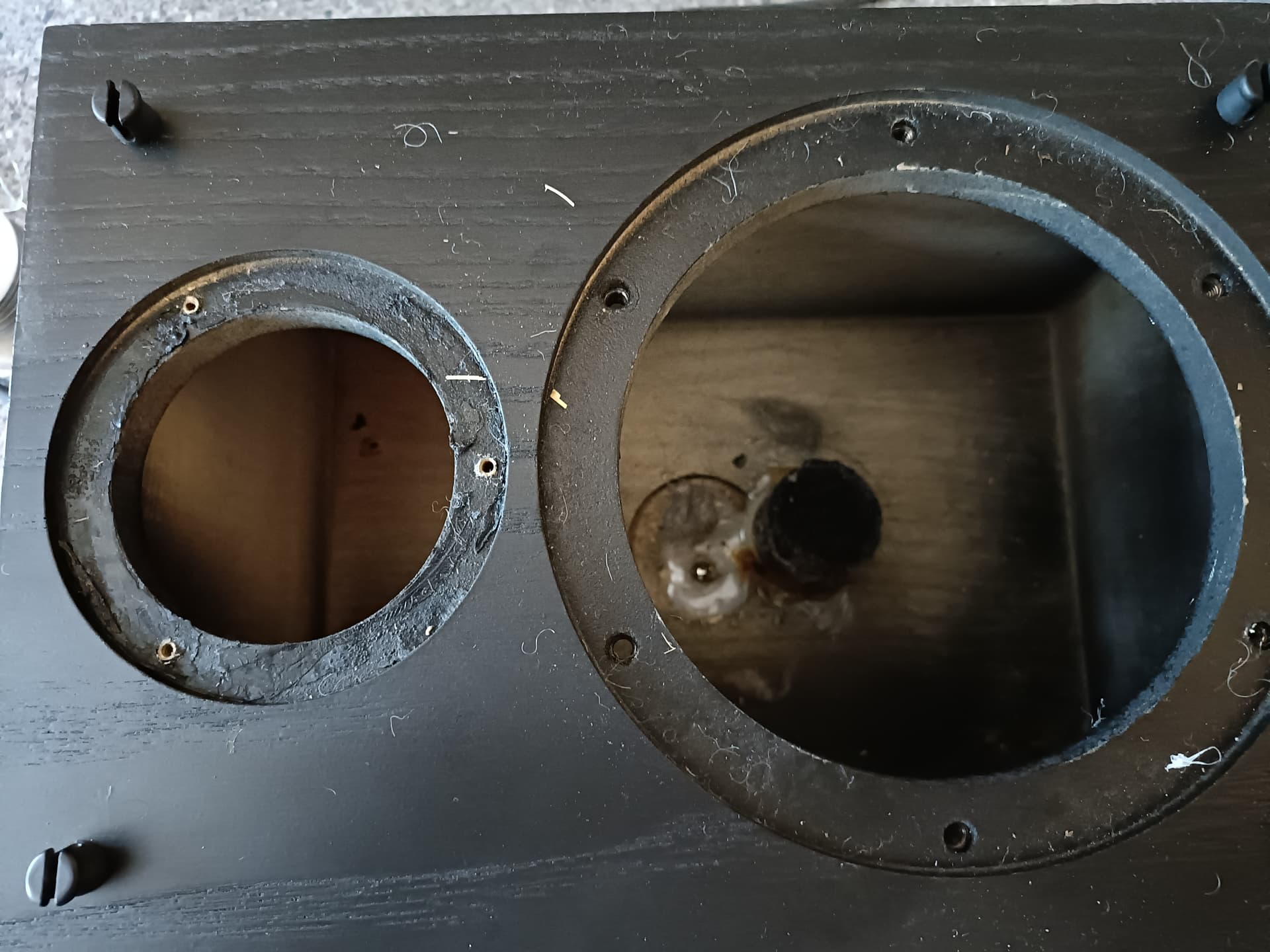

OK, I’ve gone in!

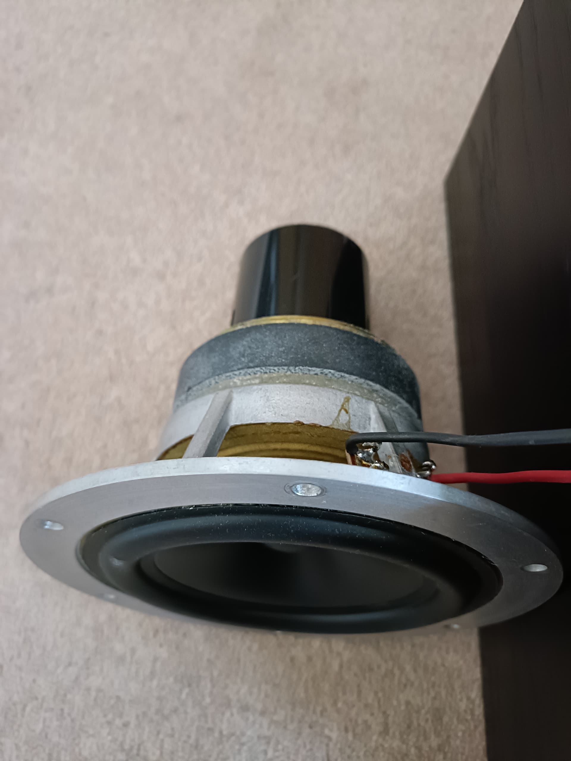

I’ve only opened one up at the moment and have removed the crossover and drive units. The bass unit removed easily and I was able to push the tweeter out from behind.

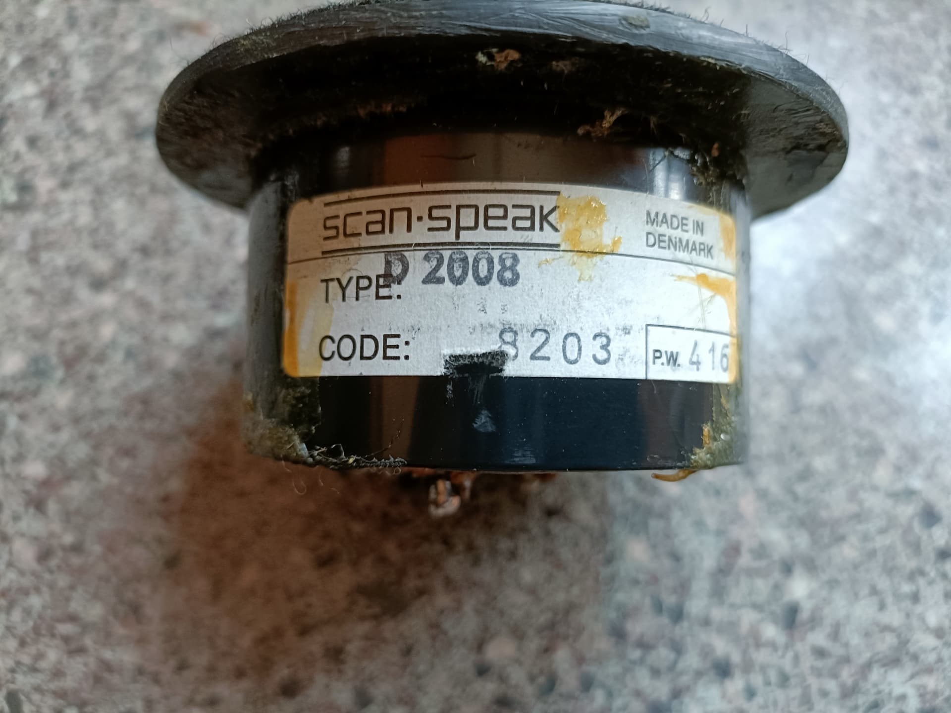

The tweeter is open circuit so I can assume it is toast. It is indeed a D2008. How can I tell if it’s the ferrofluid version? The answer to this could be academic as stock seems low and it could be hobsons choice.

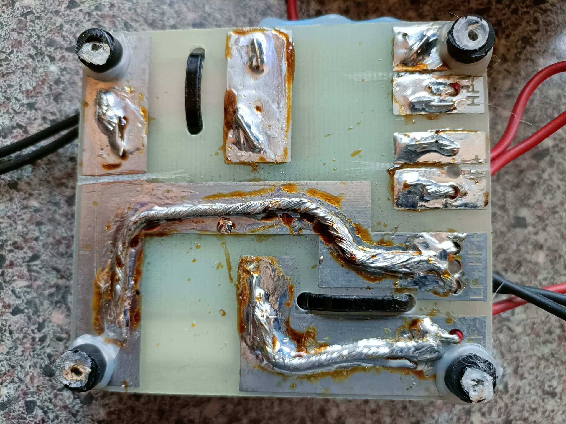

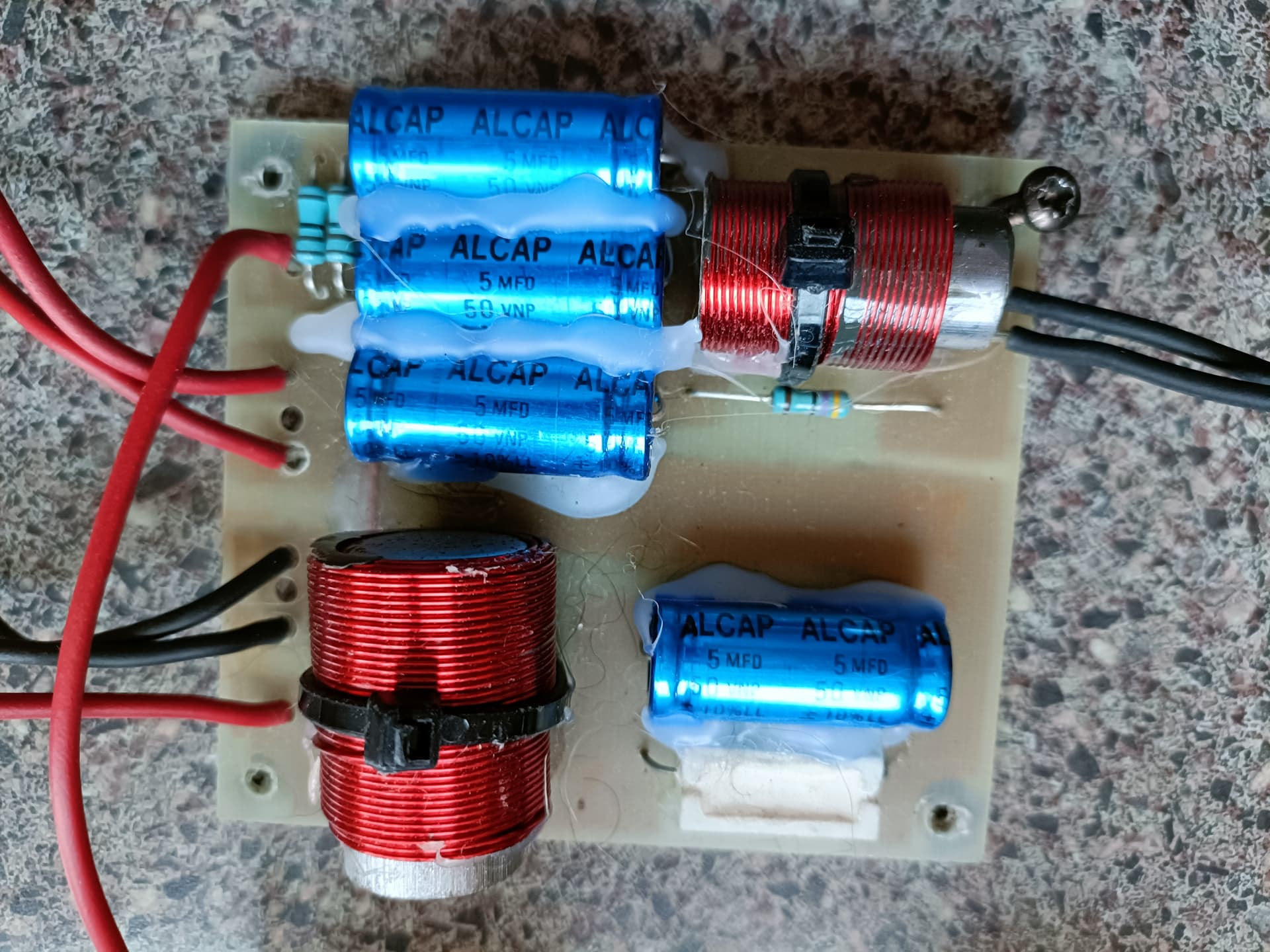

The concern is that if I replace the tweeters will they go again. i.e. how can I establish if the crossover is OK or not? There’s no leakage on the capacitors but concious of their age.
As an aside, it’s interesting that the tube on the back of the bass unit fits over the very small port on the rear of the cabinet.
Are they more than 15 years old…? Yes. Replace them. They degrade with time.

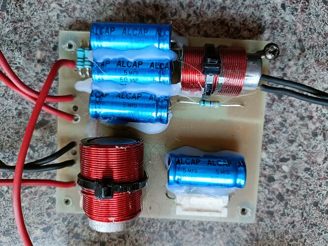

Looks like there are 4 identical capacitors (marked as 5 MFD) in each Crossover…? So just get 8 of the closest modern equivalent you can find - and solder them in, noting the correct polarity.
35 years old! :grinning:
I think these capacitors are what is known as Bipolar meaning continuity isn’t an issue. I can’t see a marking for polarity on these.

I would expect them to be Electrolytic, and so they will be polarised. See below -
PS. Looks like a near identical Capacitor can be obtained, with the same brand on it… :slightly_smiling_face:
Cost < £5-00 each…!!
Those look like early D2008s and they are without ferrofluid. The closest version of this that you should still be able to source is the D2008/851100, which is what you should look out for. Main difference is that the dome on the 8203 was doped IIRC (I seem to recall Linn used this on the isobarik). There’s also what appears to be a foam or felt ring on the front. You might want to try to salvage those so they can be reused. Failing that, I wonder whether there’s anything similar out there, or even some NOS items?

The felt was added by John as he felt it improved dispersal. I think they would be easy to remove, the glue doesn’t seem to be as effective as it once was.
I would imagine, with music being AC, that polarity wouldn’t matter in this case?
Of course different in the case of DC.
Maybe, but if I was doing it I would try to get the polarity as per the originals… :crazy_face:
YMMV, as always… :expressionless:
PS. Looks like the originals are well stuck in, using Silicone RTV (?). Hope you can prise them free.
The Wiki article you helpfully posted does mention Bipolar electrolytic capacitors. Looking into this more I think all crossover capacitors are Bipolar?
I’ve always assumed they had polarity but apparently not.
I think I need to remove one and send a picture to a knowledgeable supplier, probably the same one I get the tweeters from, if I decide to do a repair now.
I’ve got him to look, the PCB is one of John’s, the tweeter not ferrofluid. Caps not electrolytic. He asks if one might have gone s/c with age and put a full load across the tweeter?
Cricklewood Audio have Alcap bipolars, compared to the cost of the tweeter it might be just as easy to replace them all.
