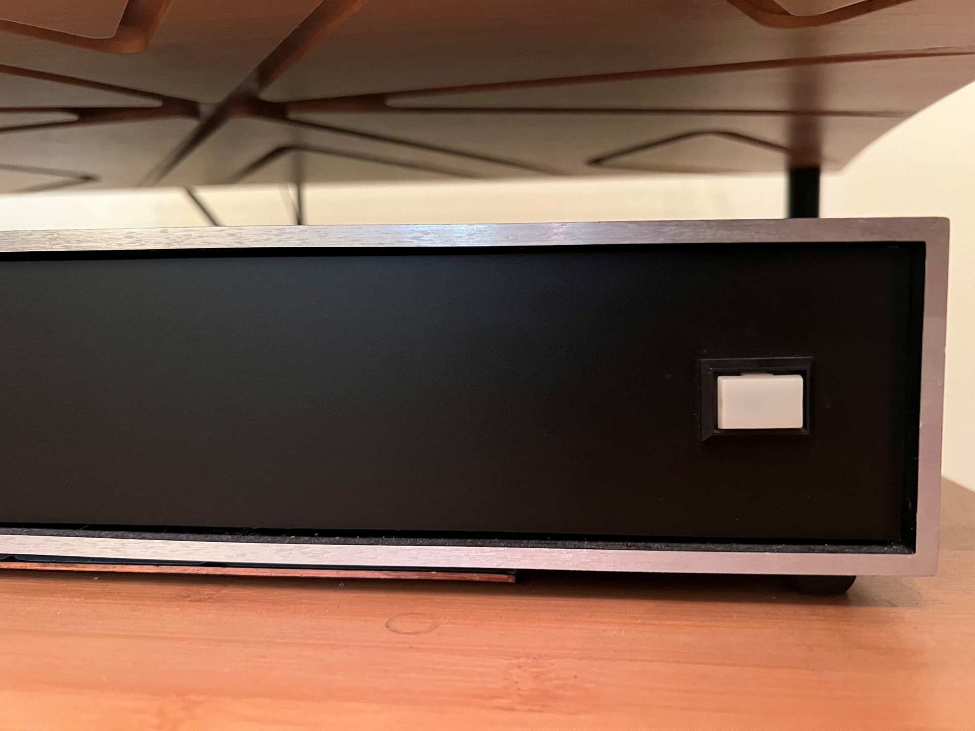

Not the most existing post but this is the lens.
I think it must actually be an orange lamp inside but luckily this failed after a few months.
The 32.5/Hicap/250 is sensational with viny rock and the fact you can keep it singing after 40 years is wonderful.
Probably sounds better without a working lamp as well.
204-681 is shown as being 28v. Do you add a resistor to cope with the 40v rail in the CB160?
It is missing the green cap that clips over the white diffuser.
