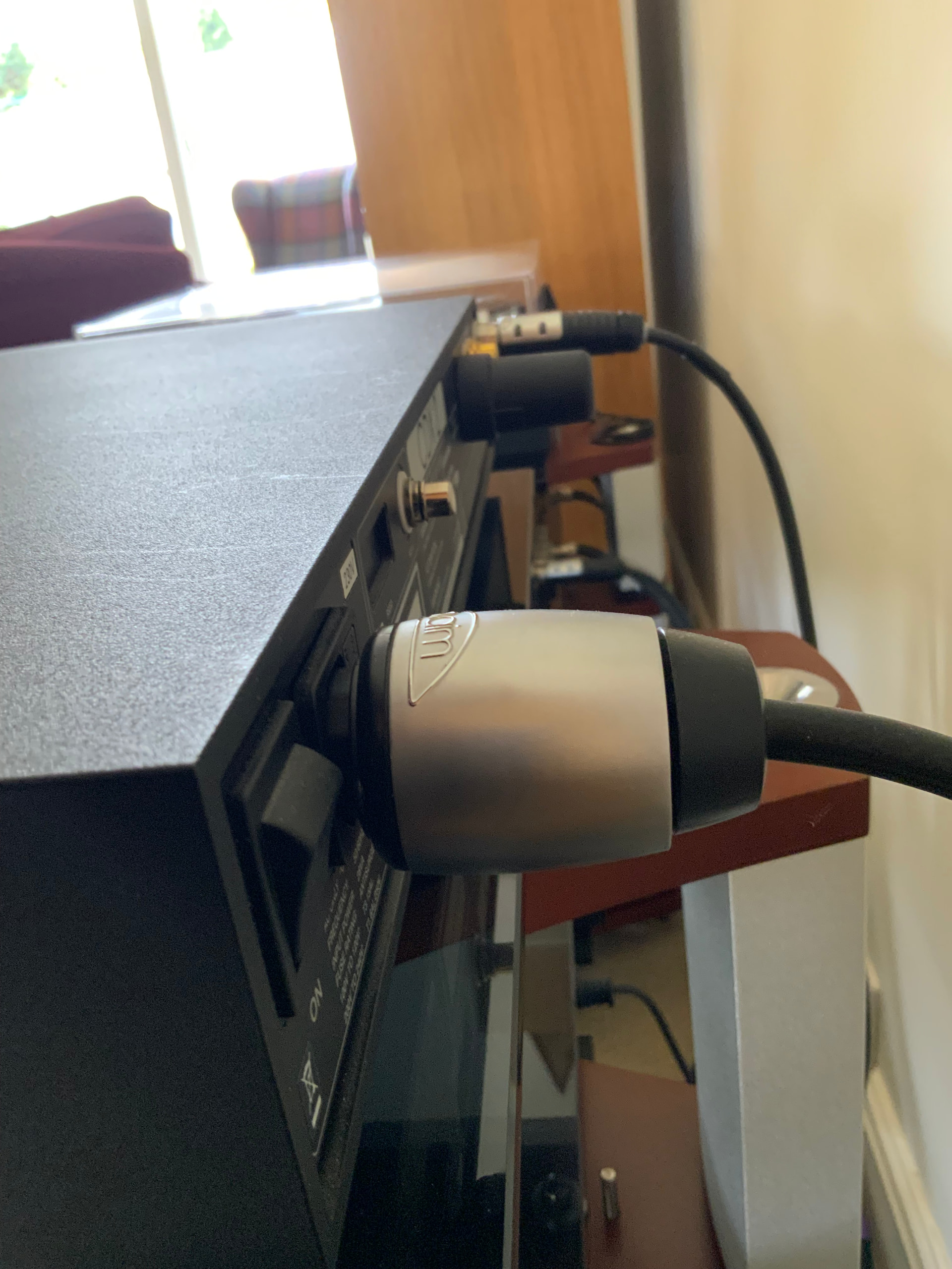

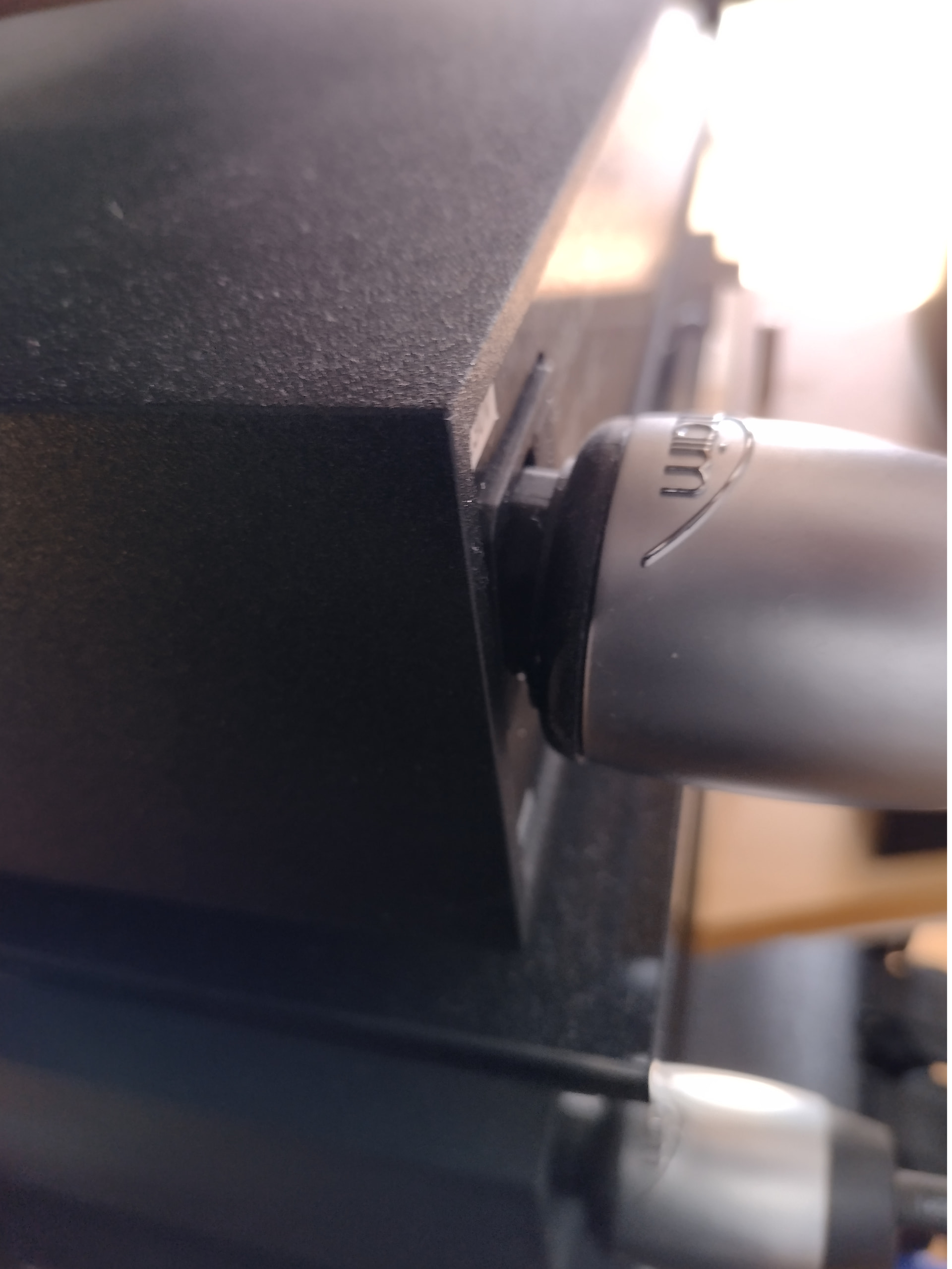

Any views on why and how you can get the powerlines to fit into the 555 P.S. I suffer from some that push well in and others than don’t, see pics. Solutions/views welcomed. cheers all
Some Powerlines seem to fit more easily than others, but they should all end up inserted to the same extent. The key is to hold the plug only by the silver part, and then push it in with steady force. When I had a Fraim I would brace the front with my knee. It’s much easier to build as you go, to give good access to the back of the boxes.

The Jaws in the Powerline are super tight (to the maximum allowed) for best connection so you do need to push beyond the initial resistance to get them to open up onto the iec pins.
It’s all about having a gap between the rubber collar and the silver metal shroud. No gap is bad. Gravity plays its part here so that the gap around my Powerlines is uneven due to the downward drag of the cable itself.

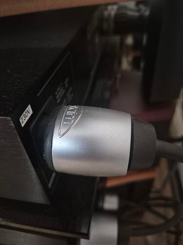

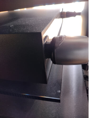

Here’s a pic with properly installed PL
David

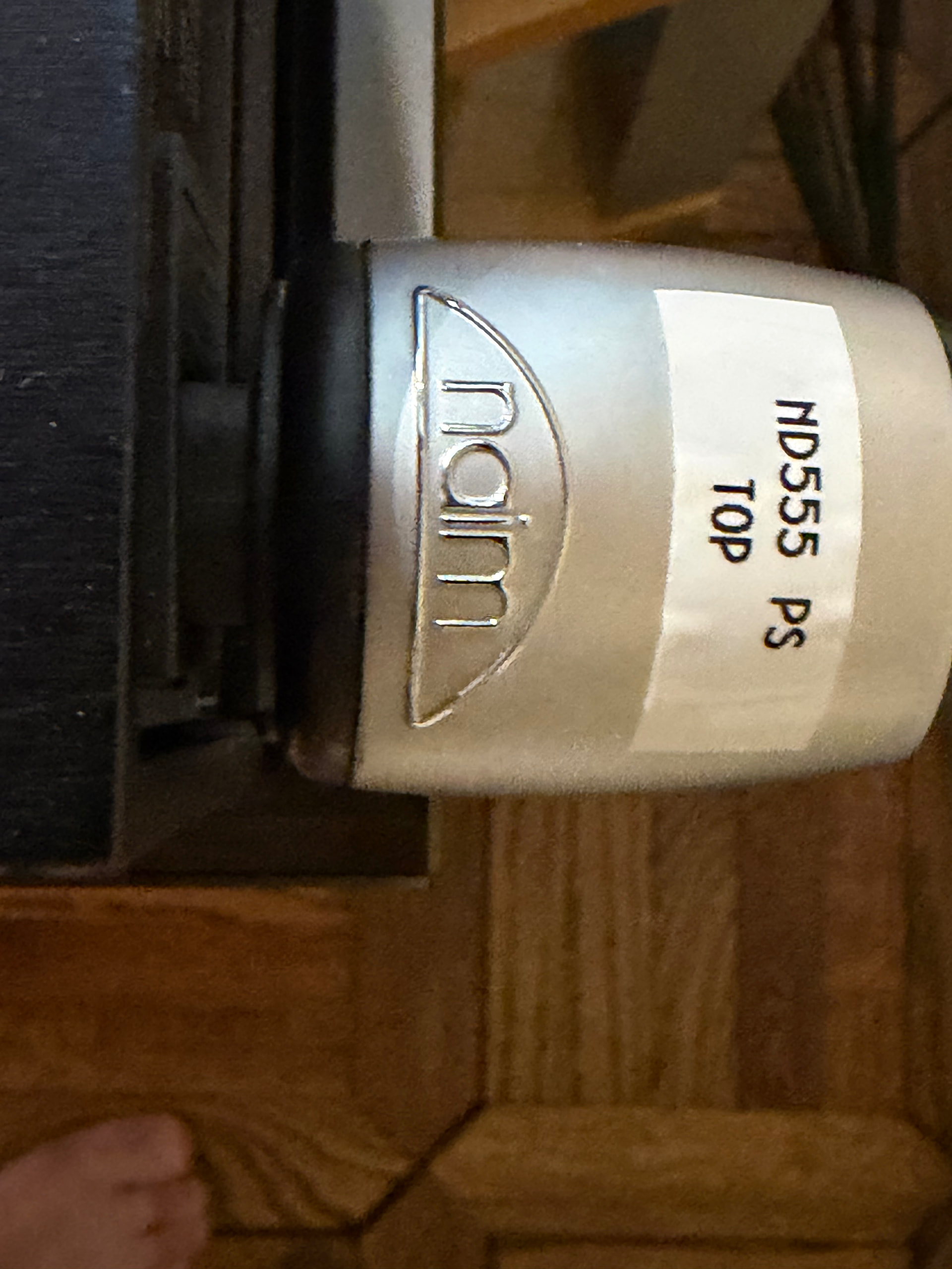

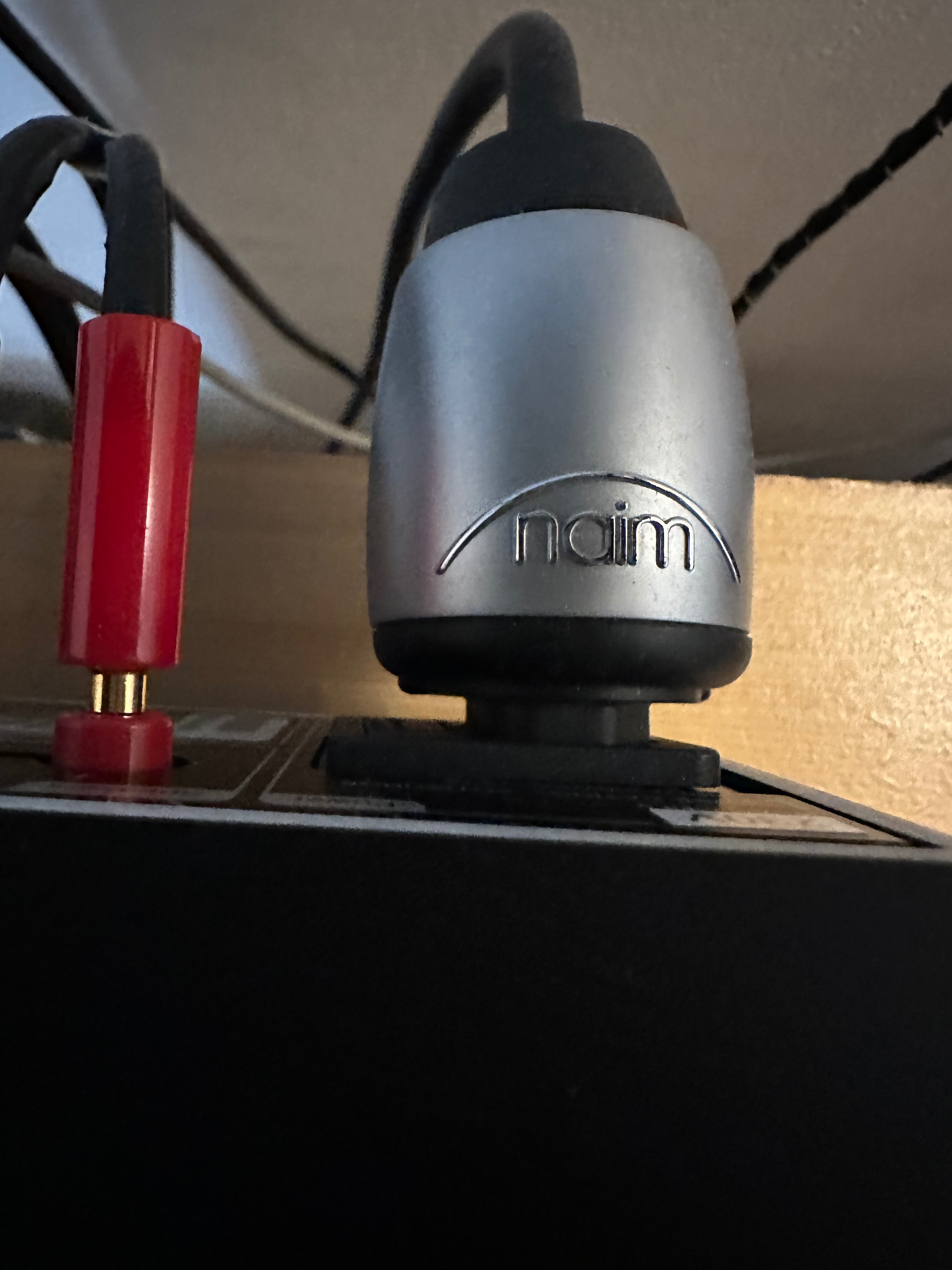

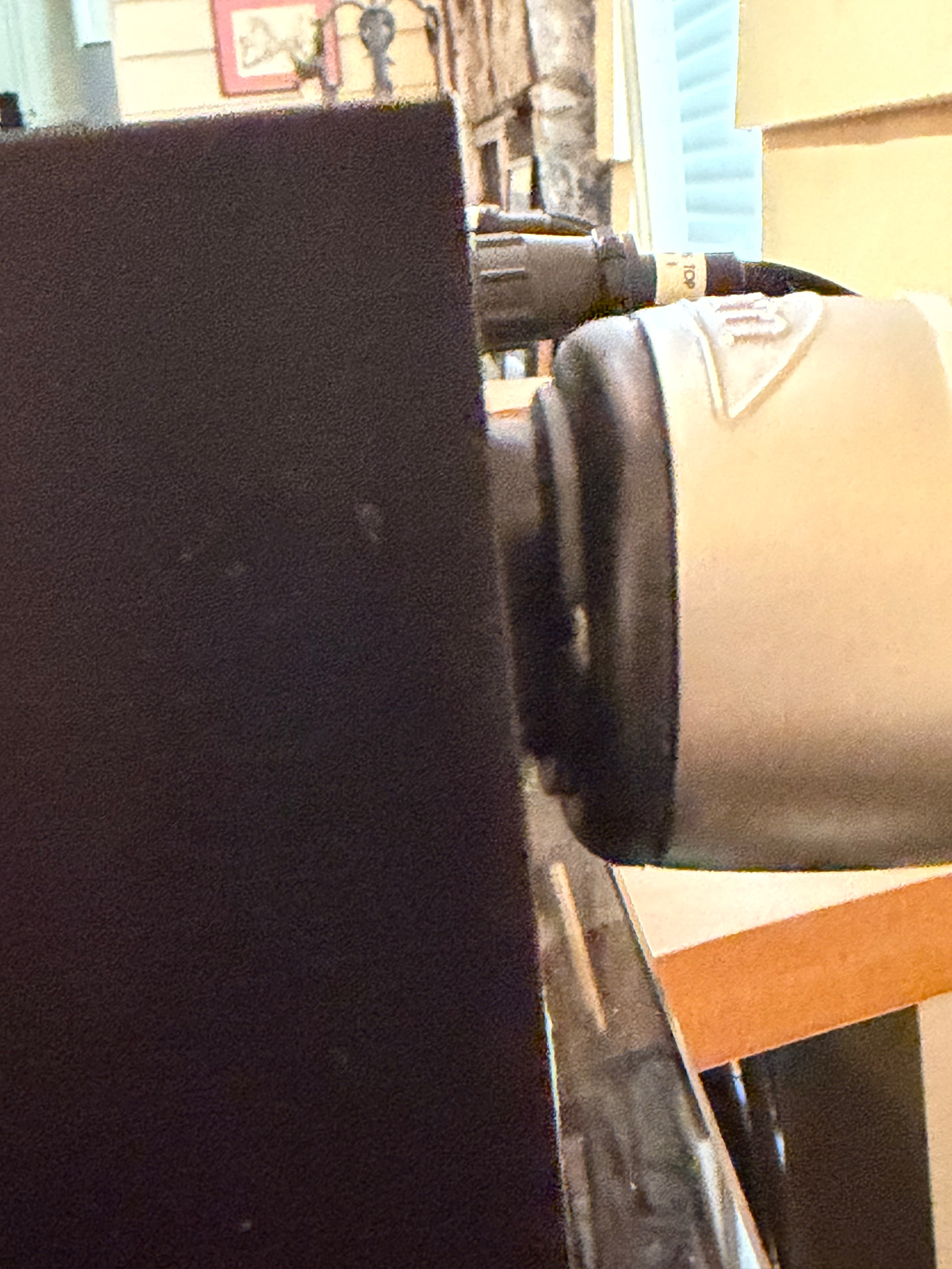

Same here. And I’ve had like 5. They should have 2-3mm left when fully inserted. To me all pictures here look ok except maybe the first post and right picture which might need a push.

Dear all, many thanks for your contributions and photos, a job for this weekend I think. cheers all
