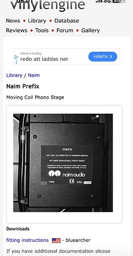

Connected directly to Nac 52 input 2 b or via Hicap and a 4 to 5 pin din from Hicap to the Nac 52. You can download fitting instructions here.

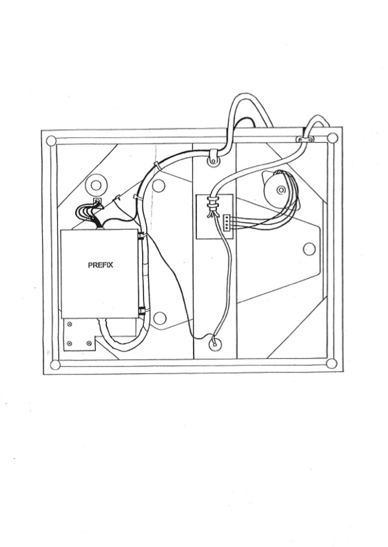

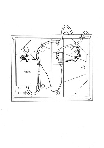

Here you go…
Thank you, Richard. With my dexterity, I would be off to a specialist. Great resourcing by the way.
