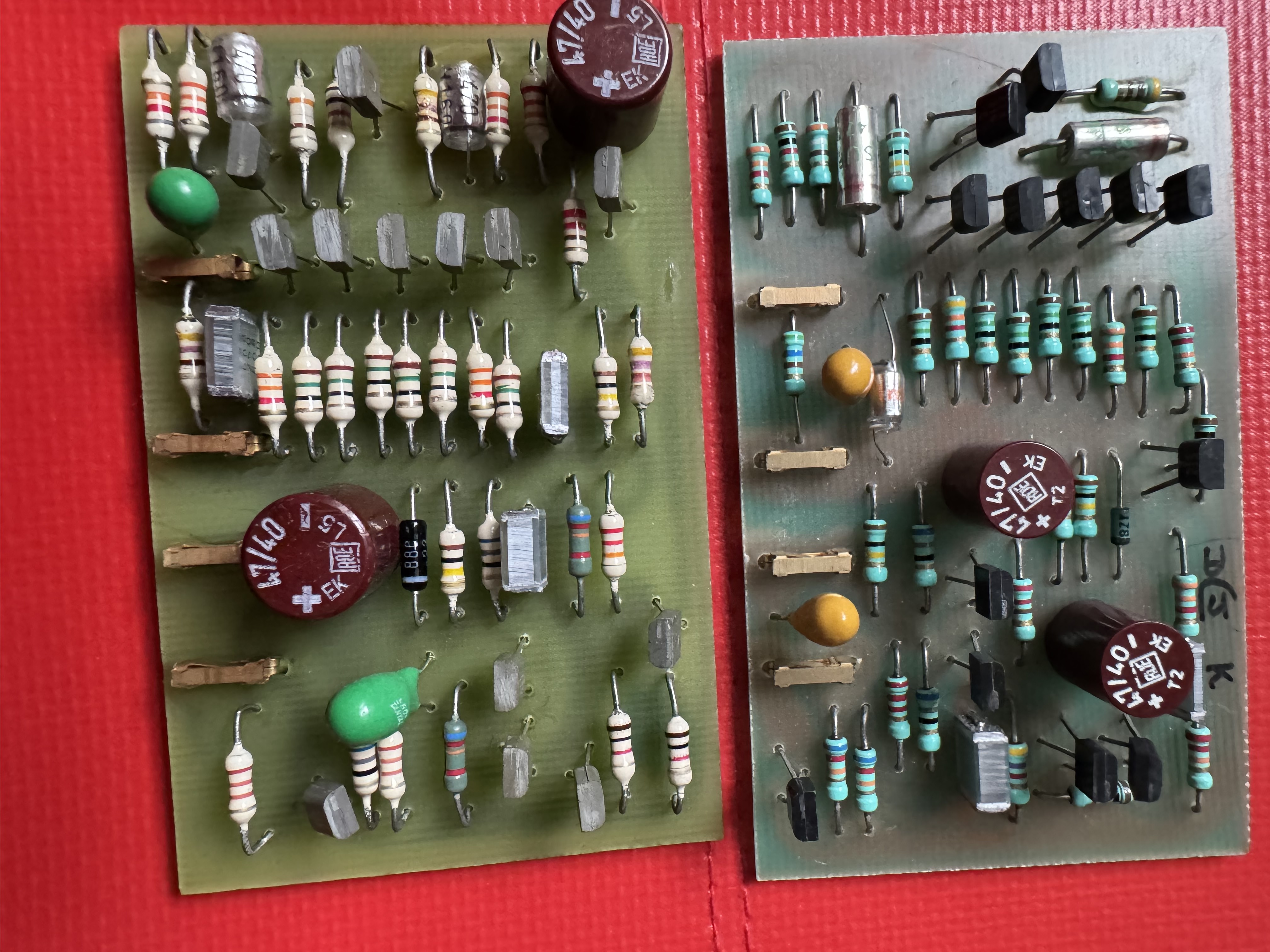

I tried to do that actually but I’m not really sure about my different cards and how valid the test was. I have a confirmed 323/3 K set (which I prefer!) and a 323/2 set I think is ’S’ but I’m not sure. So there is both the difference in issues of 323 boards and the unconfirmed S. Here’s a picture, maybe someone can tell if the issue2 board is ’S’ or ’K’?

They both look like S Cards

What? Actually I just googled resistor color codes and thought I just confirmed the one marked K is K 560ohm and the other unmarked was S 470ohm?

They both look like they have 470s to me.
The Left one is S
The Right one is K

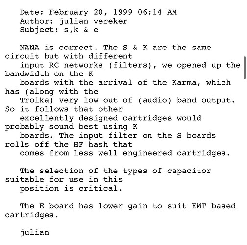

Since this thread might help someone else too sooner or later I want to share the quote from Julian Vereker about the s, k & e phono boards.
Nice to know that my K17D3 Karat is less well engineered than those “Other” cartridges :joy:

I wanted to ask that, why you did change from K to S with the Cartridge swap. Did you get the chance to hear the difference?
Maybe you actually would be better off using the K, on the basis that filters are more important than loading. Or is it Dynavectors have need for roll off?
It’s was Class A that did the conversion when I swapped my Troika for the DV cartridge. I always understood it was because the DV had a higher output and therefore needed an S Prefix. All this stuff about engineering quality is new to me.
Ed: Just google output and looks like Troika is 100uv and DV is 0.3mv
