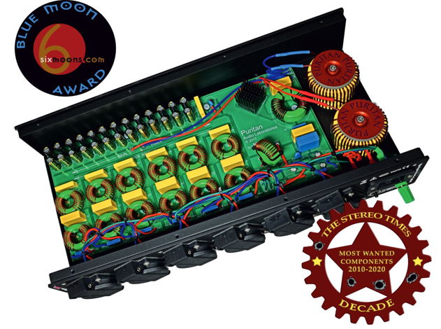

Is that the mains “purifier” thing? If so, I read somewhere that it could inject ultrasonic noise, which if it does potentially could be causing the amp to work even when no hifi input signal. I’ve no idea how likely, but I guess it would be a fault condition if if does happen.

I will add I’m not a fan of all of the coils and other bits inside the Puritan unit.

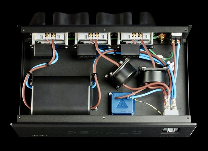

I’ve used Shunyata Research products for years with excellent results. The unit doesn’t get warm I’ve never had any components get overly warm unless they are supposed to. And the improvements in sound quality are unmistakable. I currently use a Denali S6000 v.2 with a Shunyata Alpha XC v.2 power cord to the wall.
