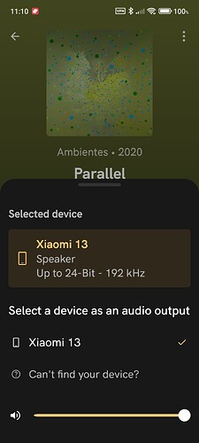

So, yesterday I was streaming from the Qobuz app but today, Qobuz cannot “see” my streamer. The NAIM app is playing “from” Qobuz.
I’ve searched settings and “Help” pages but can’t discover anything.
What am I missing?

Do you normally use an active vpn connection?
Yes. I thought that might be it so I disabled it. After a while, Qobuz “saw” my streamer. I then toggled the VPN on again and it’s still OK.

Turns out, it’s the VPN. D’oh

Thanks Robert. I was experiencing the same issue, so adjusted my VPNs after your suggestion and Qobuz Connect fired up for the first time immediately. It’s bullet proof now. Good on you.![]()
Oh gawd. Back to QC not finding my streamer again. VPN off.
