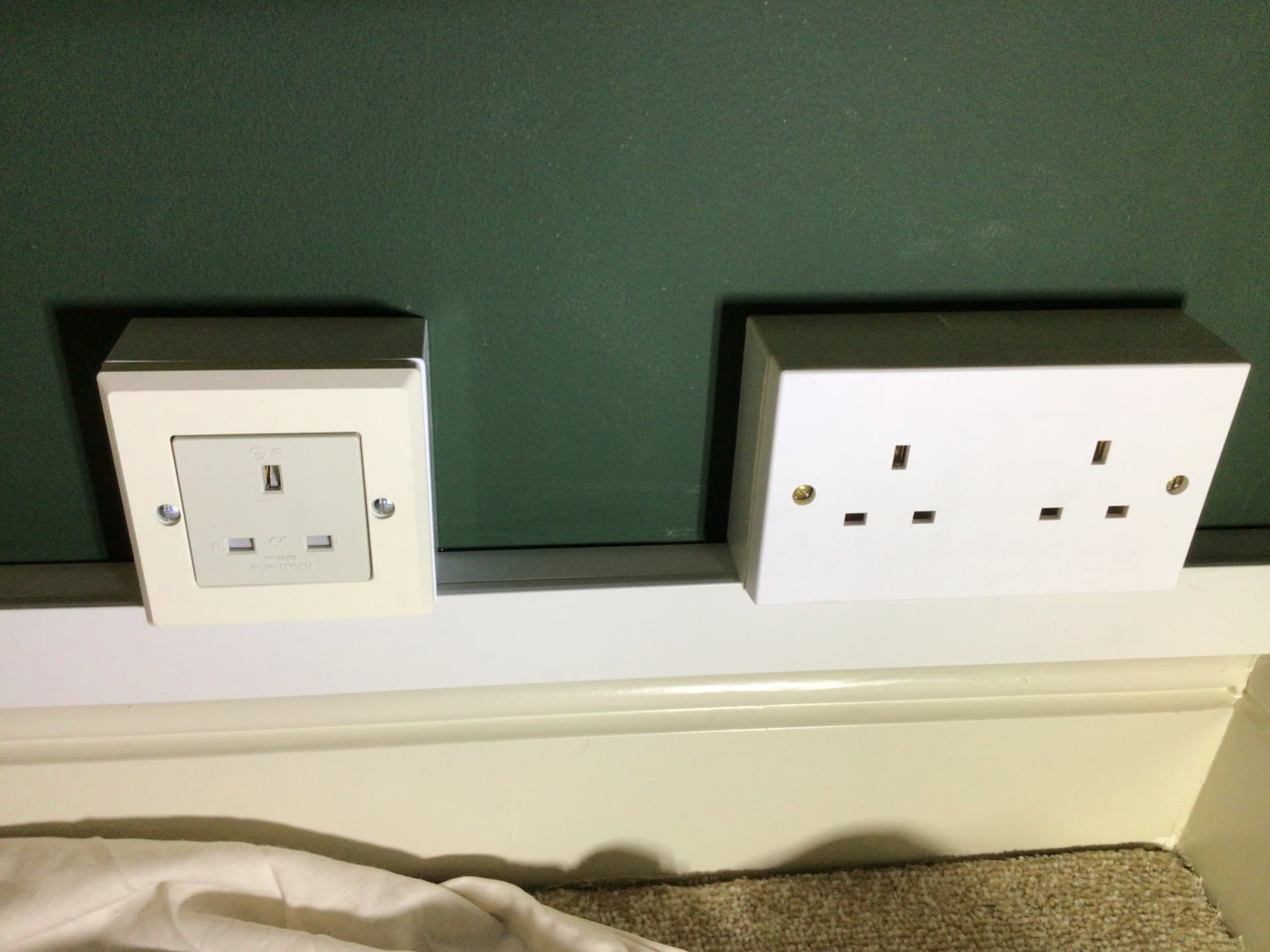

We have this product in Australia, where cables can be run on the surface of a wall, and there are many adapters for right-angle joints and others. It does blend in, and there are power outlets and mounting blocks to suit this ductwork. This may be an option. Below is an example.

@Gigantor suggestion might be worth considering, or perhaps a version of it. E.g. somehow running the cable around the skirting board, or possibly even taking the skirting board off and replacing it with something that perhaps is taller that you have (to preserve the wall decorating) but with a channel to run a cable behind it. A photo of your room might help here. Apologies if we are all bombarding you with ideas - hope it isn’t bothering you

You can get both dado rail and skirting that are designed to act as cable or pipe ducting, and cables can either be led out, or sockets are available that fit into them. But more chunky than most wooden varieties.

Below is a pick of aluminium duct that can be run as a skirting board, just for your information.

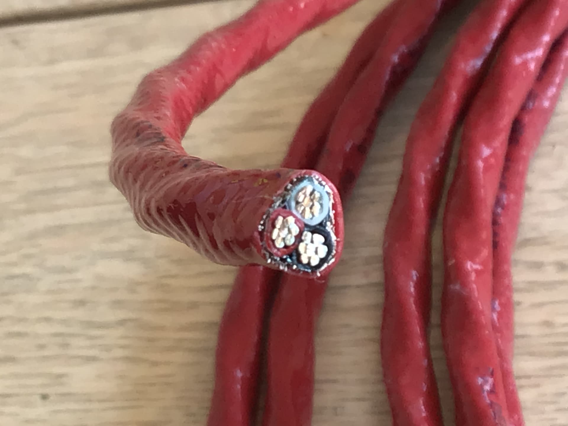

It’s the old question of whether anything can improve what comes before, or just compromise it less. I’ve never got into fancy sockets, and have the same old Crabtree socket that was fitted about 25 years ago. Naim advised me to get 10mm2 and I’m glad I did. Maybe you could get the sockets on your Furutech drilled out to take 10mm2.
Like this.
DG…
I used 10mm Lapp cable and a thinner Belden cable with one Furutech socket and one other good socket with very good measurements and sonic results:
