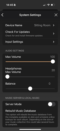

Go to system settings and choose check for updates.
Then delete all your radio favourites and choose new ones from the iRadio search. It will then work fine.
