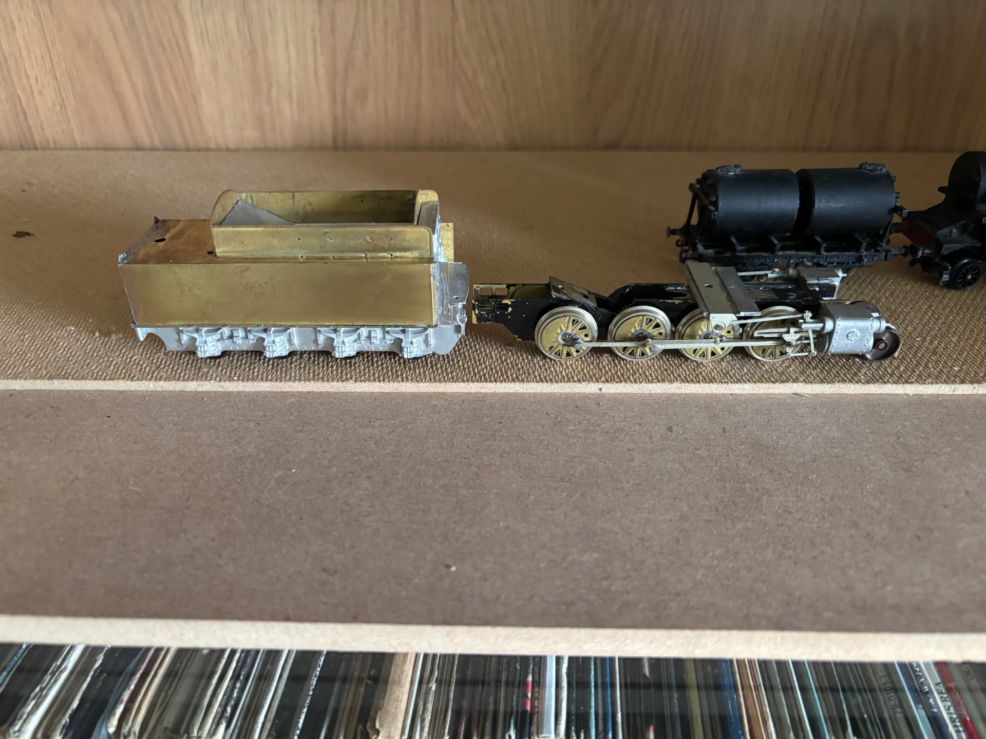

I think Paul’s pictures are the best encouragement but here goes.

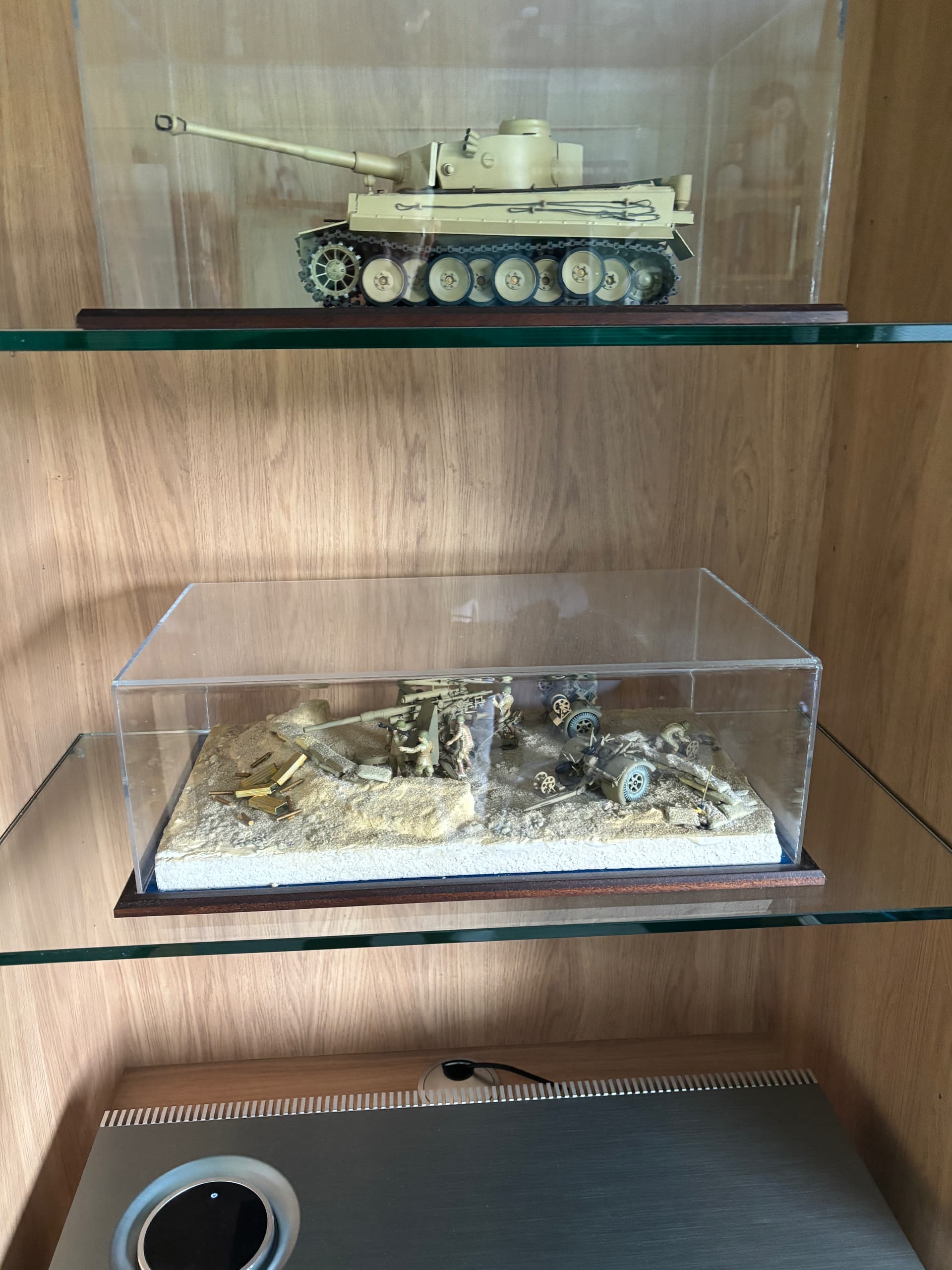

I’ve done some modelling in the past, all plastic pretty much as per the first pic, including some of the old Kitmaster locos, but always wanted to move on to trains, just never had the opportunity.
Recently I’ve been laid up quite a bit so thought I’d give it a go - so a a few thoughts from a novice as well alongside the pics (apologies if I seem to be teaching anyone to suck eggs, this is purely for absolute beginners, as the song goes).
Something I found hard was not having a dedicated workshop/workspace - in the end I reorganised a lot of cupboards and scrounged some trays so that I could leave parts and the model spread out and easily accessed. That meant it was easy to start a session so I was encouraged to keep going.
I spent what seemed like hours going through instructions and trying to identify parts - much harder than I expected, especially as the DJH kit I have has (I now realise) parts for a 2-10-0 as well as a 2-8-0. No idea why but eventually I marked up all the parts I could identify and left the rest for later.
I had already done some soldering (car electrics, naim speaker leads etc) so had the basics. Beyond that I didn’t need to buy much - I suspect most diy types will have most of what they needed - but I did buy a decent reamer and the smallest Xuron cutters I could find as I found that when removing the smaller etched brass parts with a knife
I was in danger of bending things.
My approach was to assemble a set of parts, spend a while cleaning them up and do as much dry assembly as I could - gradually found I could make sense of the instructions and small bits that way. Then I had a session soldering a much as I could before I ran out of time.
Biggest mistake - don’t follow the instructions to the letter. I did and you will see from the pictures the stage I’m at - but I should have realised that setting up wheels and valve gear before trying to add the brakes (and even the pickups) was not a good idea - far too difficult to hold or stabilise the chassis to add small parts now - so I’m now trying to visualise how it all goes together a bit better and do things in an order that looks easier to me. That did work better for the tender. Chances are my 2-8-0 will not have brakes!
Other thought - play some nice relaxing music, especially when trying to assemble valve gear.
But, overall (this is the encouragement bit) I think for anyone with a few DIY skills that likes locos it’s well worth having a go. As Paul said, it isn’t too expensive if you source kits secondhand and you can usually recover from most mistakes.
Hope that helps someone anyway.

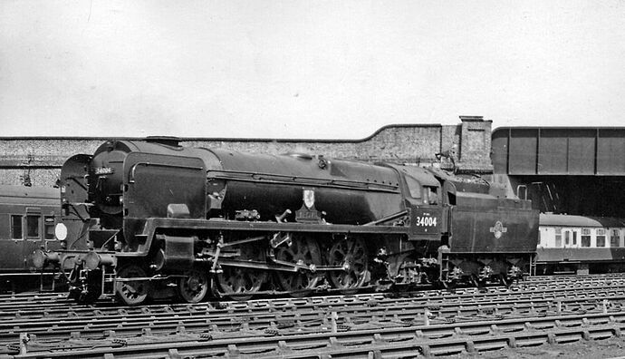

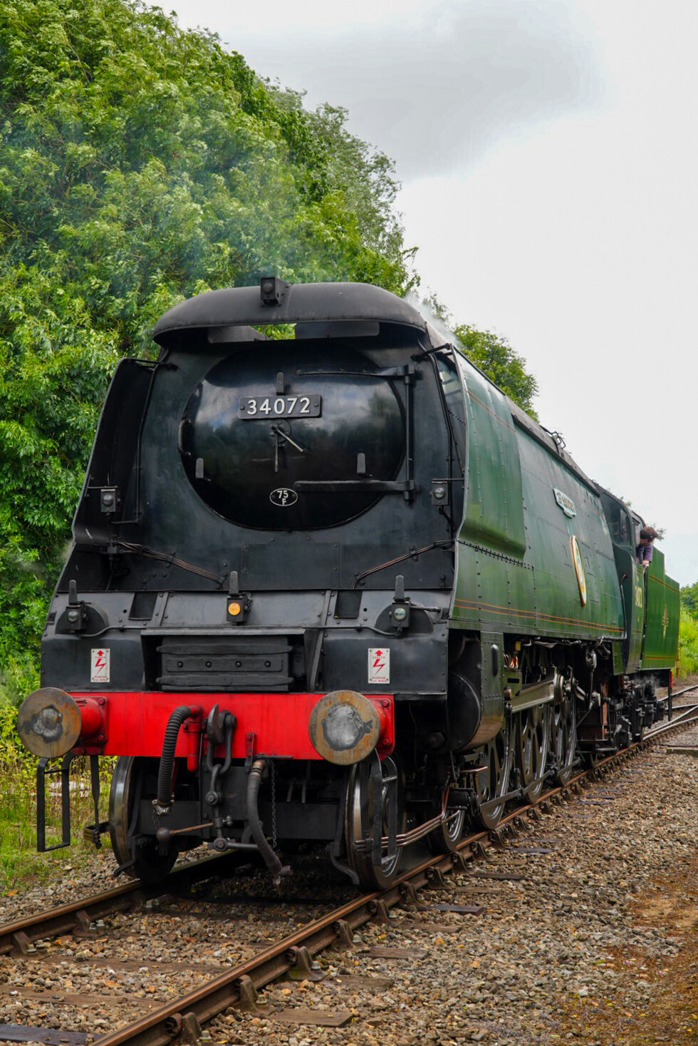

I don’t know if they are “the same” but seen this one and had the chance to travel with it as well.
Georgeous train I have to say.

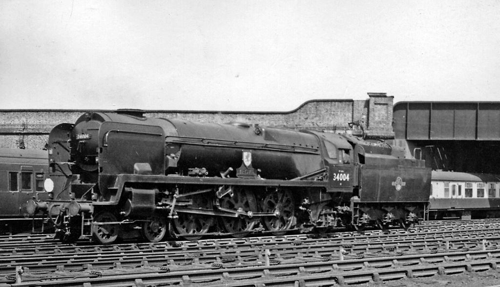

Same class, just rebuilt like the photo of 34004 Yoevil (copyright Ben Brooksbank)

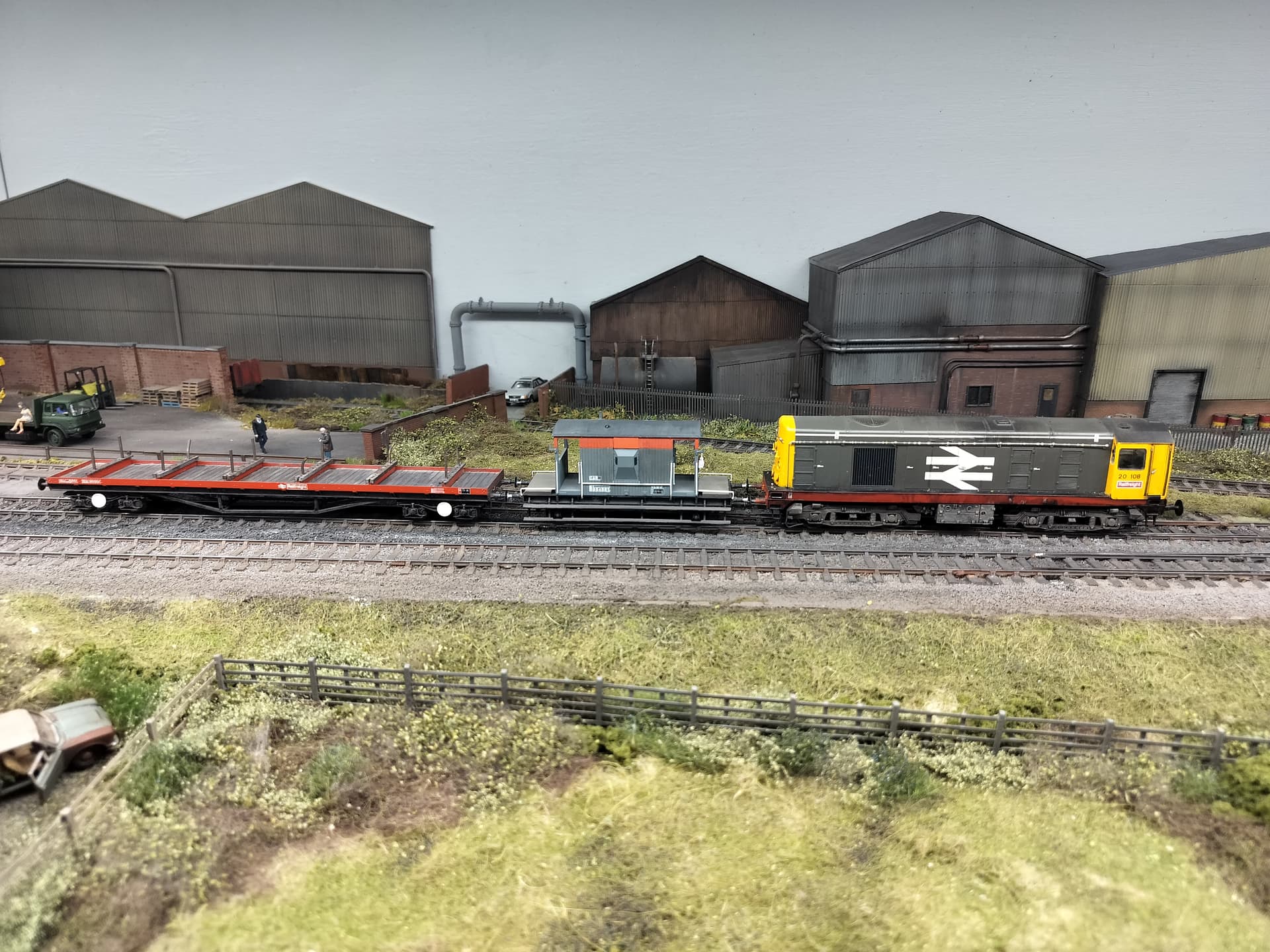

A few pictures from Scalefour Crewe today.
Fryers Lane

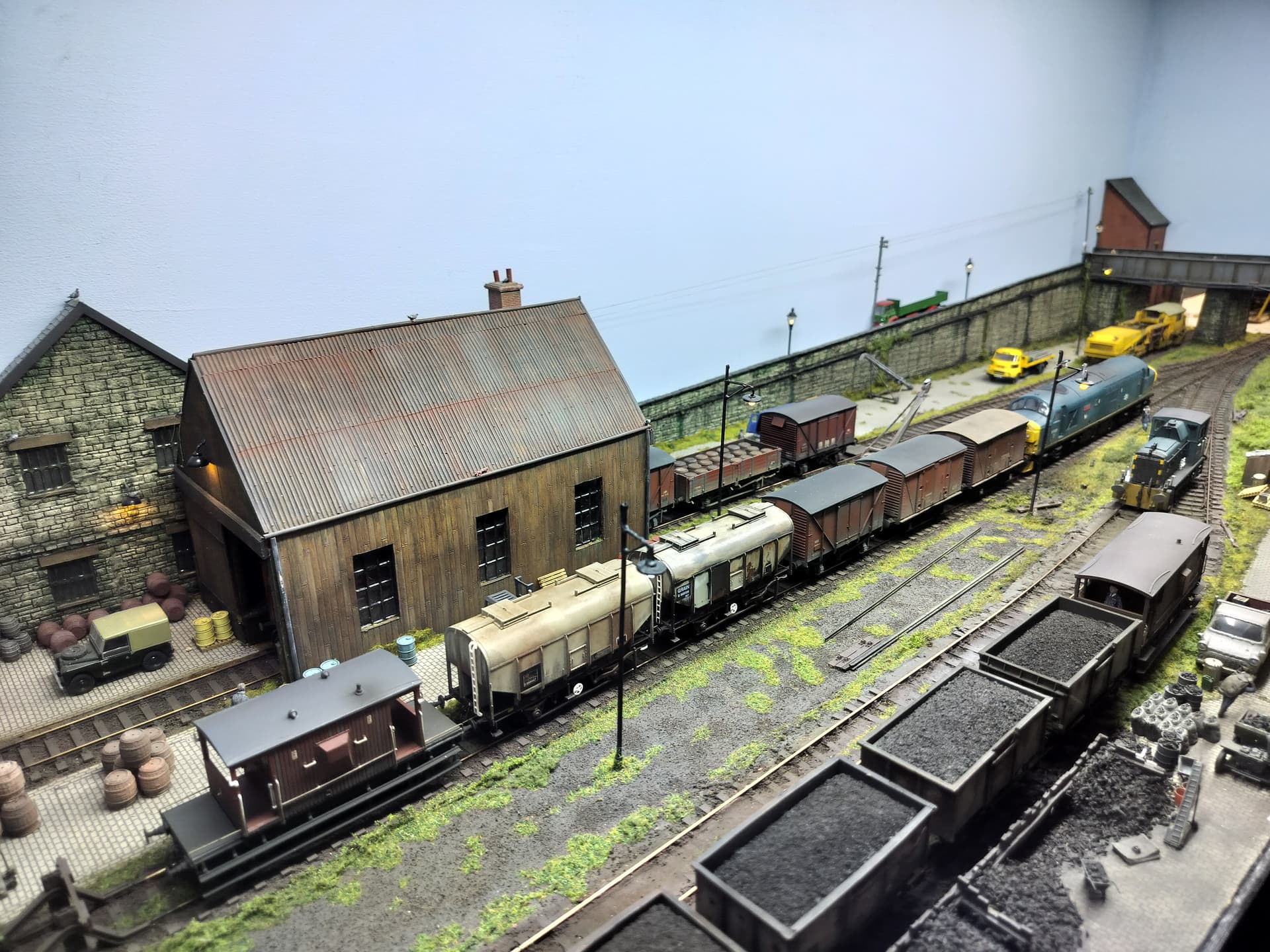

Underhill Yard

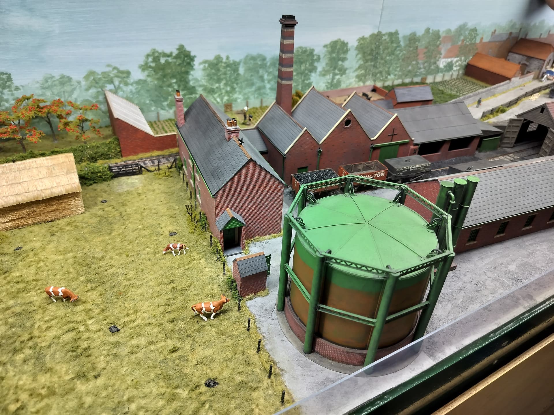

Wantage

The first 2 are my style of modelling, but better! Saw Wantage at York show. Very nicely done.
Thanks for posting.
Thanks for posting, looks like another excellent Scalefour Crewe, do like Underhill Yard.
