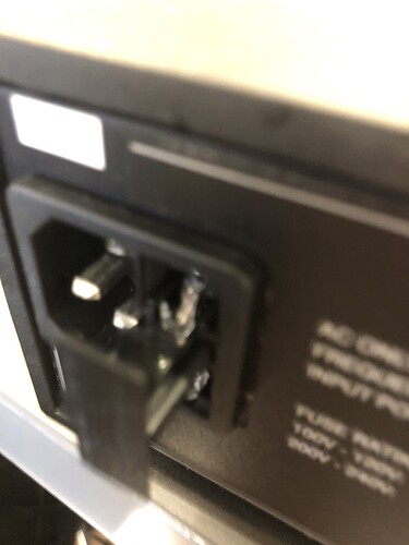

Hi there I’ve had a Naim 300 PS DR for about a month and fuse just blew. So much in fact that the glass had shattered. I saw a flash at the back. Have replaced a fuse on my XPSDR but when I opened the 300 panel the glass was totally smashed. Now in lockdown with no music :weary_face: does anyone know why the glass of the fuse would smash? Very concerning! Was connected with a Naim Powerline. Tried to carefully get the glass out but one of the metal ends of the fuse is somewhere inside. Gutted. Not sure if naim are doing repairs right now, or if my dealer is even open :frowning:
@Richard.Dane do you know? Thanks
It’s rare, but sometimes the force of the fuse failing can cause the glass to shatter. Do you have spare inside the holder?
The main cause of fuses blowing when using a Powerline is not having the power line connected all the way in. This can cause arcing which then leads to the fuse blowing, sometime catastrophically!
You need to push until the first major resistance - some stop there thinking it’s in, but it’s not, at least not properly. It then needs a much firmer push to open up the very tight jaws to make a proper grip on the pins. As you do so you’ll see the back part of the plug push backwards. Just be sure you are holding on to the front of the kit because otherwise the force needed will send it flying off the shelf. Also make sure you only handle the outer case of the IEC (i.e. don’t push from the back), otherwise the back end of the plug won’t push back and decouple properly.
If you can’t remove all of the fuse bits and you don’t have a spare handy then best first try contacting your dealer, otherwise give Naim support a call.

Thanks @Richard.Dane. Yes can’t see the bottom piece of the fuse, dealer has offered to send new fuses, but can’t see one of the small metal bits of the fuse that blew am concerned it may have got lodged inside somehow. I’ll call naim. Thanks for your help.
