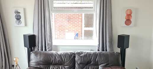

Hi All,
I have an odd issue where the rear channels stand out too much for my taste, if you’re sat in either the left or right seat it sounds like the majority of the sound is coming from the nearest rear speaker. Is there a way I can address this in Dirac calibration to widen the rear sound-stage somehow? Alternatively, would switching to bipole (not dipole) speakers like the Aria SR900 be a better solution for this than than monopole bookshelf speakers?
For context, in my 5.1.2 setup I used to have B&W M1 speakers on stands behind the couch as surround speakers which worked pretty well - it’s exactly what they are designed for but the setup was unbalanced with the front and center speakers being from the much the much larger B&W 700 series. I have swapped out the M1s for the B&W 607 bookshelf speakers to better match the B&S 706 fronts and put them on tall custom designed stands to get the right height. The AV Receiver I am using the AVR850 which I calibrate with Dirac Live. The sound is now nicely balanced all round in terms of in-room frequency response and ‘punch’ so I am happy with the upgrade but the sound from the rear speakers has become much more directional.

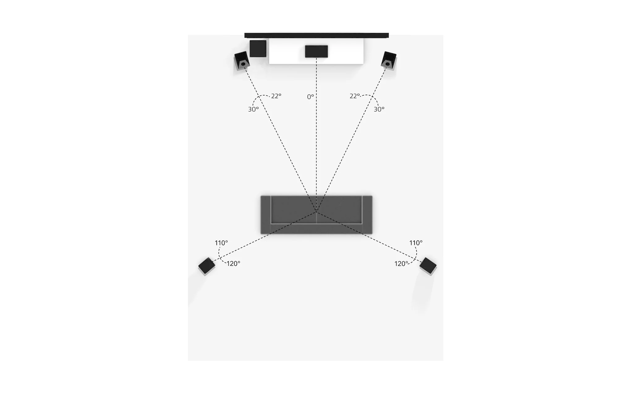

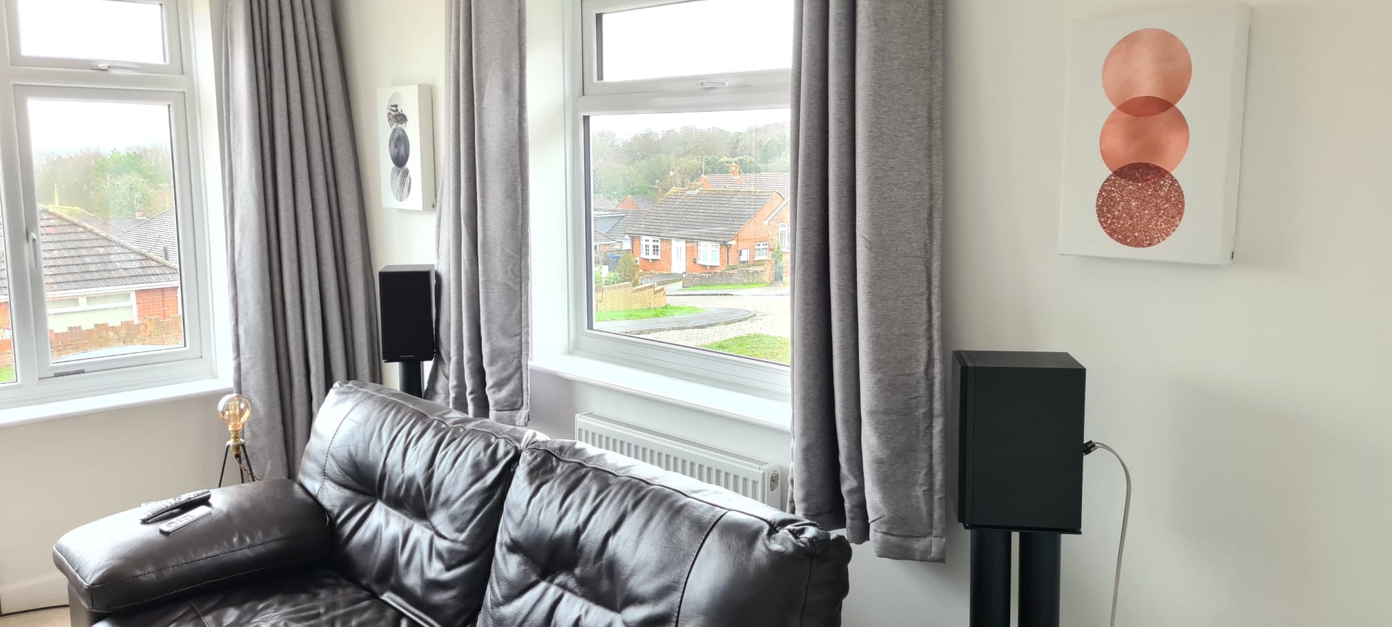

Layout:
I’ve tried moving the speakers out along the wall and back in as well as toeing in and out, currently orientated per the Dolby recommendation below for 5.1.2.

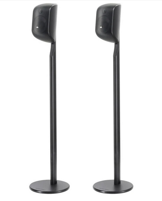

B&W M1

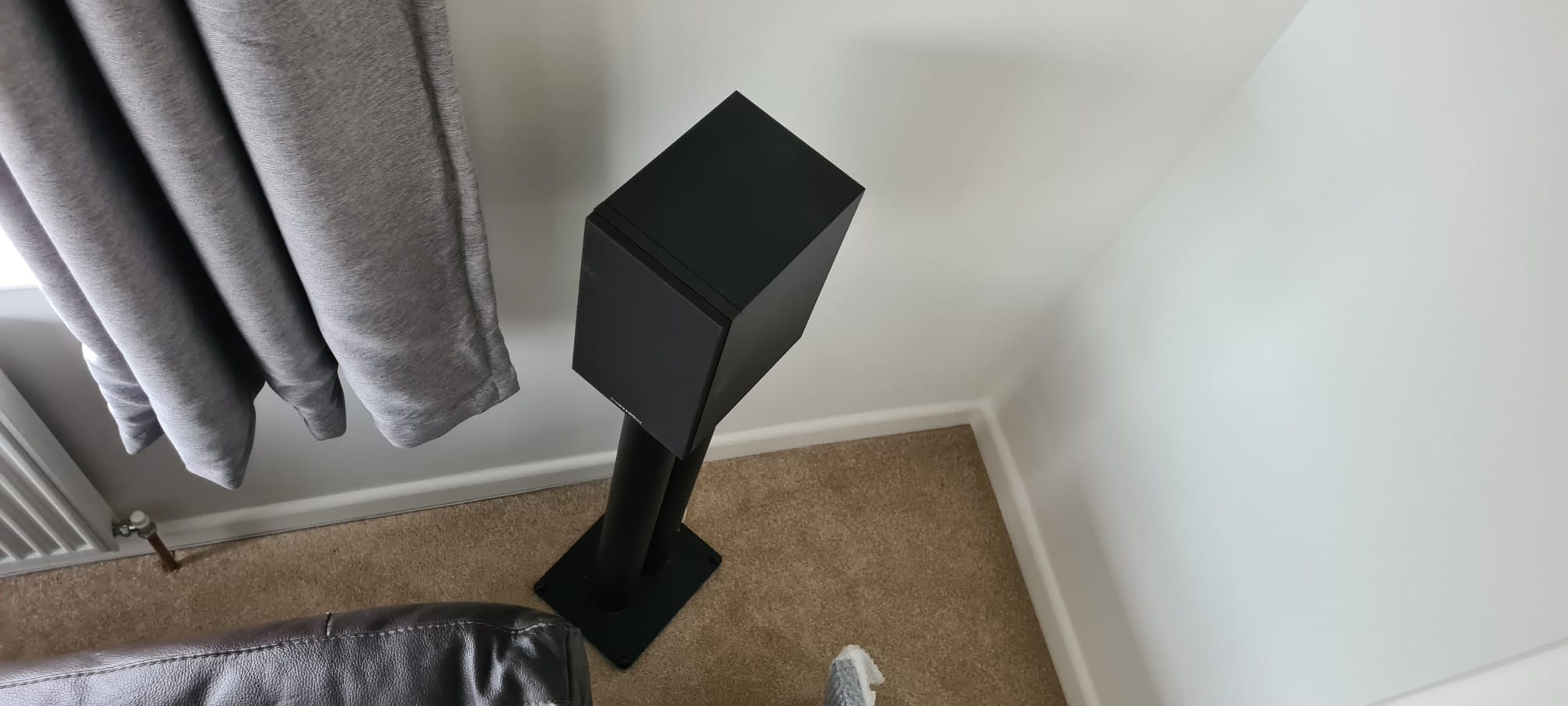

B&S 607 S2

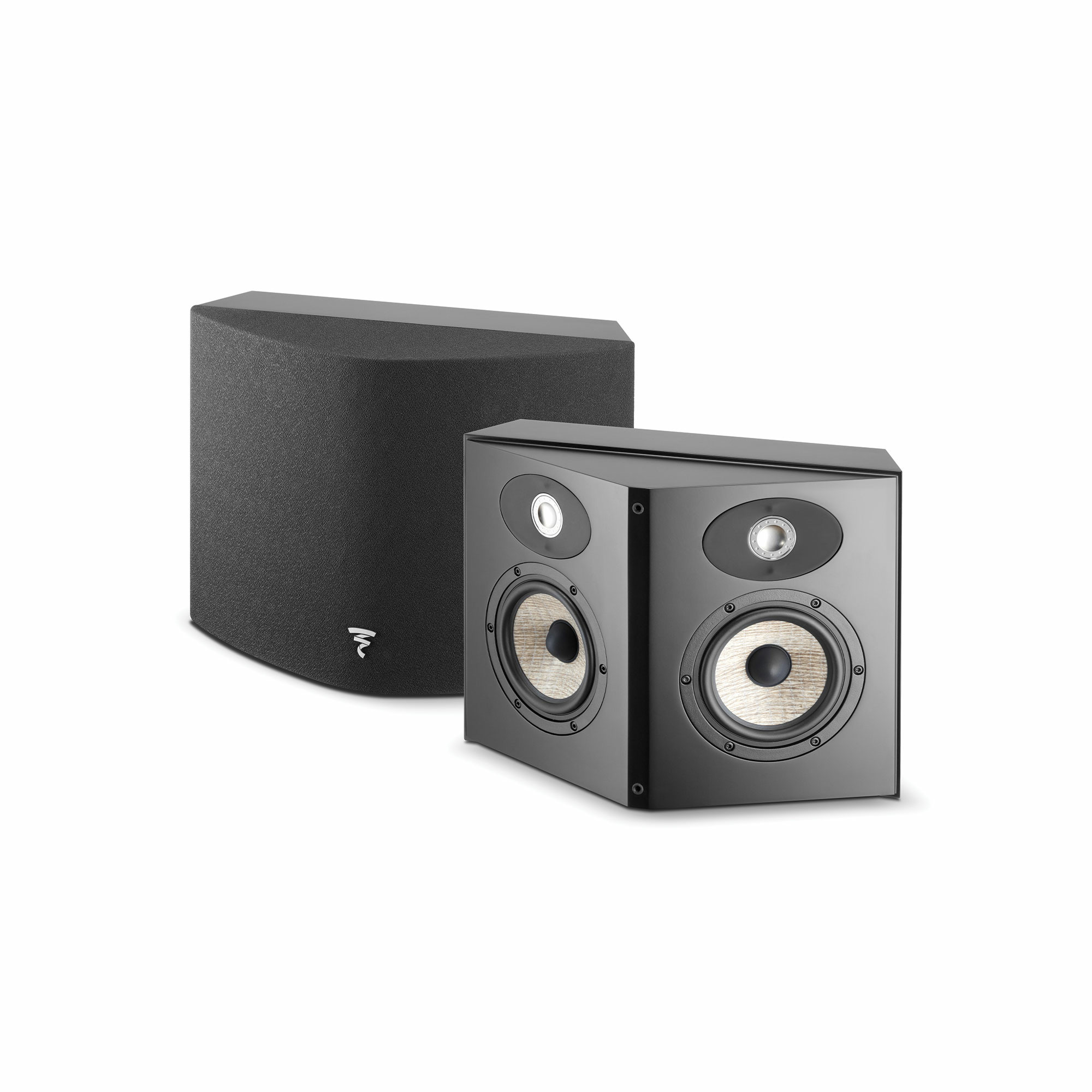

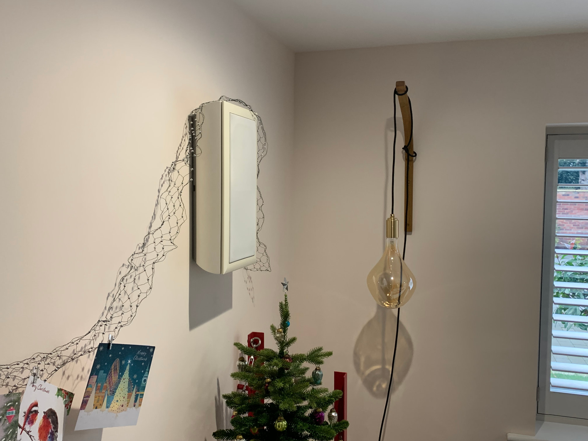

Aria SR900 (these would go roughly where the acoustic panels currently are on the wall)
As always, any advice much appreciated!

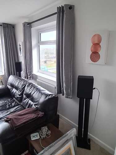

Is there space to move the speakers further away from the sofa?

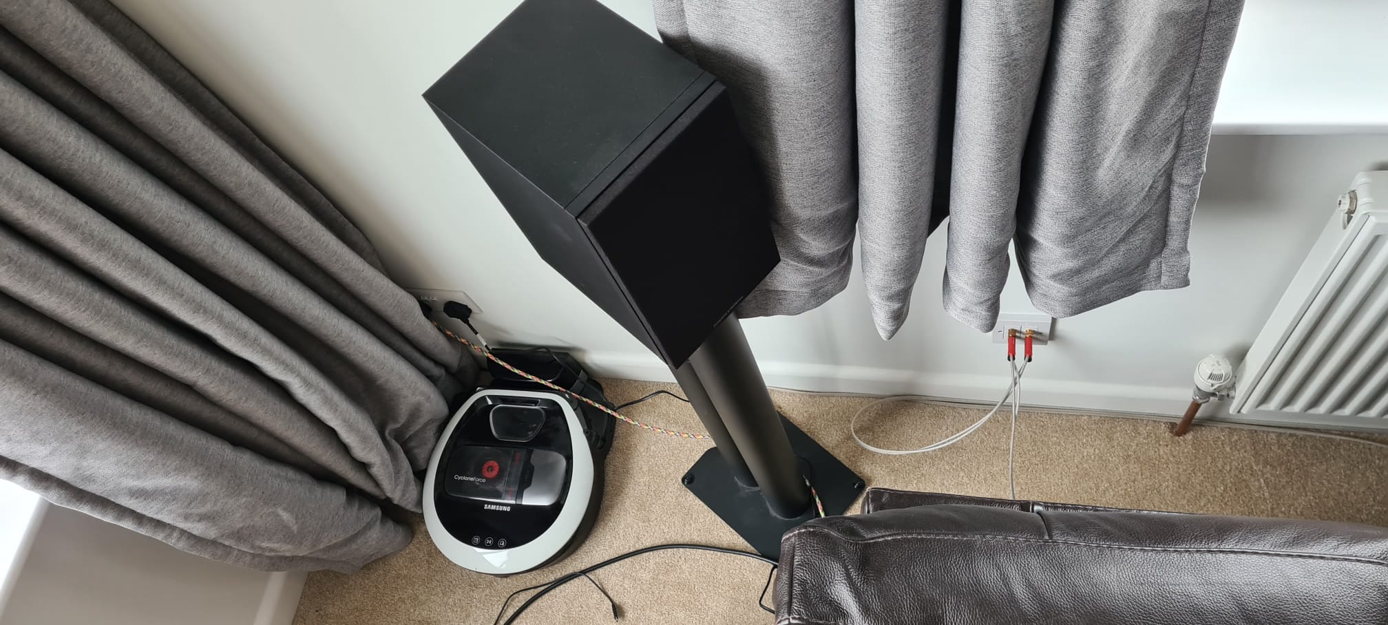

They can’t go back any further, I’ve pulled the sofa forward about as far as I would like it but I plenty of room to move the rear speakers out along the wall:
I could find Dave (the robot vacuum cleaner) a new home.

Moving them further to the sides should help and would also give you an idea of how the wall mounts you are considering might function. I currently use some wall mounted monitor audio silver surrounds in a similar configuration but they are roughly 75cm from the sofa ends. Does the av850 use multiple measurement sweeps during set up? I measured from the three seating positions on our sofa, and a couple of other seats, rather than a single hot position when calibrating.

I’ll try moving them out a few inches and keep them aimed at or just behind the listening position; I did try them moved right out into the corners but then no sound seemed to come from behind the listening position to the rear sound effects just sort of disappeared which is why I brought them in.
I will move the speakers out and re-run the calibration in the ‘wide imaging setting’. I’ve also just ordered some big cushions for the sofa that I hope should move the listening position forward slightly without pulling the sofa any further out.
If that doesn’t work then full nuclear option might be trading in the rear bookshelf speakers and stands for wall-mounted dipole speakers like the Monitor Audio ones.

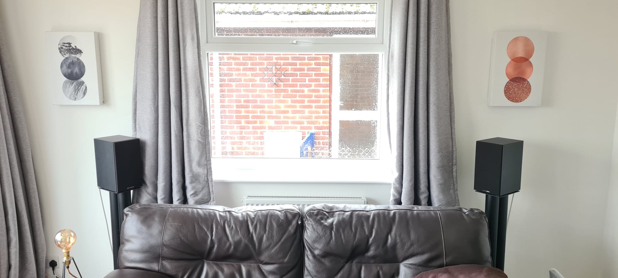

Thanks, it seemed counter-intuitive to me but widening the space between has helped, looks a bit better I think spaced out too. I’ll play around a bit more with the calibration. Stupid question but if I wanted to widen the sound-stage do I toe the speakers in out or in? I always assumed toeing them out would widen the sound-stage but from what I am reading, pointing them slightly behind the listening position is supposed to help which is basically toeing them in. I suppose with more toe-in there is more of an overlap in the projected sound? E.g. the person in the right seat will hear more from the rear left speaker with it pointed more towards them.

The speakers are right next to your ears on the sofa so you need to move them away into the corners of the room as far as possible or onto the side walls. You need to experiment more.
The beauty is they are on standmounts so should be easy enough.
