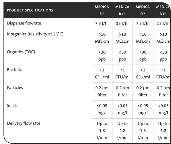

Have found a supplier of ‘UltraPure water’ for sensible Purchase and delivery price.
Have also a friend who works in a Lab, who is going to provide some from their system, as Grade 1 UltraPure water, with TOC of less than 30ppb having gone through a 0.2um filter - will come in sterilised amber bottles sealed.
Class 2 lab water is probably good enough. It’s been through a charcoal bed, an RO membrane and an ion exchange bed after that. You’re going to add a wetting agent anyway.

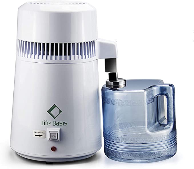

I just use one of these to create distilled water and clean LPs in an Audio desk ultrasonic cleaner.
Hello Badger1
Could you tell me a little more about the water distiller? Is it noisy and how long does it take to distill 4 litres. I’m a CPAP machine user and wondered if it might help, also will use it to clean records.
Thanks
Tim
Its on amazon and claims 3.5 hours for 4 litres, though no claims on purity other than distilled and condensed from steam.
Thanks will take a look.
Gazza has it right. I’ve used them for years as until recently I developed my own black and white film - distilled water is essential to reduce drying marks on the film. So it was natural to continue its use for LP cleaning. I suspect they pay for themselves quite quickly.

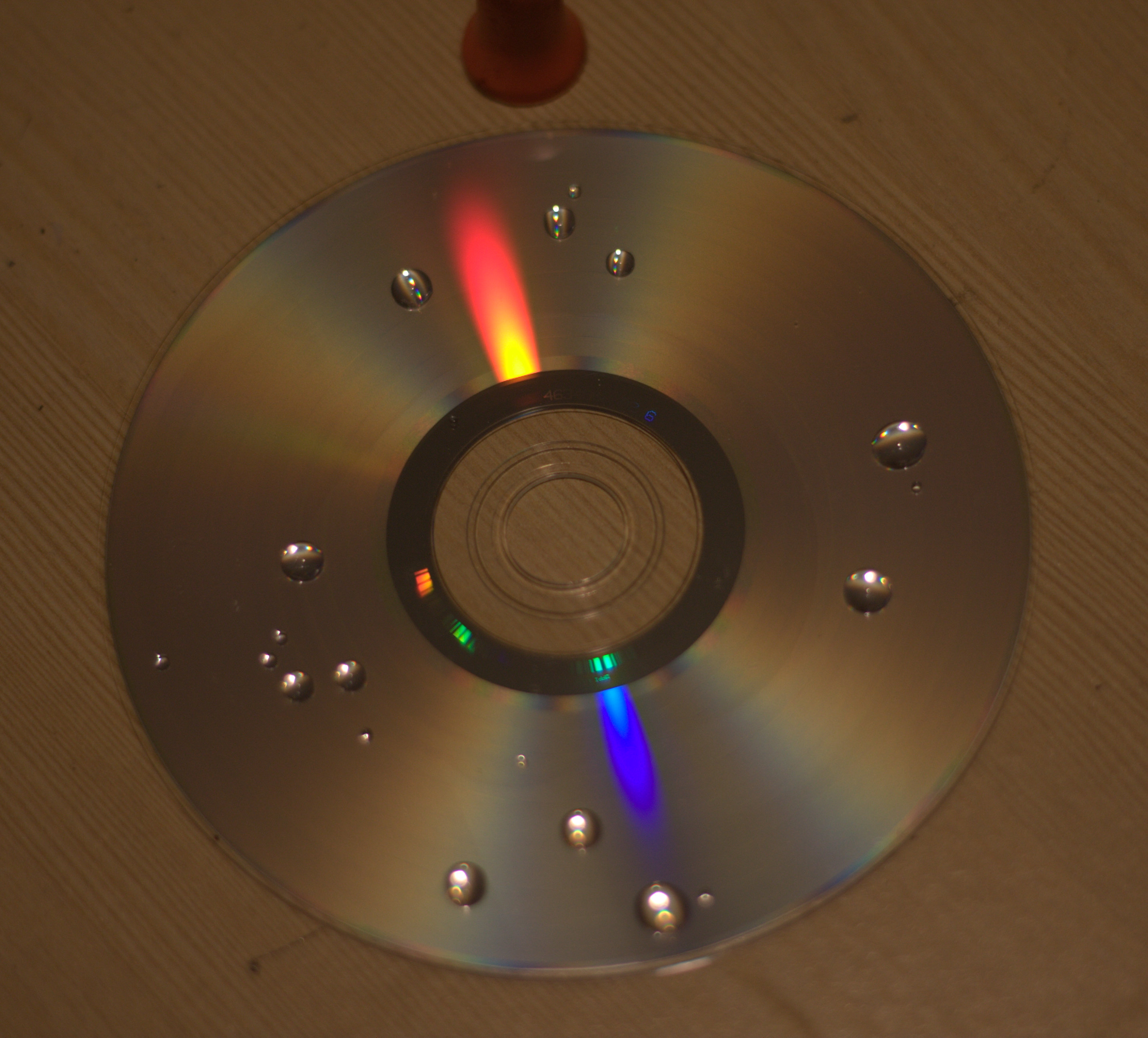

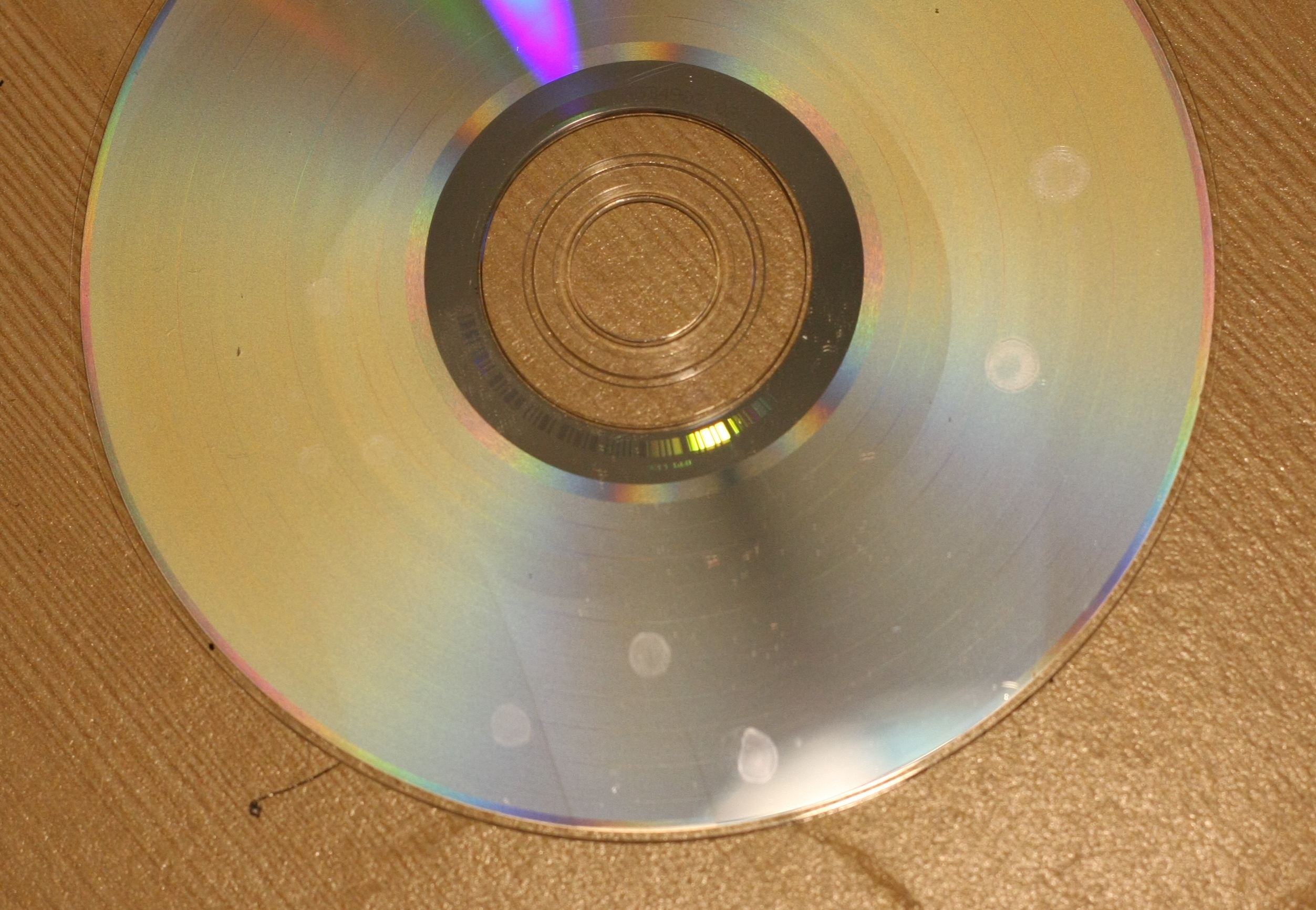

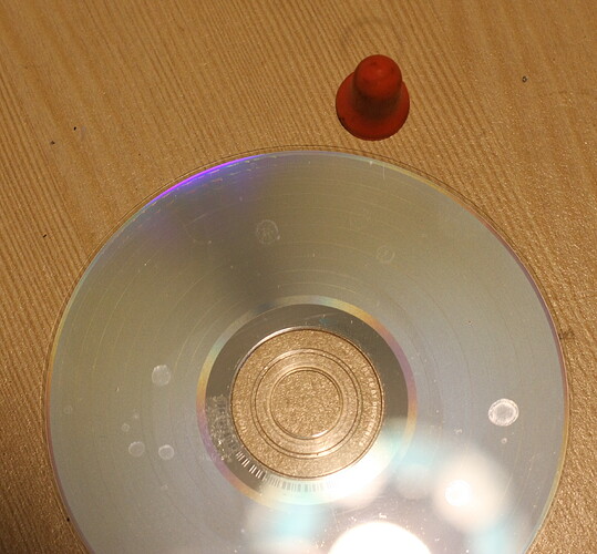

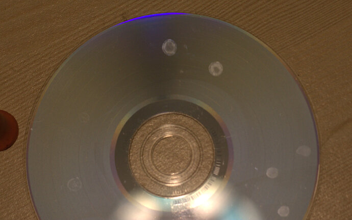

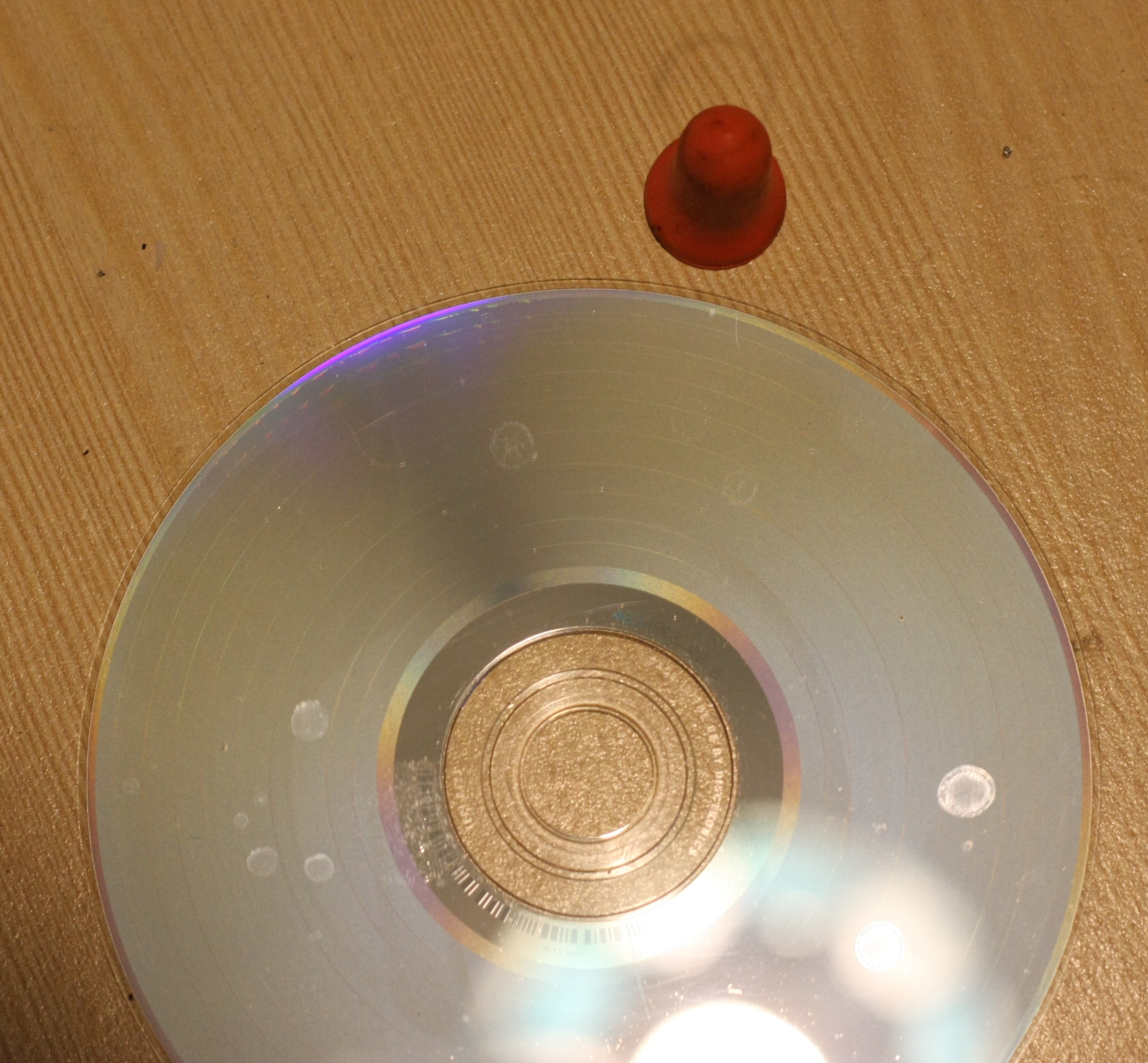

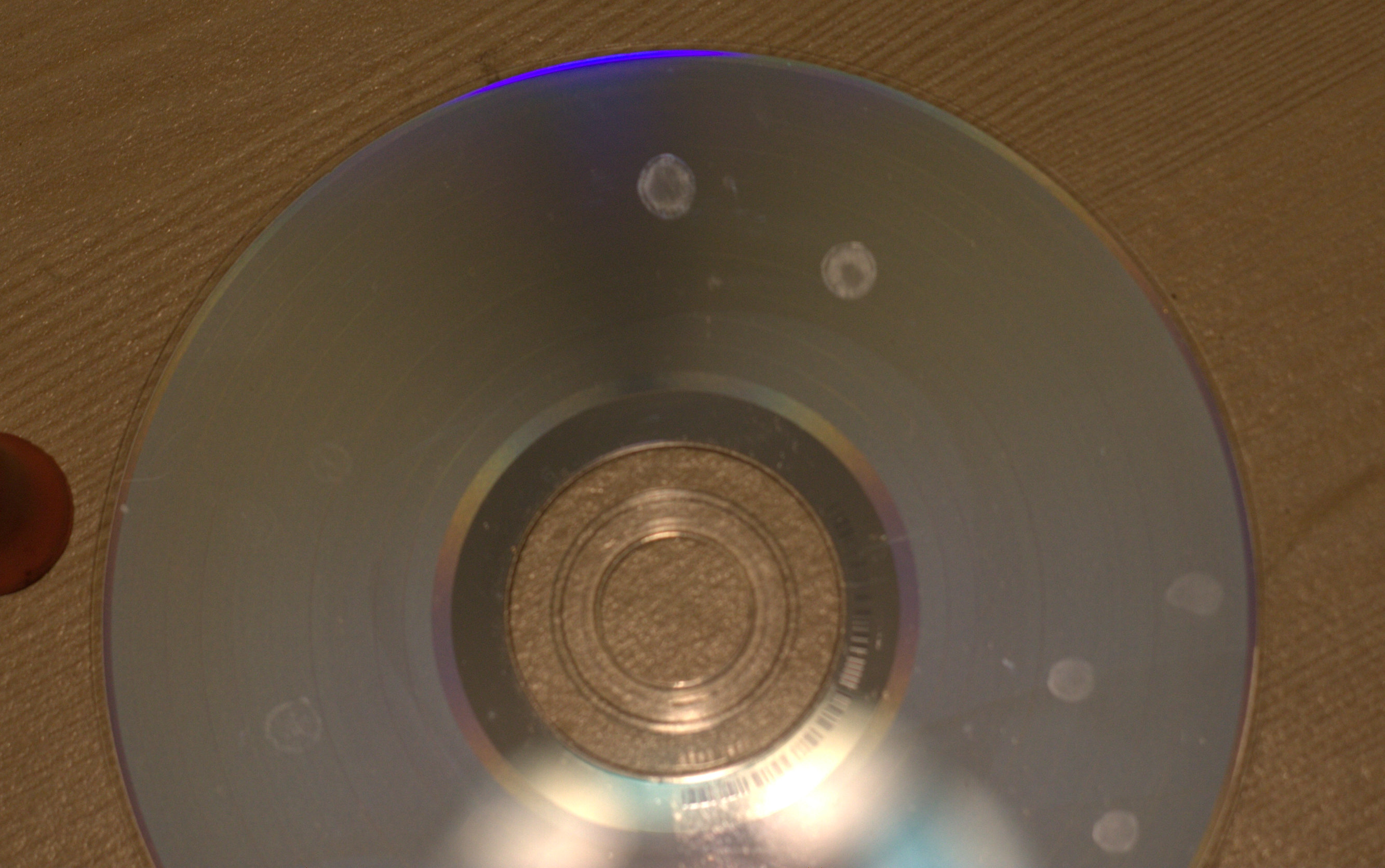

Last night I decided to look into the impurities present in various types of water.
I dropped various types of water onto a CD, left it for 24 hrs and compaired the deposits left on the CD after evaporation.
12 O’clock is the orange earplug, as is De-ironised water.
3 O’clock is tap water.
6 O’clock is water from my de-humidifier.
9 O’clock is bottled springwater (asda).
De-ironised water clearly left least deposits.
Tap water clearly left most deposits.
And in between is de-humidified and bottled springwater.
