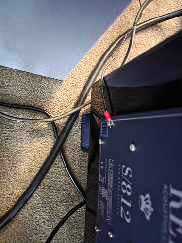

You need to earth from the Rel to Chassis ground on power amp. Use a cheap phono earthing wire from one of screws on back of Rel to your power amp.
Hum will be gone.

I did alot of research, watching Rel videos from their boss John Hunter. And he said in the event of any hum go to Chassis ground. Just undo a screw on the back slightly and earth wire from there to back of power amp.
