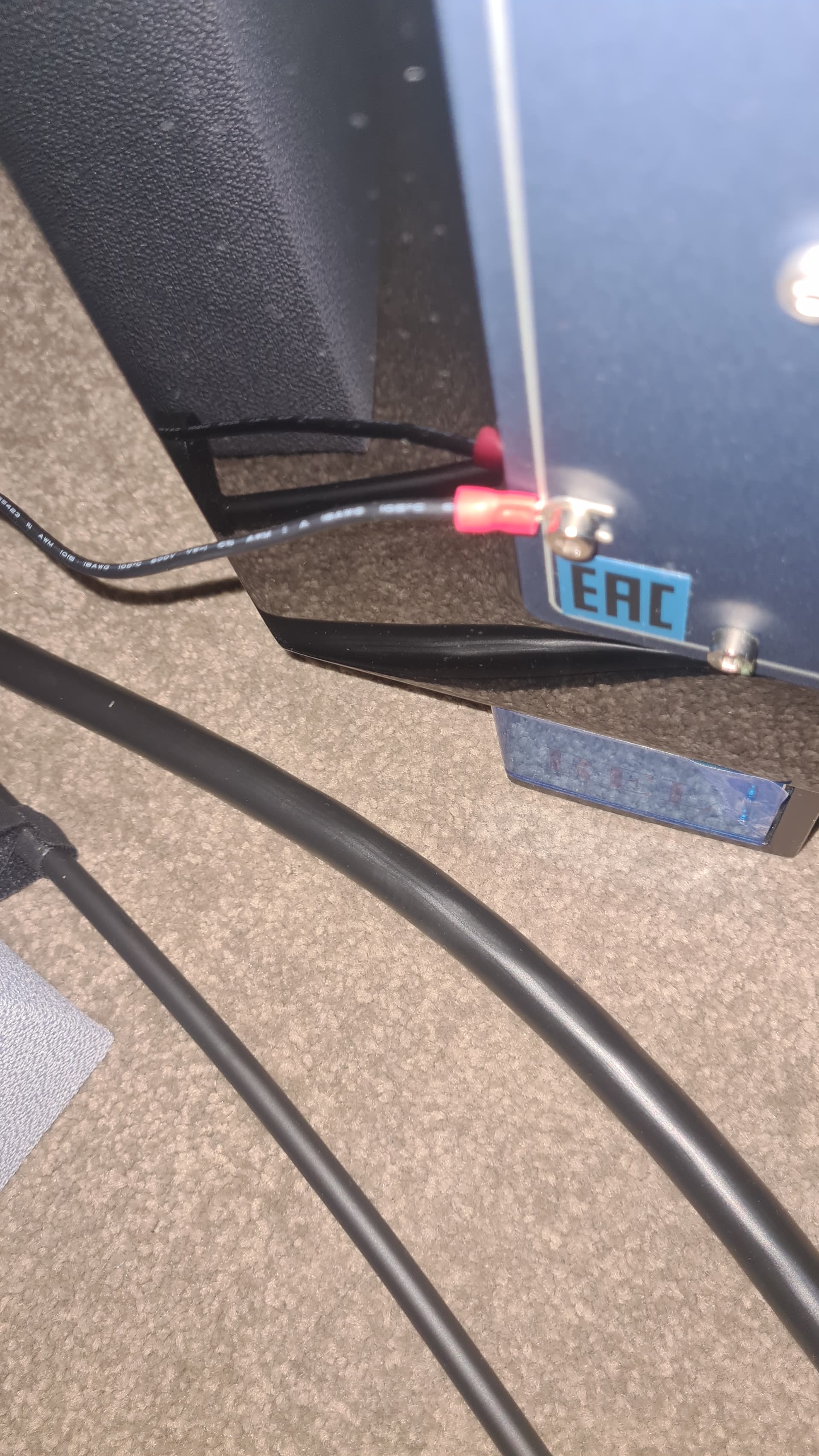

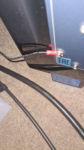

I have resolved the hum on one Rel 812 sub woofer. The slight hum was only present when I installed a LFE cable to handle surround speakers on Home Theatre.
I used a phono ground lead from ground chassis on Anthem MRX1120 to Rel 812 rear panel outer screw. The outer screws need to be undone by a specialised bit which I had in my handy ratchet screwdriver bit set!
Rel 812 no. 2 is being sorted. Ordered longer cable. I have gleaned information from this forum and on Rel videos to resolve the issue.
This is how I attached it to Rel 812:
Note, I had no issues on high level connection with hum. This may be of use to those who want to use LFE and get hum. If your AV amp doesn’t have chassis ground you can undo a transit screw from rear of case and attach it to the casework.

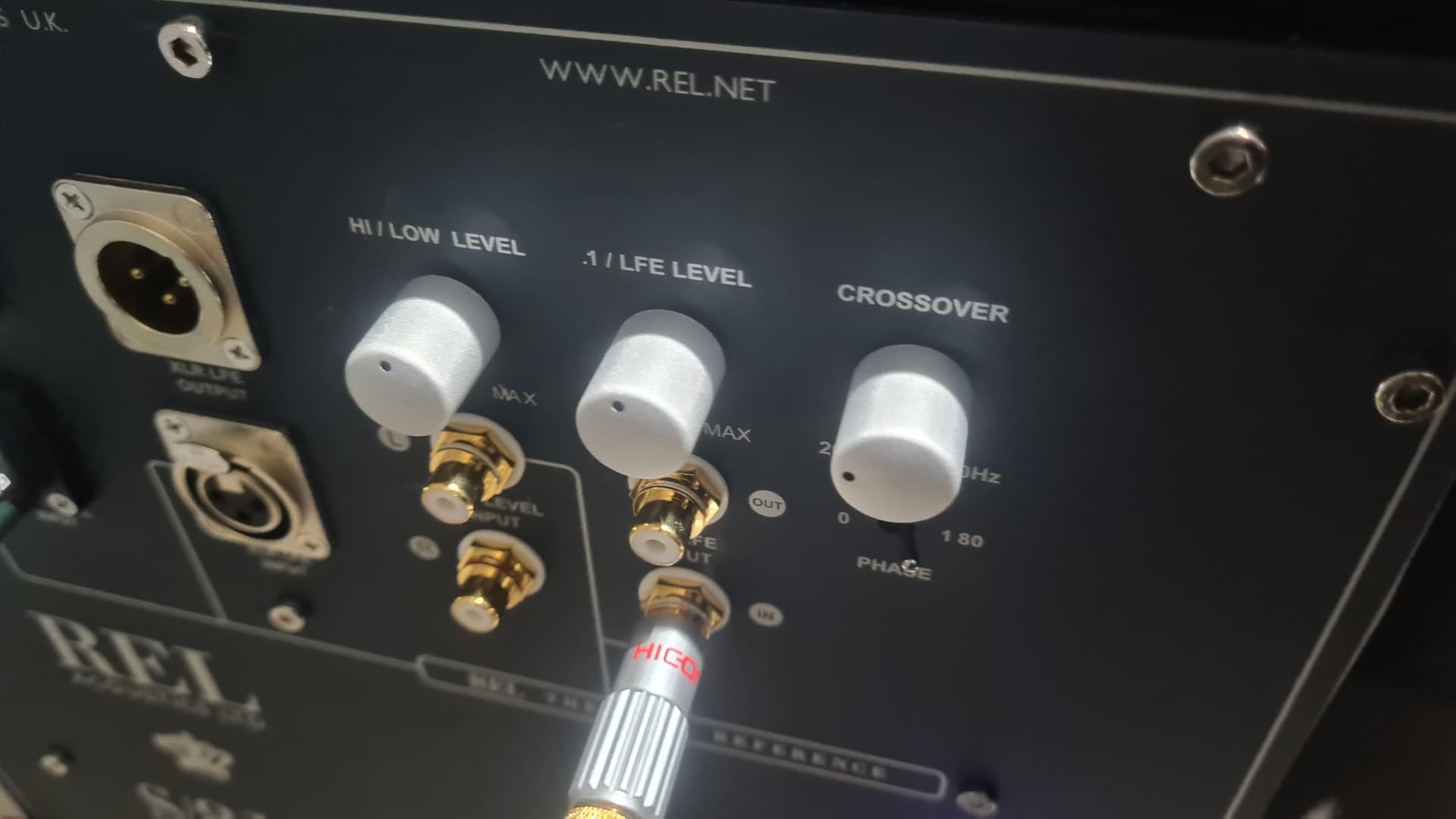

The REL crossover setting is only related to the hi/low level signal of the main speakers. It doesn’t affect the .1/LFE input. Only the gain can be adjusted independently for this.
My levels are as follows on Rel 812s.
9 o’clock crossover.
12 o’clock for high level and LFE.

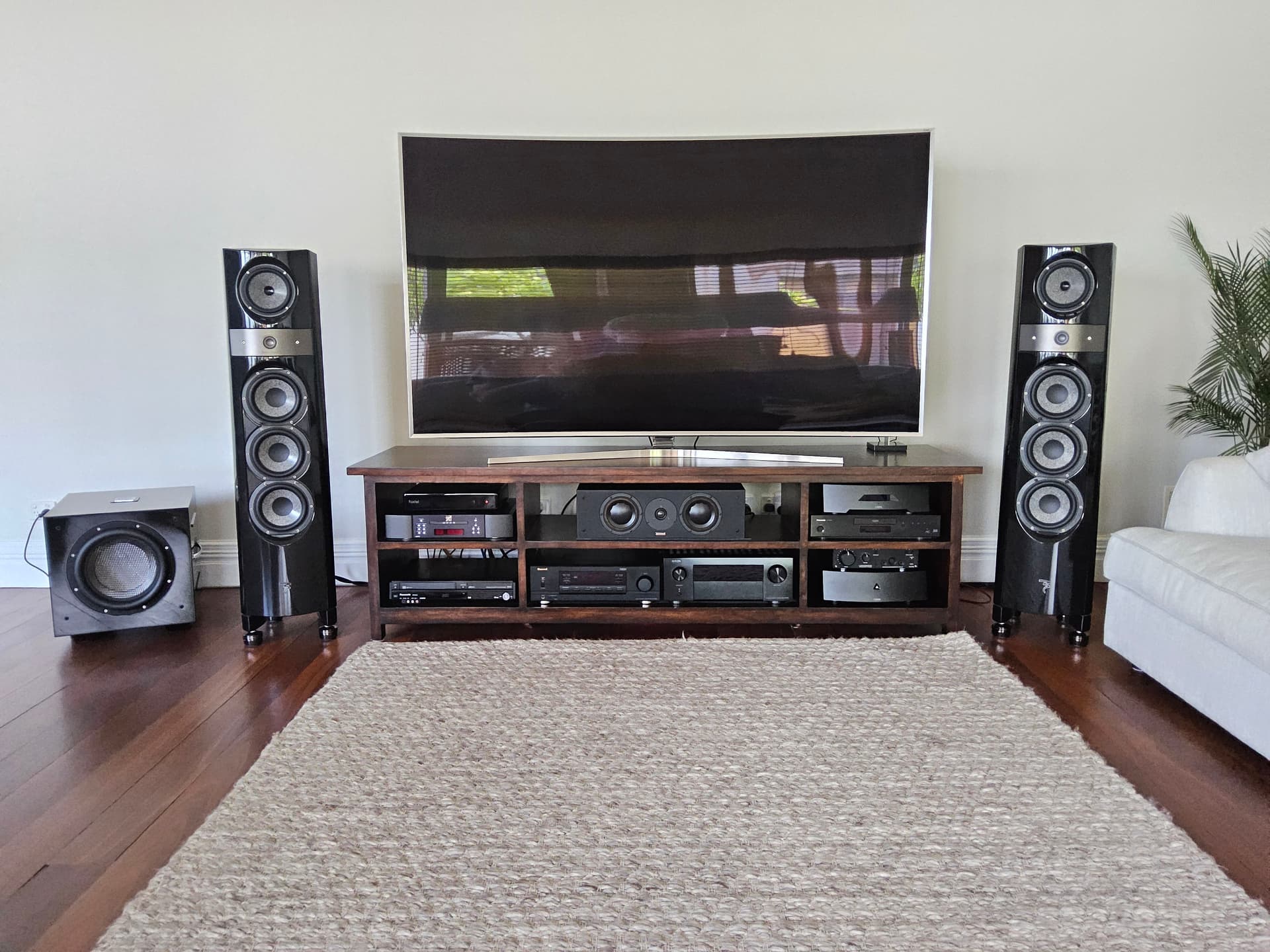

As requested, a photo of the REL Carbon Special installed in my Main System in my Lounge Room.
I’ve spent the last 3 days setting the REL up for both Music (my main reason for getting the REL) and Movies with the added benefit for 5.1 Music.
STEREO MUSIC
The REL is connected to my Lumin Stereo Power Amp using a Mogami Hi-Level Connection Cable (which as Dan advised is far superior and with much bigger conductors that the REL cable that comes in the box) and no hum detected with all equipment switched on in idle mode.
I used my Tidal Playlist which I use for Music Equipment Demo’s and also compared Tidal to the CD and Hi-Res Blu-ray discs I have of the same tracks and found I did not need any further tweaks to the Subwoofer settings between the three sources, with the CD’s and Blu-ray’s sounding just that little bit better than the Tidal CD and Hi-Res Quality Tracks.
The tracks were previously chosen for good bass lines, deep bass and fast bass to test HiFi Gear so well suited to the task of setting up the Subwoofer.
I had been reading quite a few articles online about setting up a Subwoofer for Music, and quite a few suggested setting the crossover at 10Hz above the Main Speakers bass performance, so based on that I initially set the REL crossover to 50Hz as my Focal Electra 1038Be’s go down to 33Hz. With the REL crossover dial; 20Hz = 7 O-Clock and 120Hz = 5 O-Clock so 12 O-Clock is 70Hz therefore 50Hz was at 10 O-Clock.
From this point I adjusted the Gain dial to tune in the Subwoofer and I found an optimum setting of 1030 O-Clock, which I felt was about 85-90% perfect. The next day I re-ran all the listening tests with the crossover reduced to 45Hz = 9.30 O-Clock and found the bass was improved with a cleaner, more defined and more articulate bass sound, which indicated the setting was more integrated with the bass performance of my Main Speakers and based on this I increased the Gain to 11 O-Clock which sounded excellent and felt that it’s now about 90-95% perfect.
I will leave the settings now for a few weeks to listen more and allow for the Subwoofer to fully break-in, but, it’s a HUGE overall improvement to my Stereo System’s sound quality performance.

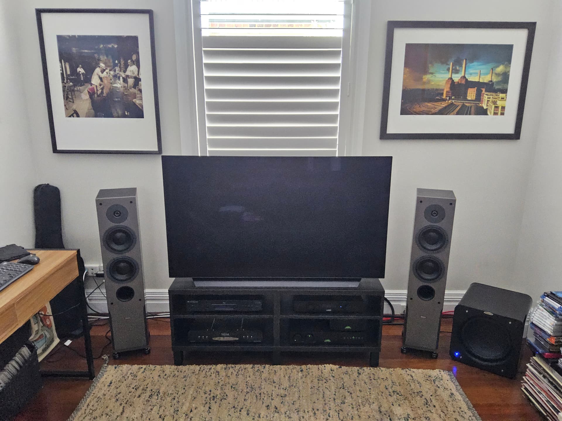

I re-purposed my old Velodyne SPL-1200R Subwoofer into my Study Stereo System and have it connected using Chord Shawline RCA interconnects to the Subwoofer output of my Supernait 3.
I’ve set the crossover at 50Hz which is 10Hz above the bass performance of my Dynaudio Audience 72SE Speakers, it has also made a HUGE improvement to that system, but needs some fine tuning to get it set up perfectly in that room and system:
