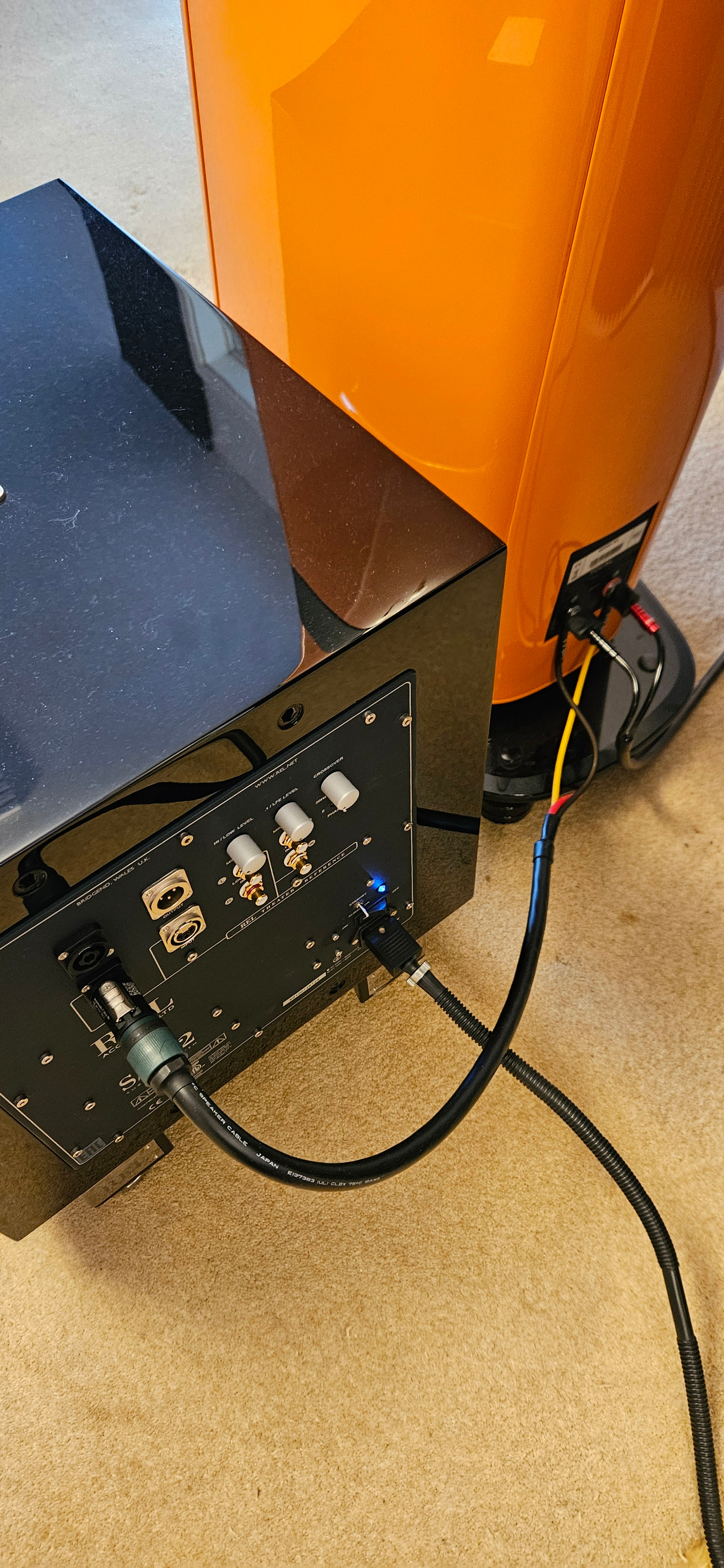

Hi. I am looking at Signalcable’s REl Cable. Would that be okay to use with the SN3? I would be connecting the Signal cable to the back of the speakers and not to the SN3. The reason I am asking is because of what it says on the cable page. And I’ve read that Naim amps or at least older ones don’t like certain type of cables.

I figured I was, but someone even told me that I couldn’t use a litz cabe on the SN3. I don’t know if its true. Some say that only applies to older Naim gear. I’ve been using the REL just fine, but I wanted to build my own cable for aesthetic purposes. When I read that the Signalcable is twisted I thought of the litz configuration so I came to ask.

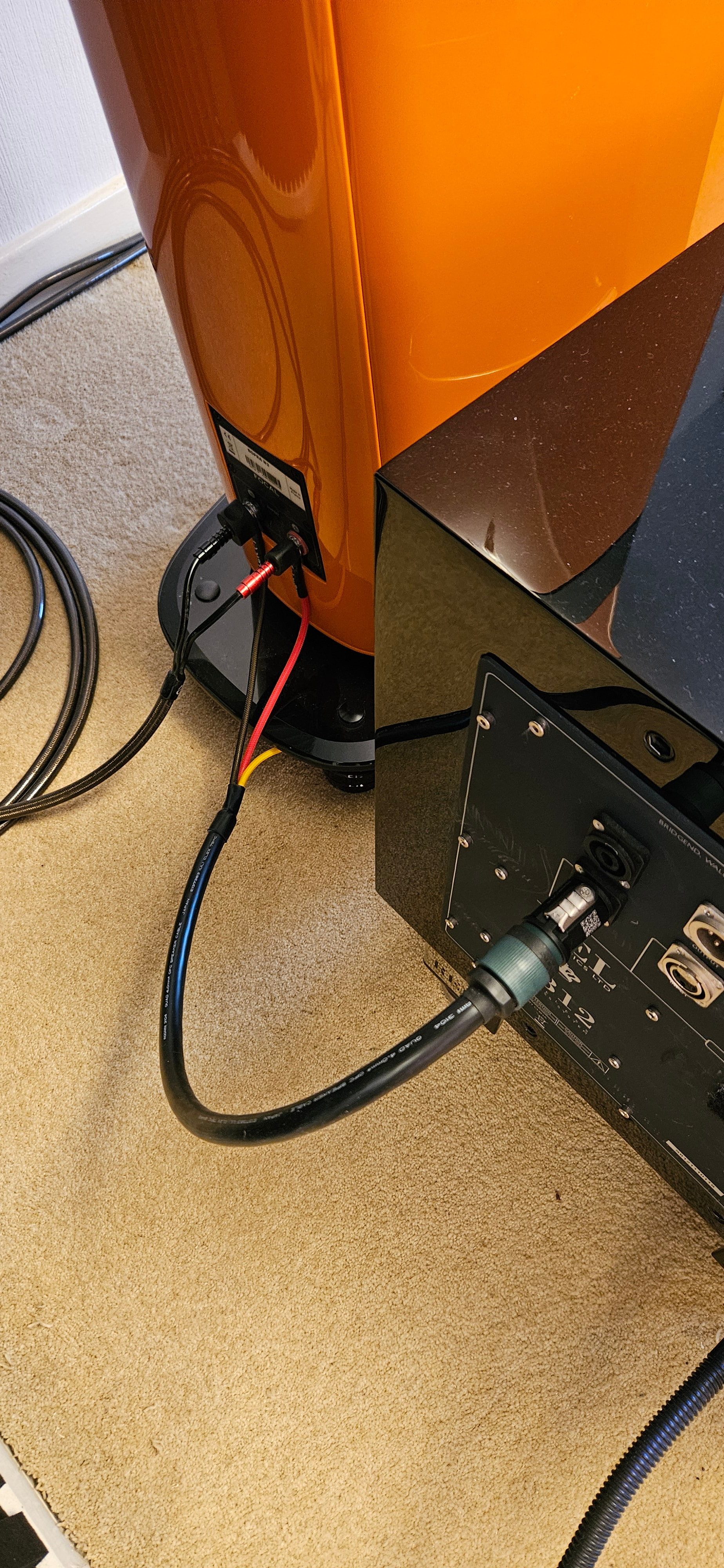

Something that I do find very strange is what happens when I switch amps. I have a JBL MA710 that I sometimes use when I want to watch movies. My speakers are Monito Audio Silver 500 7G. I have jumper cables on them, spade to banana. I have the SN3’s speaker cables connected to the top posts. The REL is connected to the bottom posts. When I remove the SN3’s speaker cables from the speakers and plug in the speaker cables from the JBL. The JBL goes into protective mode. When I remove the REL speakon cable from the speakers the JBL functions as it should. Any idea what could be going on there?
Litz speaker cables are indeed bad for Naim power amps. A basic copper cable with twisted strands will not have the disadvantages of a Litz cable. But these are issues caused by the cables that are attached to the power amp. The reason that Naim (and Rel) recommend attaching sub cables to the speakers instead of the amp is precisely because it eliminates these problems, so you don’t need to consider cable type.
I don’t know why you are having problems with your other amp, but this could have the sub cables attached directly to it.
