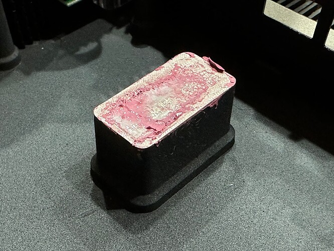

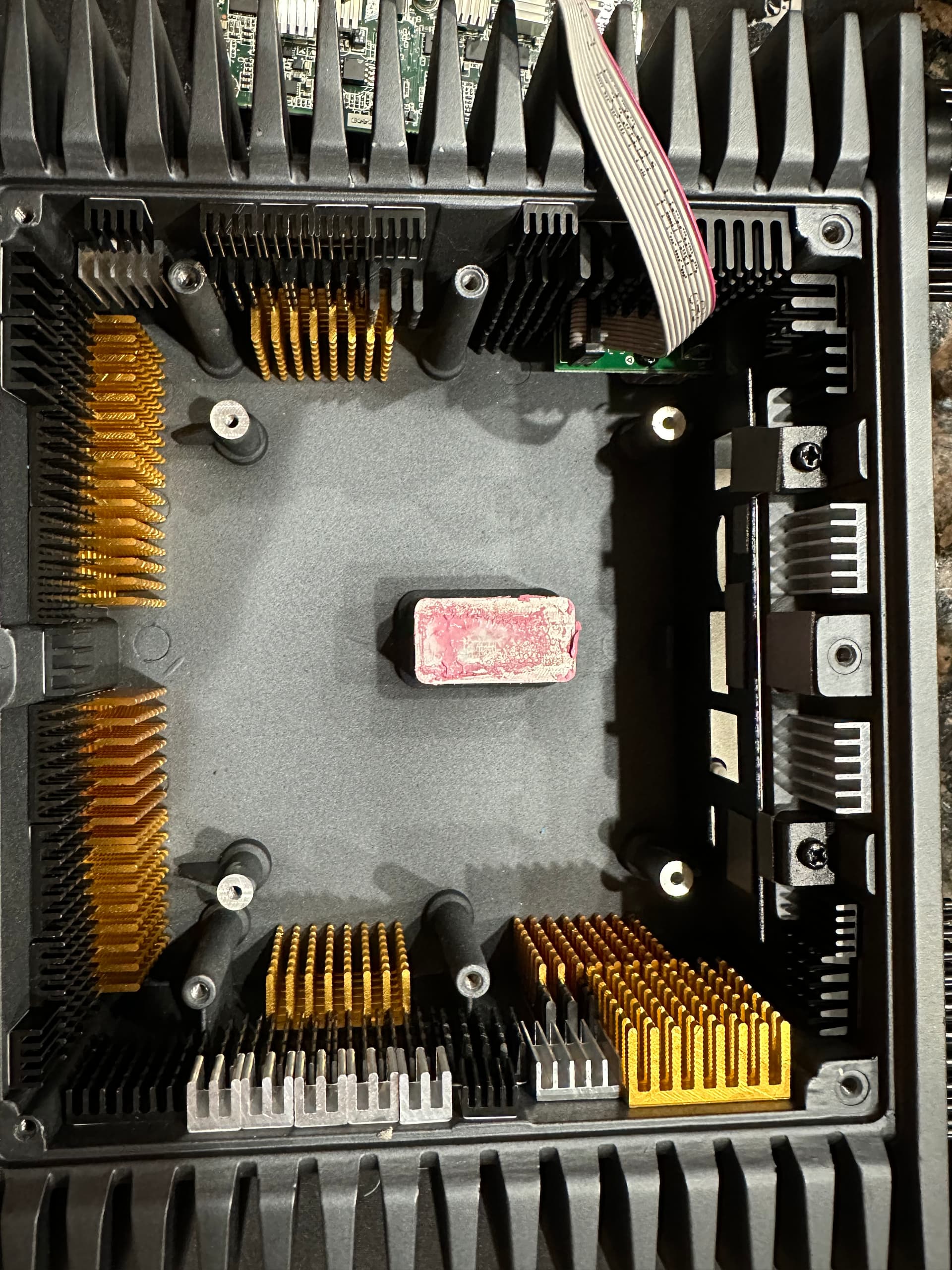

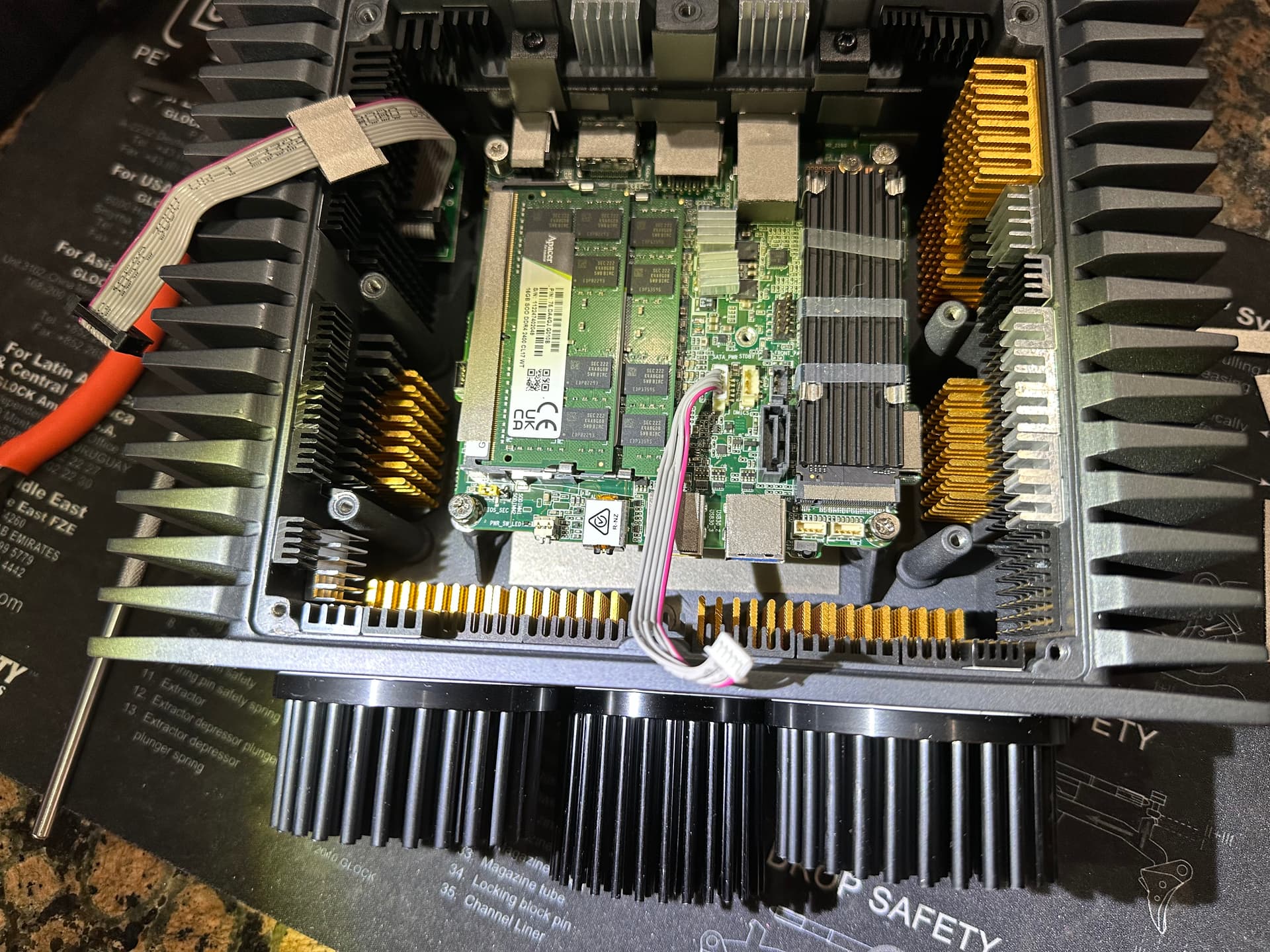

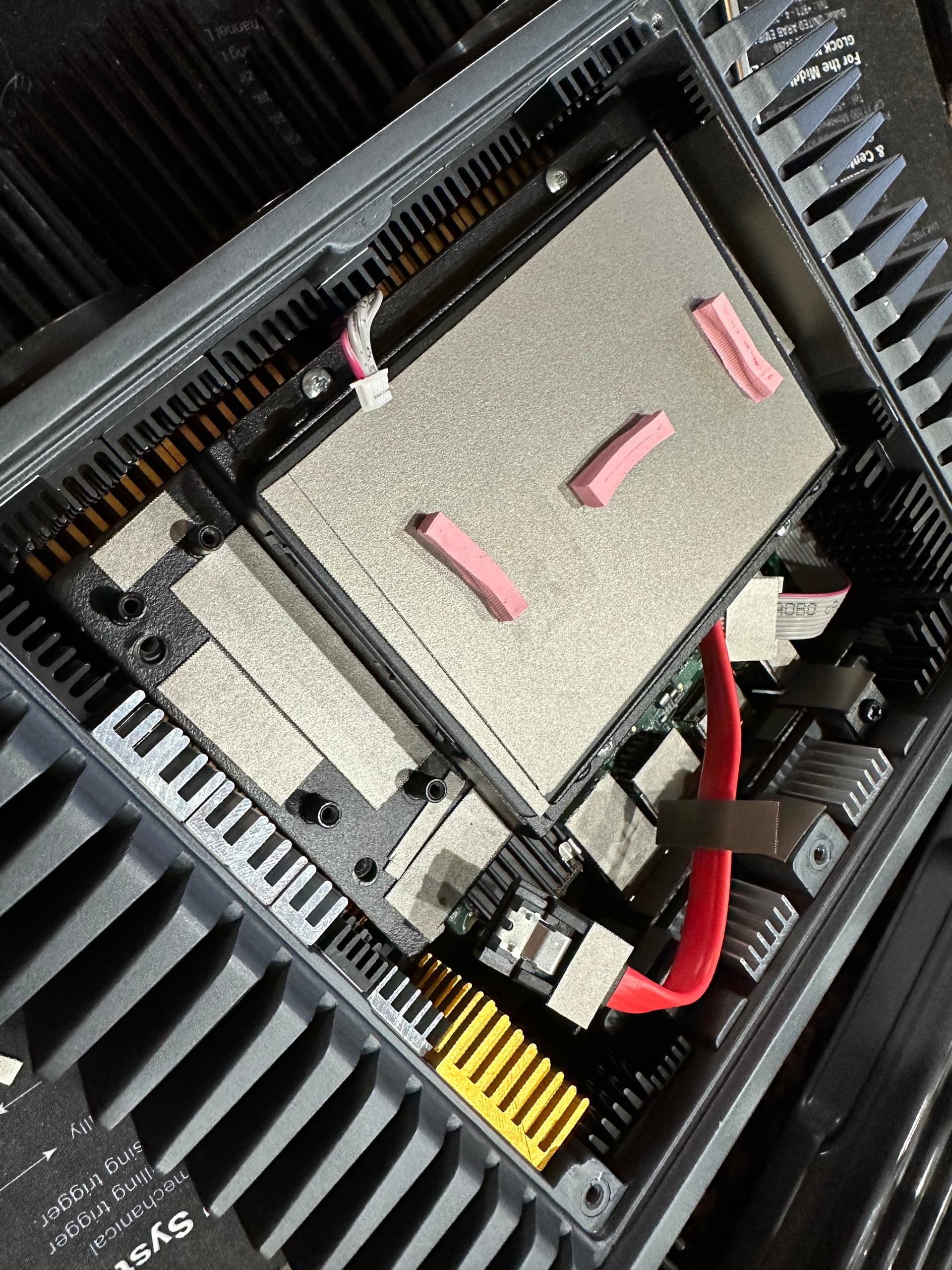

Having started with a N+ RevA, which I then thoroughly studied and modified/upgraded….then traded-in on a Titan. The issues that the first 2 generations of Nucleus had were thermally related. There were simply no provisions to address the thermal output of the rest of the internal boards/devices aside from the CPU. So the RAM, VRM’s, M.2/SATA SSD’s all ran hotter than was beneficial. I stuck a thermocouple inside and the idling temperatures inside mine when on, but not playing music, were…..disappointing. There are gaming PC’s with massive GPU’s that run significantly cooler. SO I stuck a trio of 75mm diameter x 50mm height circular german pin-based heat sinks on the front face and that showed a significant improvement in internal chassis temps. I then added heat sinks to the interior of the front face (increasing surface area inside and out to reduce thermal impedance) and this further dropper internal temps. I repeated that again with the sides (where the case heat sinks fins were cast-in) and temps dropped further…finally approaching what I thought were acceptable temps (sub 48C).
When the Titan trade-in offer came, I jumped on it. It brought both an observable SQ improvement in stock from (despite my N+ RevA using upgraded Apacer RAM, and upgraded Samsung 980 Pro M.2, and 3M EMI/RFI mitigations inside), using the stock power supply. It also ran significantly cooler.

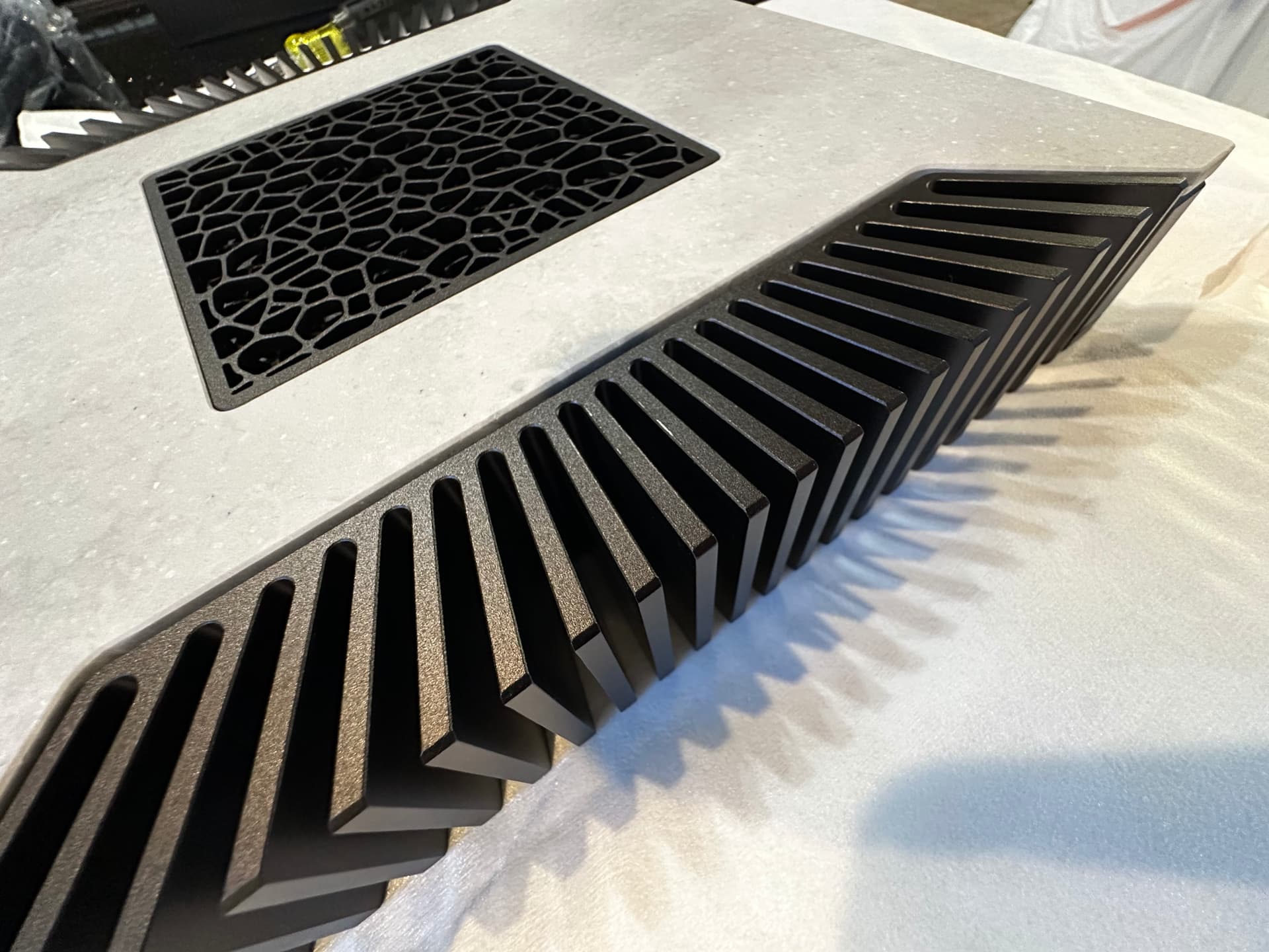

The Titan’s CPU is both thermally and electrically more efficient. So is the thermal design of its case; using a much more modern design with multiple heat pipes that directly-couple to the much more efficient truncated-fan-geometry heat sinks that occupy the side of the case. A large portion of the bottom panel is vented with circular holes (that are also designed with EMC in mind). It took a single measurement with a thermocouple to see that this was a whole different ballgame.
For SQ purposes (and with some secondary thermal benefit), I use the IsoAcoustics ISO**-PUCK** mini under the Titan which dropped internal temps another 3-4C.

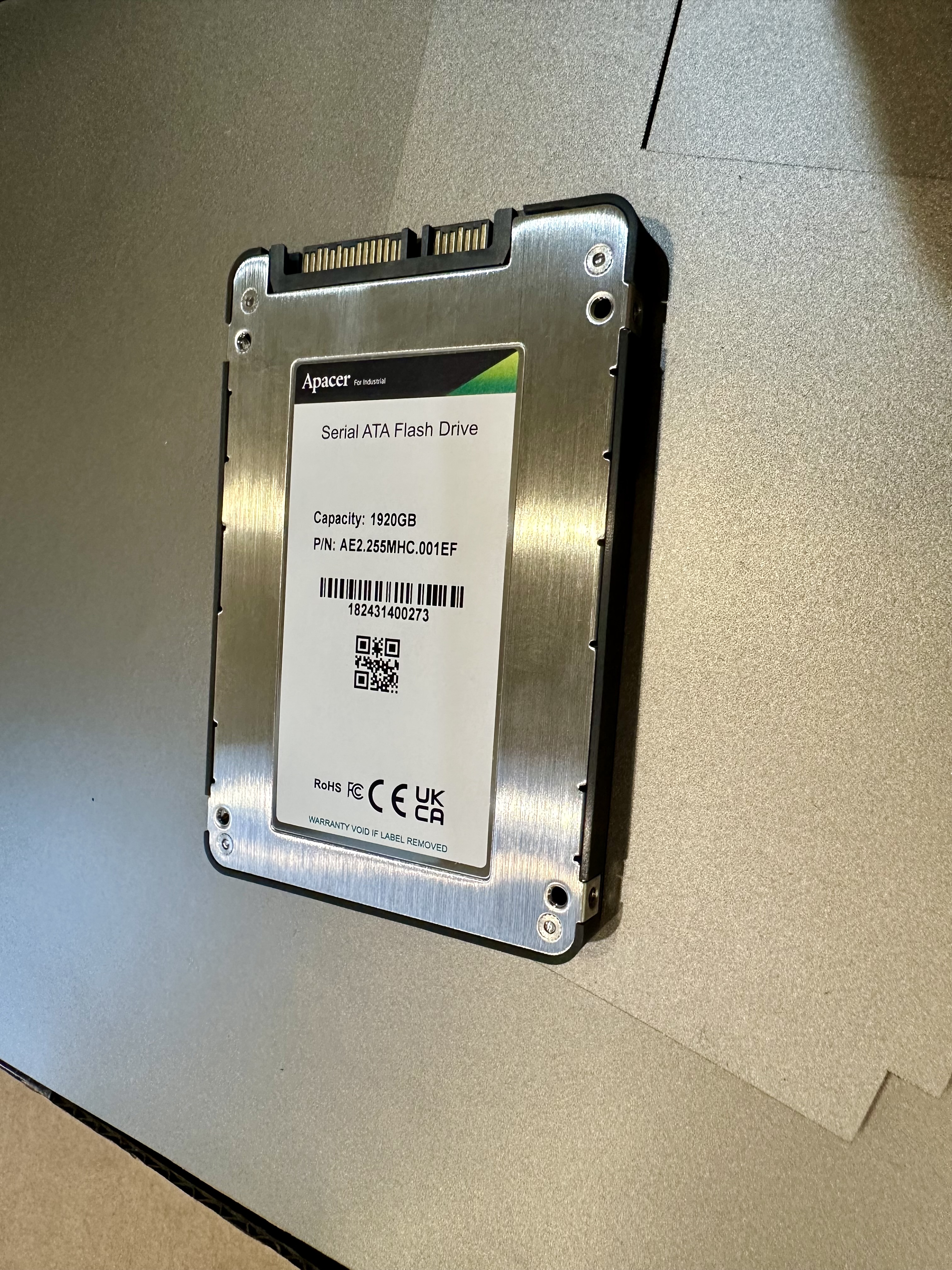

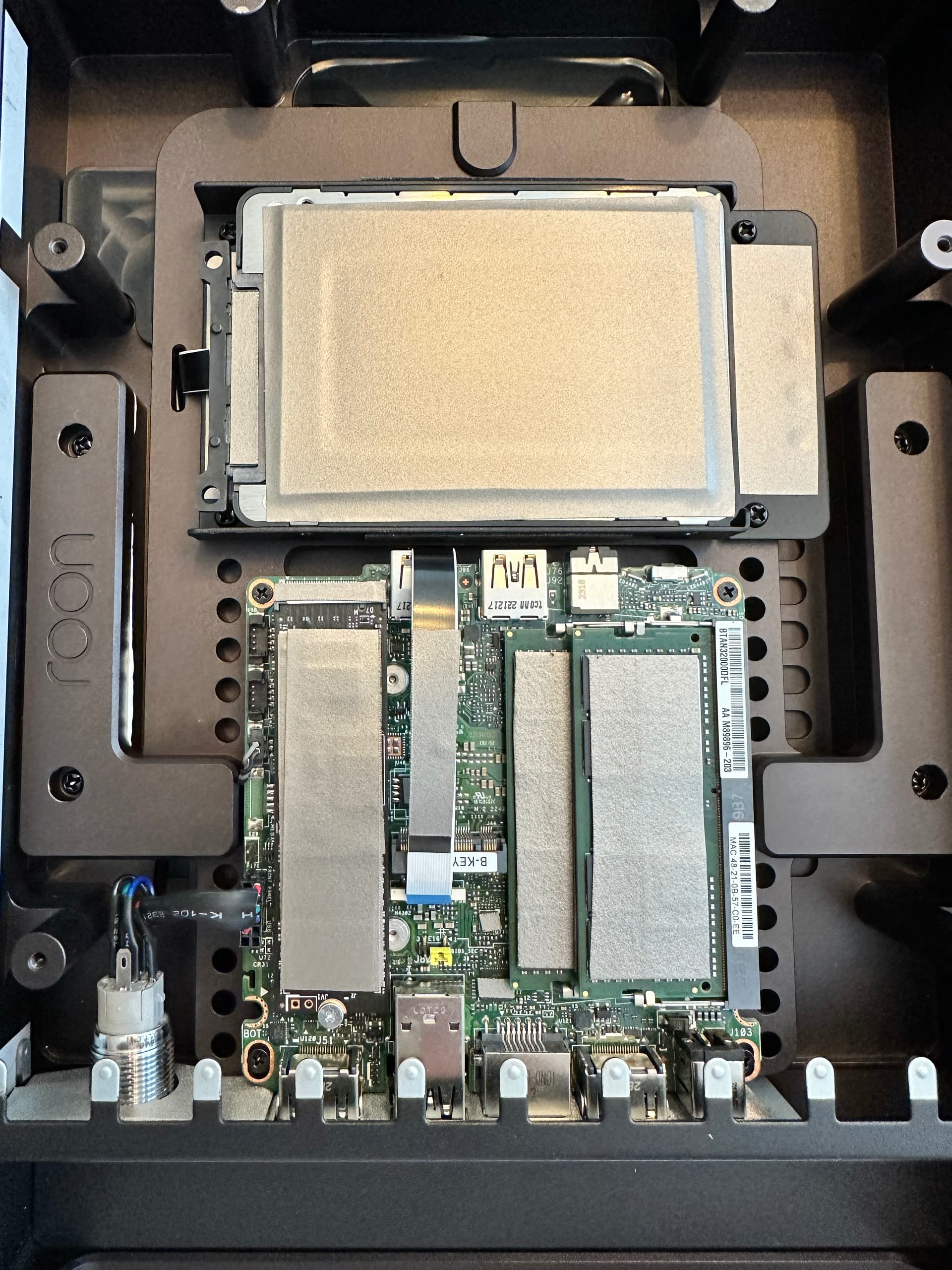

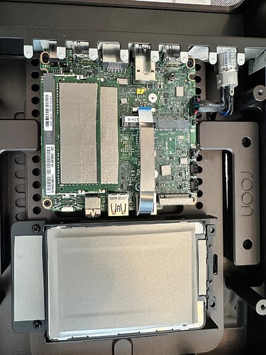

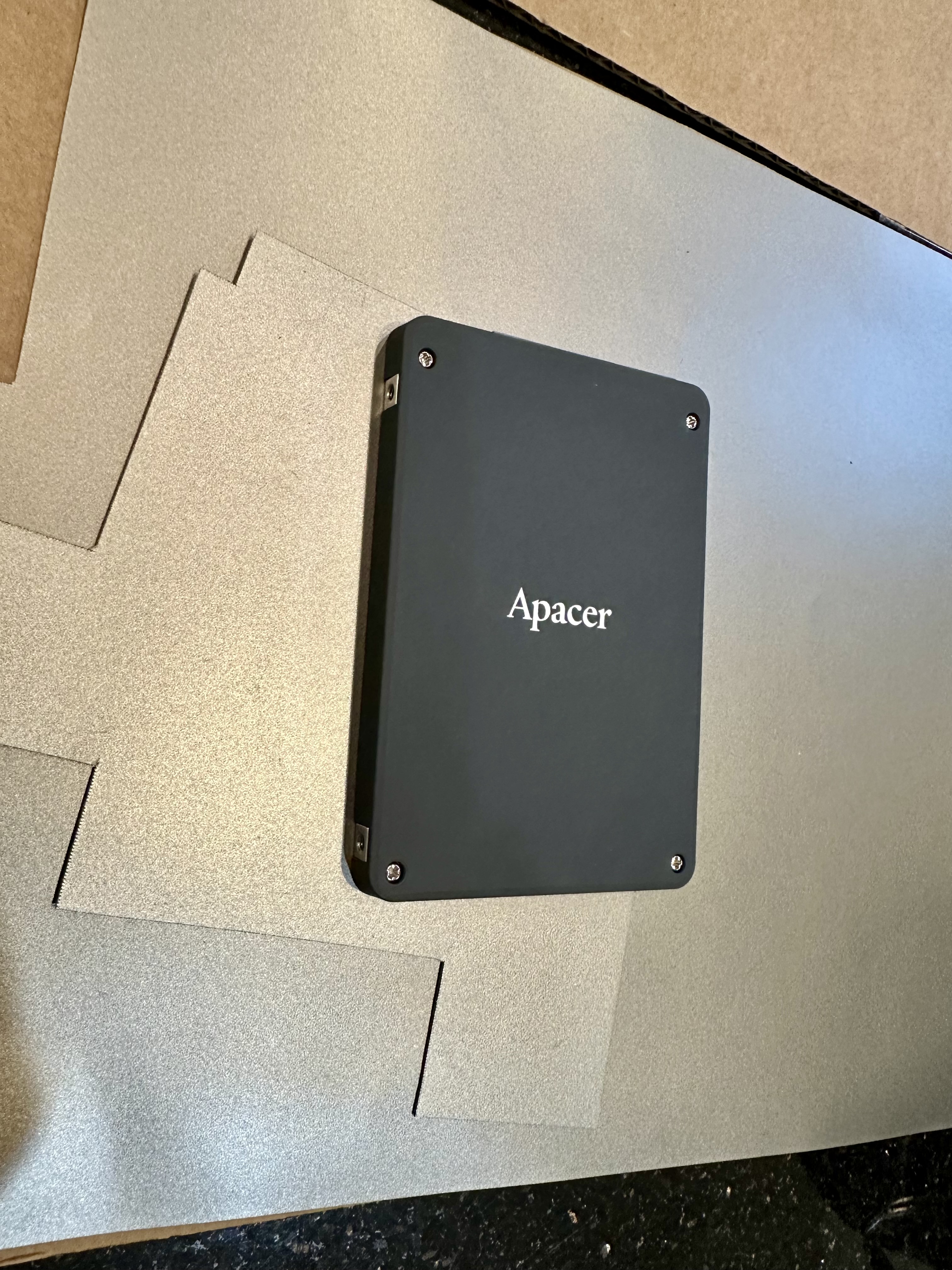

I’ve made various other upgrades using 3M EMI/RFI Materials, Apacer industrial wide-temp SATA SSD (music storage), and WD SN8100 Black M.2 OS/Boot drive upgrade. I then applied the 3M EMI/RFI material directly to: the RAM (both sides), various chips on the motherboard, the SATA SSD, the upgraded M.2 OS/Boot drive, and the inside of the case in various places. This brought significant additional SQ benefits for all endpoints (I’m all network-connected). The I added my Plixir Elite BDC 4A/19V LPS and another jump forward in SQ was seen.
All in, I’m glad I upgraded. BUT, the Titan is my primary music server and I’m 100% Roon.
Despite all the above, I think grabbing an Innuos Pulse Mini is a better fit for your ecosystem.

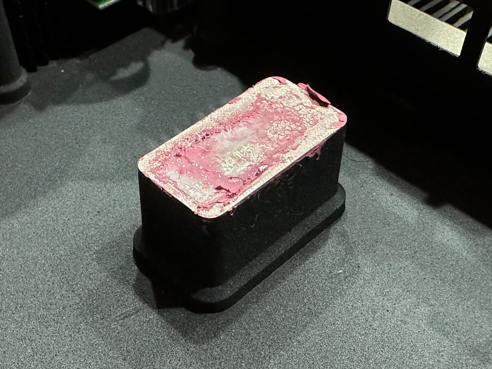

Images of my Nucleus Plus RevA mods. You can also see the Thermal Grizzly Kryonaut Extreme thermal paste that I applied to the CPU interface.
Versus my Titan:

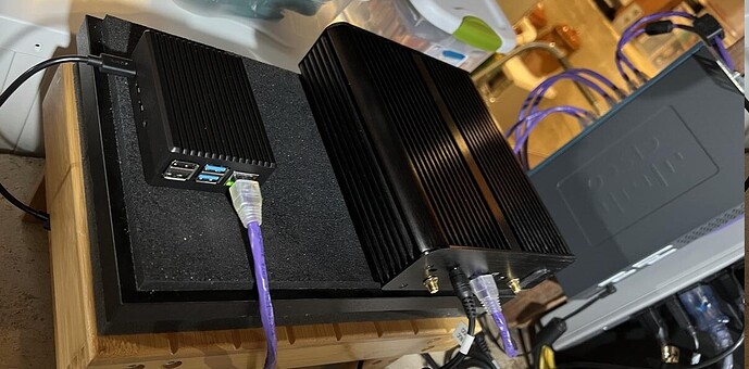

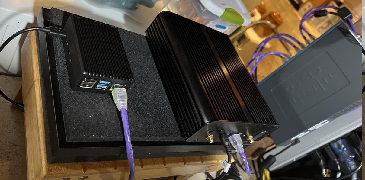

Likewise, I’ve been quite pleased with an i5 NUC in a fanless Akasa case for running Roon ROCK. It’s been rock-solid and trouble-free for over 7 years and counting.

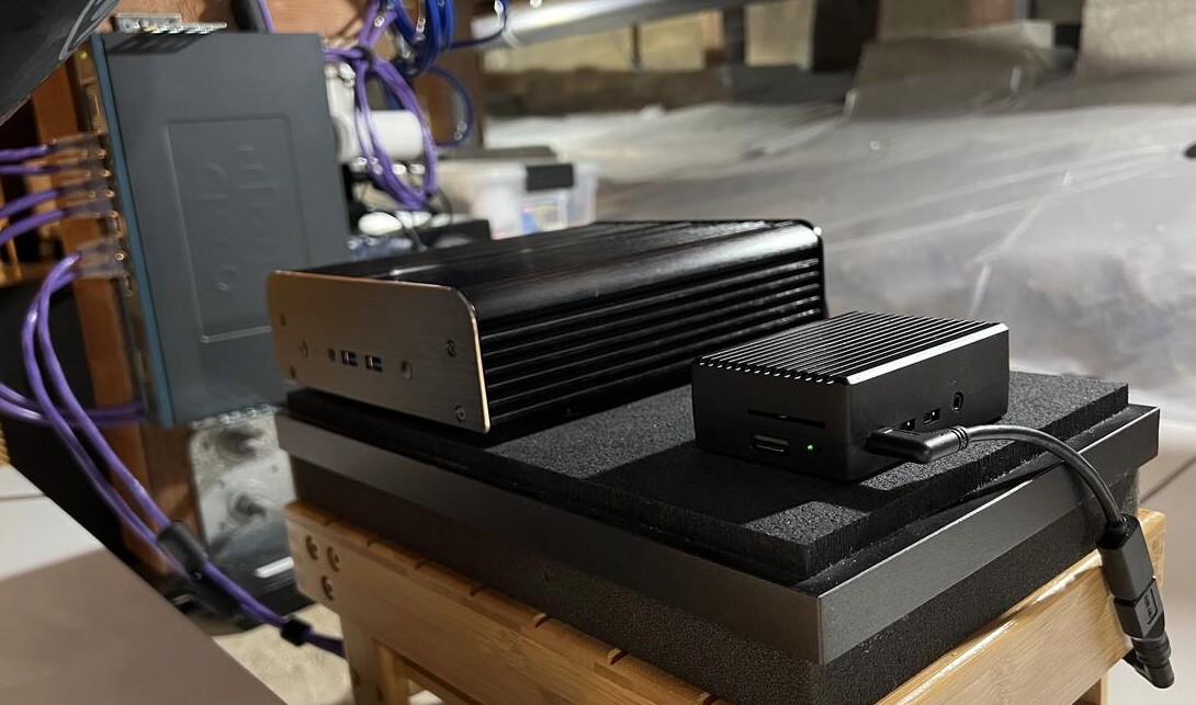

Here it is in my sub-basement, along with some of my other hidden-away audio gear including a RPi running the rooUPnP bridge to my NDS, and my Cisco 2960 “audio switch”.
One of the purple Blue Jeans certified ethernet cables runs up through the floor to my NDS.
My Synology DS720+ NAS (which provides storage for Roon) and a HDPlex linear power supply are there too, just out of sight.
I cannot detect any sound quality differences between my Roon UPnP setup including the NUC vs accessing tracks on the NAS w/Asset UPnP from the NDS.
