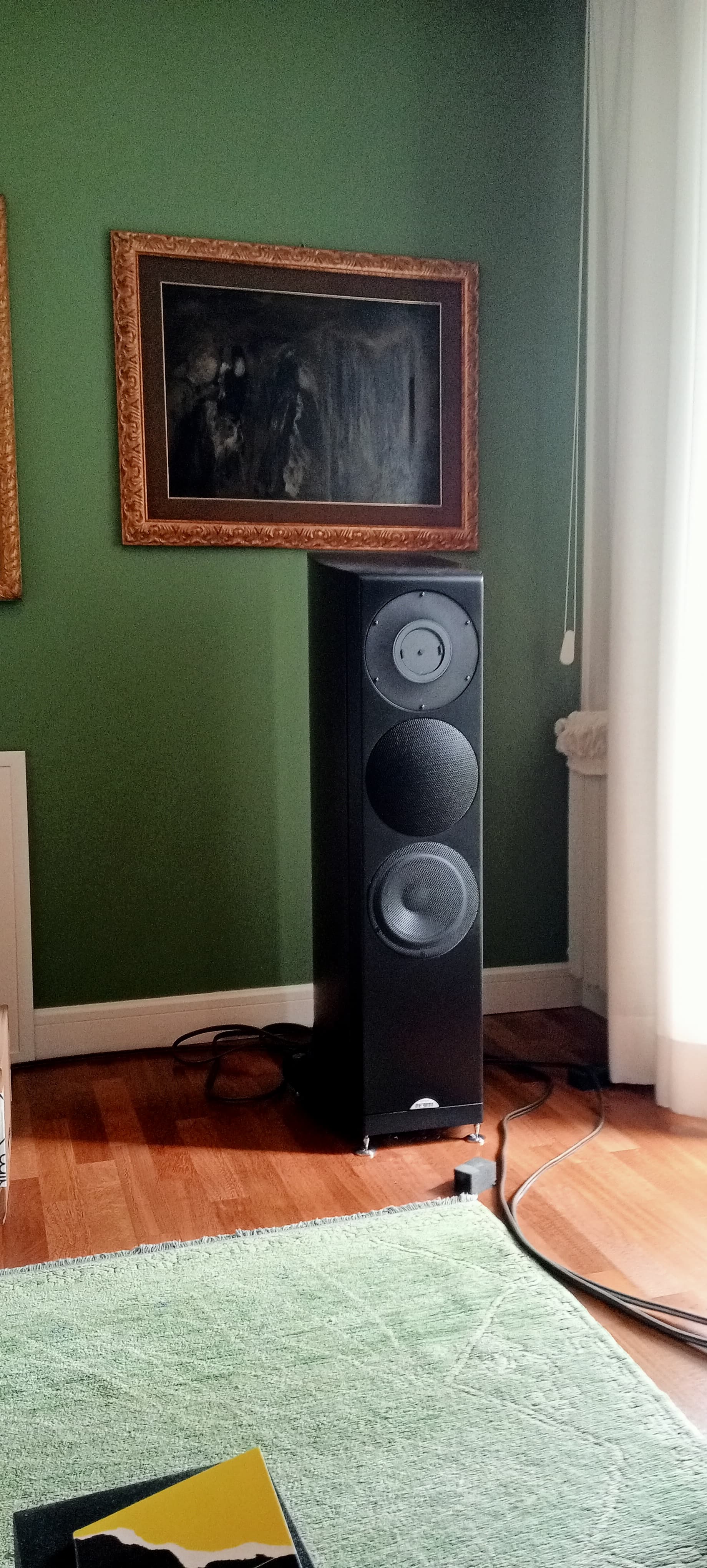

Yesterday, After a few weekend of non use, i played a CD on this system (L. Gerrard- Exaudia) not a very balanced recording, however the bass seemed more bloated than usual. So i detached the grills and retorqued the woofers, about 3.55 nm. The problem was that a foam behind the woofer grille pretty much disintegrated, let alone the difficulty to insert one of the grills again.
Most important is that now the sound appears more balanced btw.
My question is, such foams have an effect on the tuning of the bass?
Or like a suspect,
are there just for aestethics hiding the woofers, not very nice too see behind, Imho.
