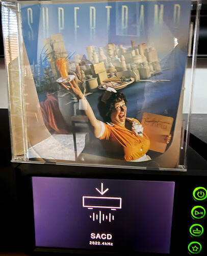

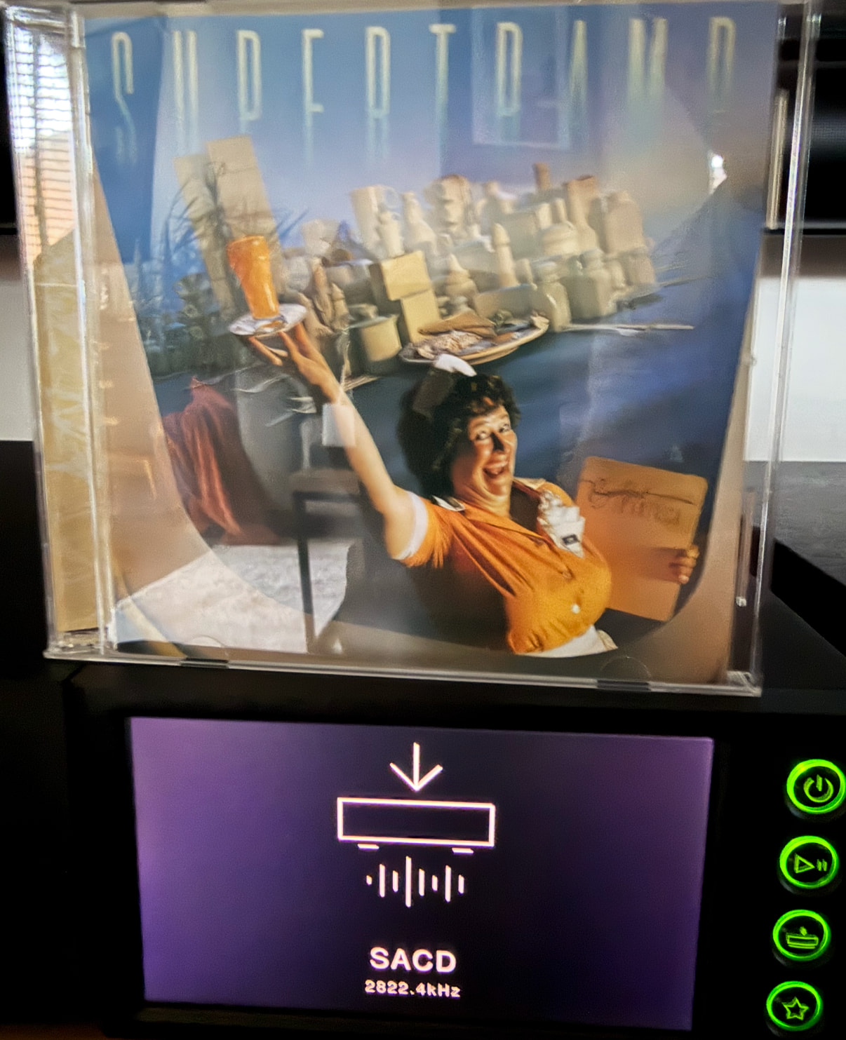

Player connected and adapter seems to work. I was expecting the NDX2 screen to say DSD but just shows 2822.4 kHz which is technically correct I suppose.
Initial thoughts are that it’s an improvement on streaming. Sounds nice and open. Very punchy. Enjoying it.

I can set my player to PCB but then the NDX2 shows this as PCB 176 kHz so I have left it at Auto which results in it showing the 2.8 MHz figure. Would like to try more options to get at the audio, but I said above for now I want to spend a bit on discs.
