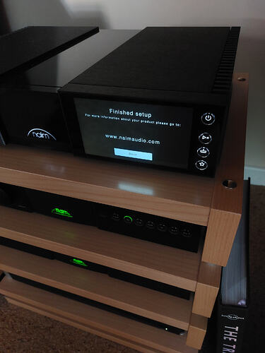

On turning it back on again my NSS333 came up with the ‘pair with remote’ screen and thereafter wanted me to go through set up again (I have had the NSS
333 since pretty much it’s launch, is that 4 years now? Not had any issues to now.)

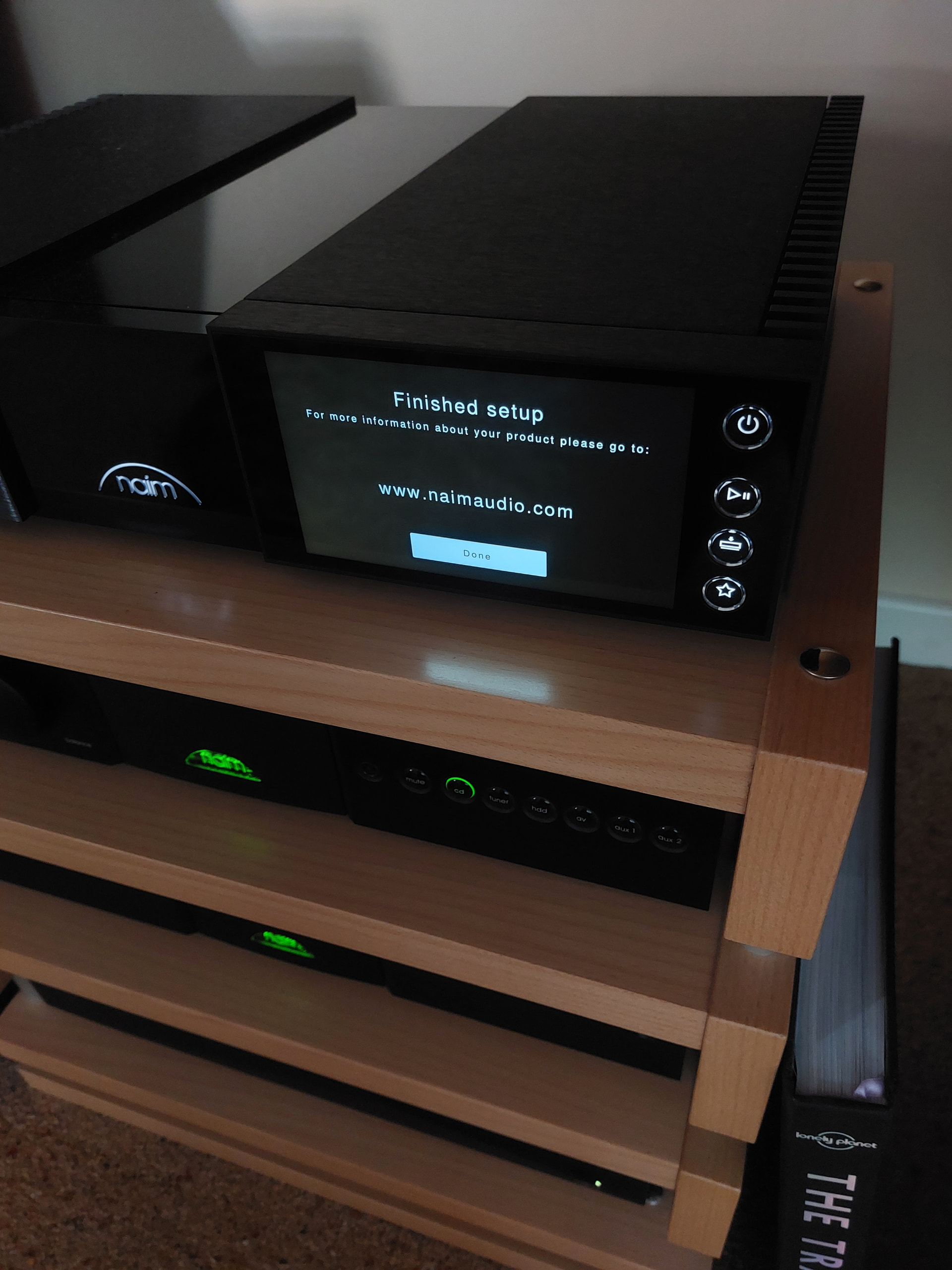

Issue I have is that I can’t clear the ‘Finished Setup’ screen and it appears to be stuck.
Any ideas how to clear it?

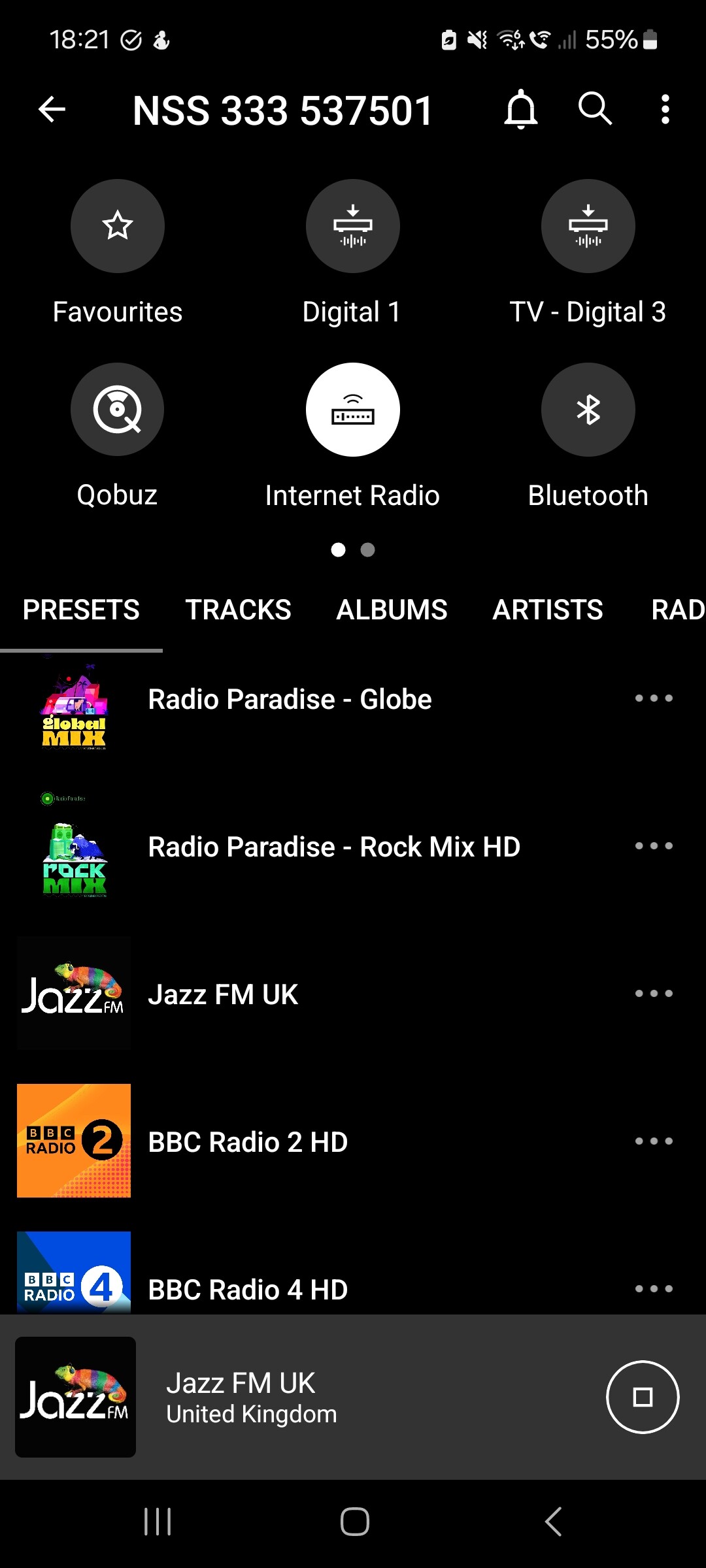

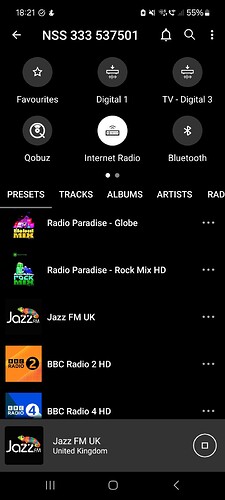

I can play via the app also via Roon, so it isn’t stopping me playing music, but I should be able to clear the NSS333 screen…

I wasnt able to clear the screen unfortunately.

Yes Graeme, the ‘Done’ button flashes to show that it has registered the click from the remote, but it doesnt clear the screen :confounded_face:
