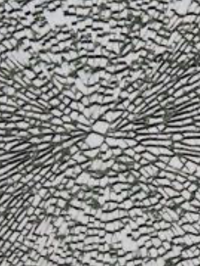

At the origin point of the failure can you see what appears to be a ‘butterfly’ or figure of eight as below? If so the failure is probably caused by a nickel sulphide inclusion which can expand spontaneously and crack the glass. If not, it sounds like an glass edge defect.

I’ll check at some point in coming days - I’ve covered it over for now in case it collapses.
