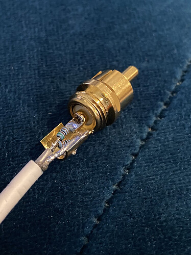

My flashbackcables RCA to DIN cable arrived today. Being the inquisitive type, I wanted to check the soldering and lo and behold there are two tiny resistors between hot and the tip and hot and the shell. Is that normal??
Looks like an attenuated lead, designed to reduce the signal level into the amplifier - did you specify that when ordering?
