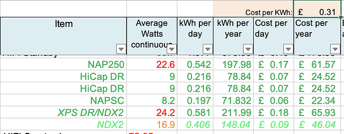

Here are my costing for a year based on 31.1p kWh, when I looked into its while back using a Watt plug in meter. These values will vary depending on type/volume of music played, but may give an idea.
Typically my house uses 200-280 Watts at night. Fitted a few Tapo Smart Plugs to turn things off at night that I dont need, but not able to make a large impact on that figure now.
So thatās about Ā£250 p.a. for a 6-box system then.
Add to that the increase from 31p to 50p per kWh (i.e. about £400 p.a.) - plus the much higher daily standing charge (which you have to pay even if you have no hifi system).
As Guinnless said above: āthese are the accepted running costs of high spec Naim kitā.
