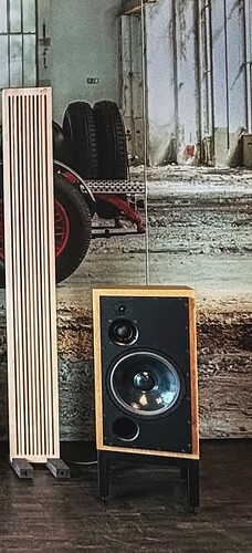

I wonder what finish those scm150s are, its rather nice.
At first glance I thought they were Cherry but zoomed in and looking at another picture I’m not so sure, lighter looking so maybe the oak (pippy). I’ll ask the question through the comments.
Yes I would guess puppy oak too, the grian looks like that but the colour looks off in the photo.
Puppy oak and a big woofer

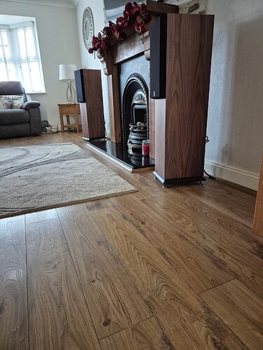

The ATC SCM20PSLT landed today, I have to say on first play the tweeters are lovely. There will be some fine tuning on position but for now not too bad, very happy.
HiFiman, they look very nice in the room.
Remind me, did your SL2’s fail? IIRC I read that on here.
Are these the replacements? What else was short listed/auditioned?
