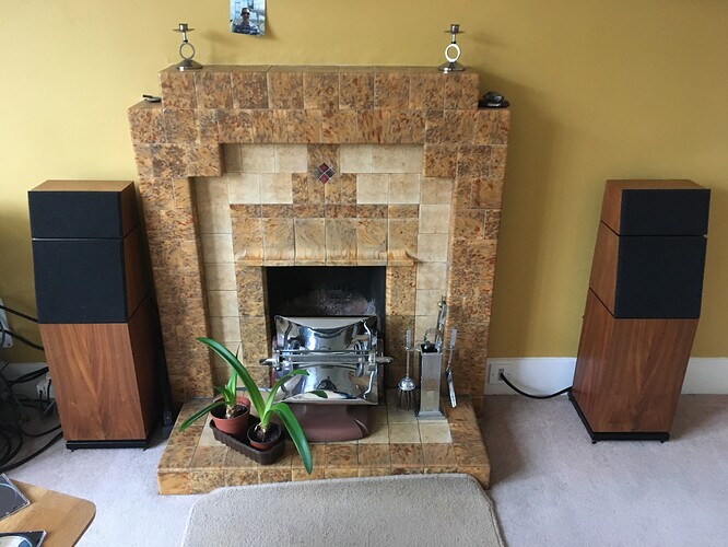

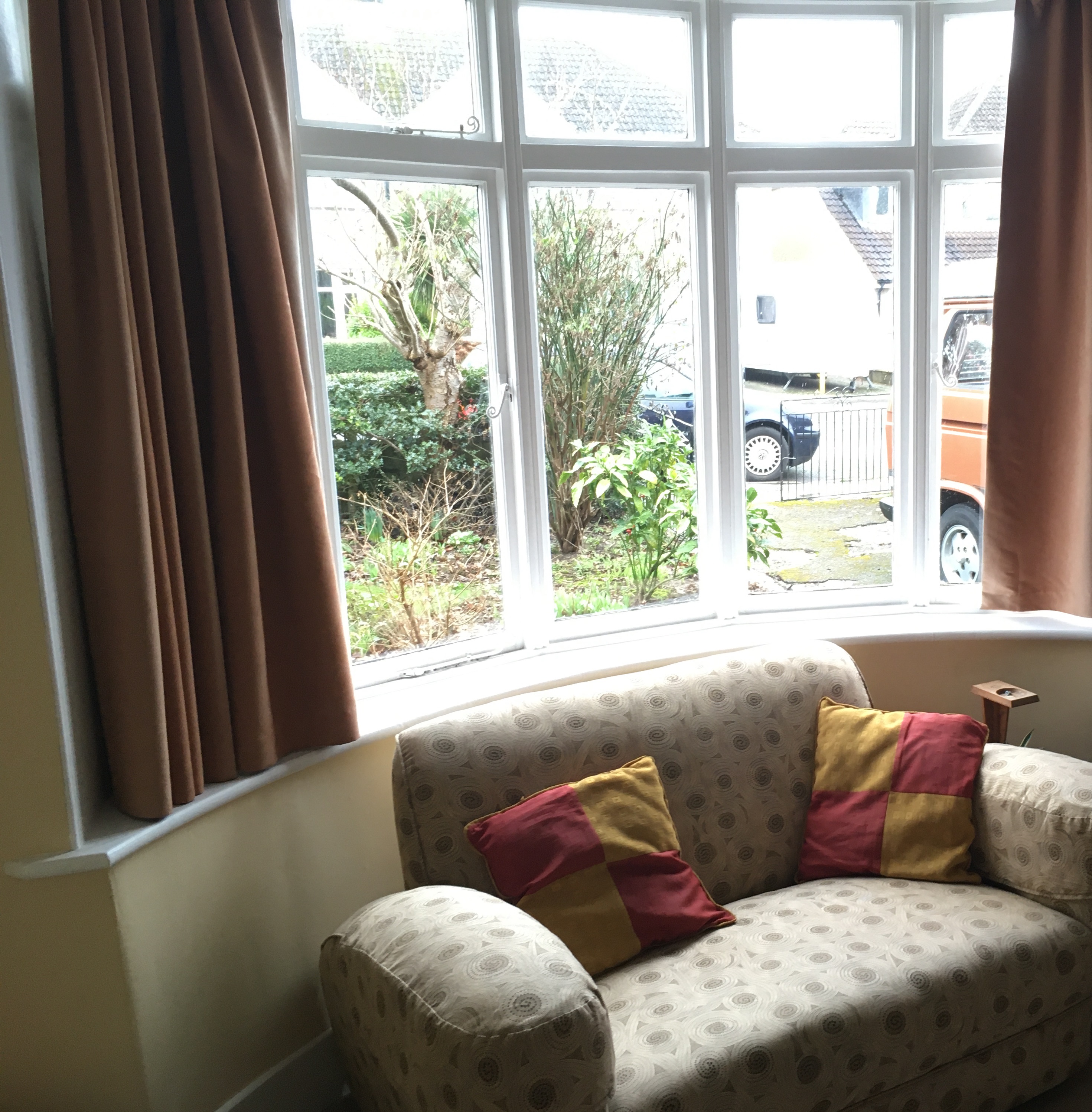

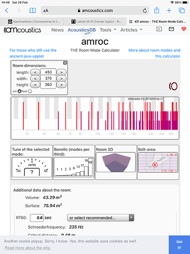

For your perusal :+1:t3:
Ah, combination of poor estimation of dimension and inaccurate measurement. The figures are now exact. TBH, I thought my issue was the speakers were too close together, clearly wrong there!
I have moved speakers and units around to a temporary position to try and get the speakers right and then fit the rest to fit to the room, and preferences of others in the house :wink:
Thanks for your thoughts
Ideally we need to see more of the corner between the speaker and the sofa. But as a start, get rid of the 3-way plug socket thing and replace with an unswitched, no led, no surge protection extension strip, preferably with a long lead. That way you might be able to move the left speaker left-wards a bit, and not be too far from the wall. I suspect your rack is to the left of the speaker though.
Yep rack is temporarily to the left of the speaker. I am planning to get some new speaker cable and that threw up this whole question really. ATM I only have 3.7m so am restricted to have the rack in this corner. I am planning to place it on the other side of the room with longer lengths of cable. i want to see if I can get the speakers performing better before I re-site the system, giving me a better indication of how much speaker cable I might need.
From all the great contributions I can see my next step is to move the rack and the plug and move the left speaker a little to the left. I have loads of NACA4 spare so will probably temporarily use this to allow me to make the changes Moving teh rack and the socket will let me fine tune speaker position, having them closer together and equally spaced from the room corners.
That looks like perfect distance apart for SBLs. My room is 3.6m wide and my then SBLs were almost identically distanced, albeit equidistant from each side of the fireplace.
Hope you get it sorted @PeteC , you have a lovely looking Naim set.
Mine were about that too, with plenty of distance to the side walls. Don’t recall getting more bass when in line with a speaker.
I wonder what they sound like evenly spaced each side of the fireplace cos that would be nice to look at. It might not make all that much difference especially if sat reasonably close, although we can’t see how near the left hand wall is, so that might scupper things.
Are the spikes clear of any carpet gripper strips Pete? I think my SBLs ended up 7 or 8cm away from the rear wall in order to avoid the strips. Still had plenty of bass.
Good point about the gripper rods, they are sitting off them, checked when I set up. I will be moving the rack, which is to the left of the left speaker, giving me more room to equally space them around the fireplace as you said. I will reposition the plug socket as well.
Update on speaker positioning. Thanks everyone for helpful comments. I have been doing some measurements with a simple db meter on my phone and low base is about 5db higher at 70db front on to the speaker than at my listening position. as I move the db meter towards my seat low base gradually drops, so I am thinking speakers need to be equally spaced either side of fire place and closer together, at the 1.5m I have now, hopefully that will position my seat in the sweet spot. Hope that works as I can’t move seat further back as it is against the wall and I can’t move speakers closer together, because of the fire place!
